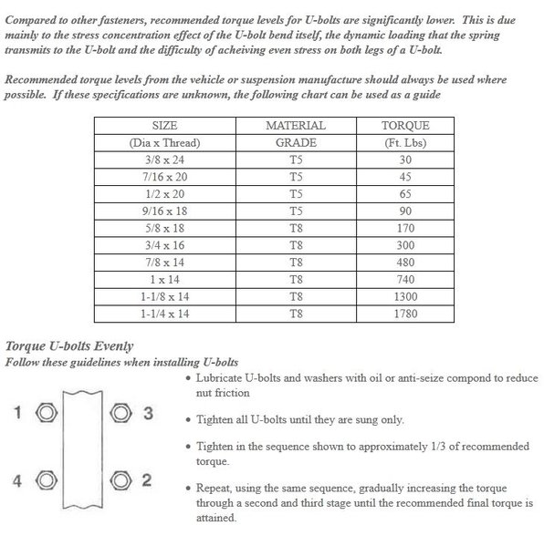

    hmmm... I just did a little reading. (something I should have done more of before grabbing the torque wrench)
    Apparently, the Ubolts are supposed to be tightened in a criss cross fashion.
    On the drivers side, I think I did the inboard ones first, then the outboards ones. On the passenger side, I think I went in a more clockwise around the square pattern...
    How important is the criss cross thing? Hope I didn't just screw things up...

    You know another thing to think about is that U-bolts are a "torque to stretch" bolt. A predetermined setting isn't always going to be the right torque if you are using non-stock U-bolts and if you have removed them and re-installed technically you should replace the bolt.

    Now I understand the question. Think consensus is, 37 ft/lb is a typo.
    I looked at a .pdf version I have of the TSB. (attached below)
    Unfortunately the links to reassembly & Installation go nowhere.
    Has a list of links by truck year, then goes right to, how to align it.
    But I did notice in the "Parts Information" listed the 4 U-Bolts.
    Excellent Question btw, This is how we make progress.

    Yeah I looked it up too. Not very helpful for what we are looking for. But I did see as well that they do come with new u bolts. Maybe the non tsb u bolts are designed at 37ft lbs and the tsb u bolts are redesigned to 75 or 80? I don't know , just saying.:confused:

    I don't think there is any grade of steel used for u-bolts that would yield at 37# in that size. If it was that soft, you could bend it by hand, and that wouldn't be good for u-bolts. There are standard grades and sizes, and recommended torque for what is typically used is around 80#.
    It's your axle. It pushes your truck around using the u-bolts as its grip on the rest of the truck. Make sure it has a good grip. 37# just isn't right.

    C'mon guys use your common sense, if up to 2004 (end of 1st gens.)
    The factory torque was 90ft.lbs. & in 2005 (1st year of 2nd gens.)factory torque drops 53ft.lbs to 37ft.lbs does this seem reasonable ? does this make any sense ? Sure doesn't to me & keep in mind I can take my stock Ubolts & nuts right now throw them on a 2nd gen axle & fit perfectly because they're the same..

    Just went under my (Canadian) 2013 DCLB TRD Sport. I'm pretty sure the ubolts were at 37ftlb's. I could easily remove them with a standard socket rench.
    I torqued mine to 70ft lb's just to be on the safe side. Didn't feel comfortable going to the full 80-90 just because that's a whole lot more than 37! (just in case we are all wrong!)

    ^^^ did this exactly today at 70 but now im thinkin a lil' tighter..80 should good, i lost alot of noise after i torqued em:)

    I'd be comfortable with 70ft.lbs. glad you guys checked...:thumbsup::thumbsup:

    Finally torqued mine to 70# today.

    Hey guys just an up date. The other day I stated that after checking the u bolts they were loose . At that time I torque them to 40 ft lbs. After driving the truck just a couple of times I checked them again and low and behold they were loose again. So I decided to torque them to 65 ft lbs. just like the chart said. I did mic up the stock u bolts and they measured 1/2in. So I will drive it a couple of days and recheck them. At this point I am starting to lean torque 37# being a typo !
