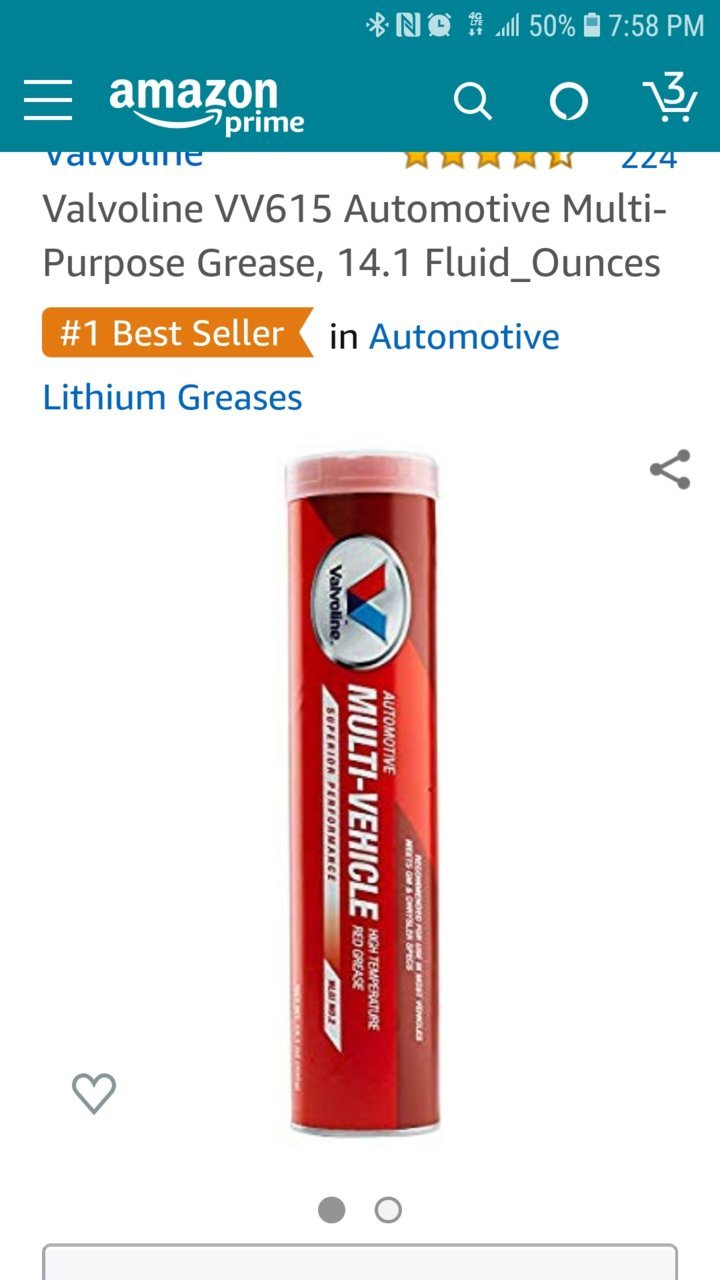

    I was planning to use this grease from Valvoline, but im un sure what type of material the bushings are whether they are polyurethane or not. I dont want to pump up the wrong grease and screw it up:confused:

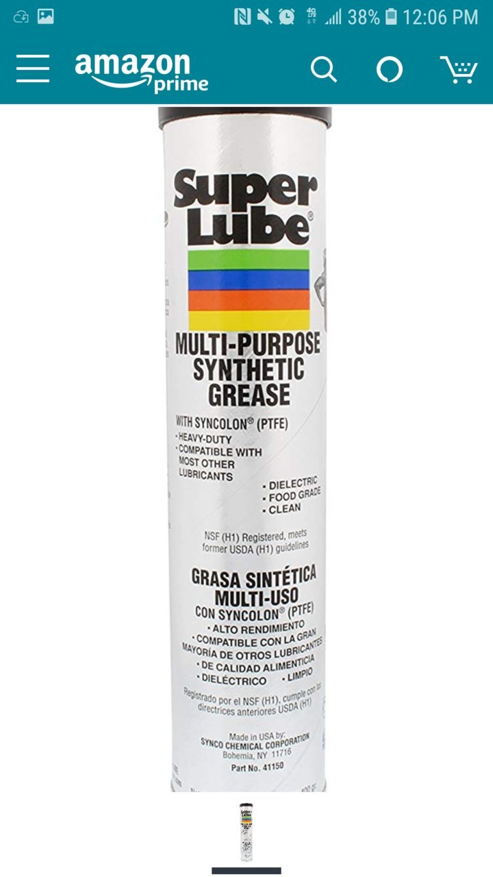

    @crhsharks12 teflon spray should be compatible with Poly bushing but i cant imagine it lasting as long as actual grease on there like Superlube with PTFE

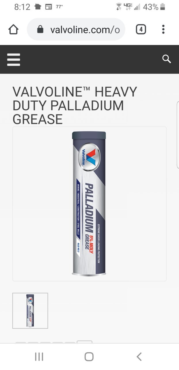

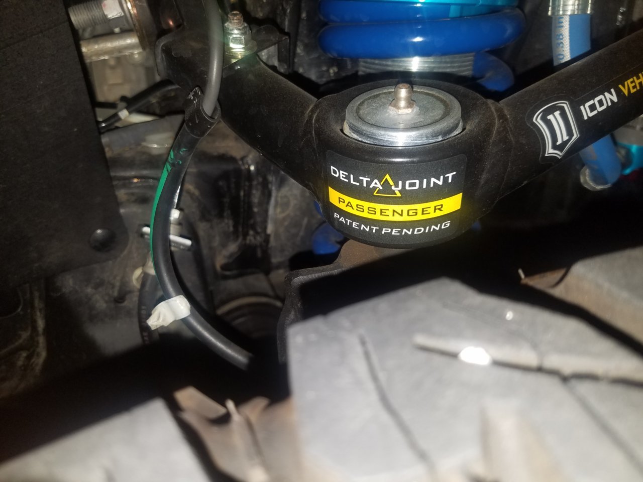

    From ICON....
    The Delta Joint comes fitted with a low profile zerk fitting that can remain on the UCA. The extra zerk is for customers who would prefer to use a regular style zerk.
    This is the grease we use here at Icon:
    https://www.valvoline.com/our-products/heavy-duty/palladium-grease
    The specs on the grease that comes in the joint are:
    NLGI GC-LB #2
    GREASE WITH MOLY
    The UCA bolt will need to be loosened prior to pumping grease into the pivot housings while performing maintenance. The bushings are air tight, so the seal will need to be broken in order to not damage the bushings due to the pressure.
