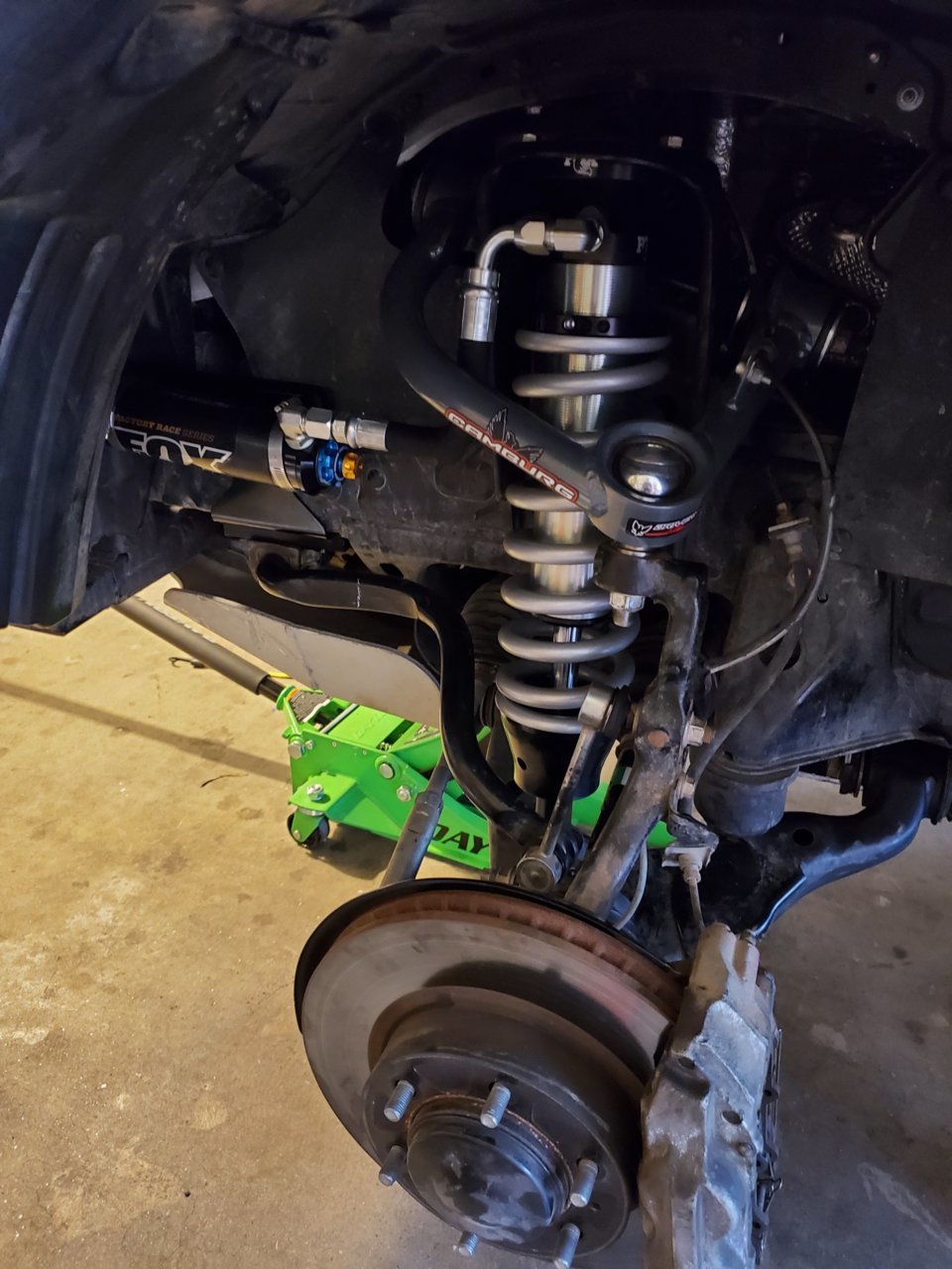

    Dampahee
    Dampahee Well-Known Member
    Apr 6, 2019
    #289342
    499
    So Cal
    2019 TRD Off Road
    Fox Factory 2.5 extended travel w/DSC Eibach 650x14 springs Fox Factory 2.5 x 12 in smoothies with rr and DSC / Accutune Adventure tune Archive Garage shock relocation Archive Garage hammer hangers with 3.6" shackles Archive Garage high clearance cross bar Deaver Expedition u402 stage1leaf pack Camburg Racing Uniball UCA's Total Chaos Gusseted Spindles Marlin Crawler HD LCA/cam tabs Frame Brace gussets @weldstaco front diff reinforment kit Wheelers u-bolt flip kit with super-bumps Crown performance SS 24 in extended rear brake lines SS extended front break lines Exhaust re-route mod Dirt King Cab Mount Relocation OV Tune-91 Performance Nitro 5.29 Gears ARB Front Locking Differential ARB High output in board compressor Slee On-board compressor mount Blais Bros Taco differential breather mod Schmellfab 12.5° sliders with kick out RCI steel IFS skid RCI steel transmission skid RCI steel T-case skid RCI LCA skid BAMF Rear differential skid Relentless Fabrication hybrid front bumper Relentless Fab High Clearance rear bumper ATHF rear fender supports SOS performance rear disc brake conversion Trimmed Fenders 2.5" Softopper TRD Heritage grill RFT Raptor lights Morimoto XB headlights Baja Designs amber S2 flush mount chase lights Baja Designs S8 30 in lightbar Cali Raised Relay Mount Cali Raised cubby switch mount Smittybuilt X20 10 k winch Factor 55 Fairlead Factor 55 Flatlink E Factor 55 Flatlink Ropeguard Tandem Off Road Manor winch solenoid mount 1.25 inch Spidertrax wheel spacers 17x9 Ultra Wheel x103 beadlocks 35/11.5/17 Nitto Trail Grapplers Fend-X Wheel Liners Clazzio leather seat covers Taco Garage DMM Mount Taco Garage Anytime Front/Rear Camera MESO Customs Chrome Delete MESO Extended fuse cover AVS in channel low-profile wind visors Kicker CS tweeters, 6x9, 6.5's Kicker Key amp Kilmat sound deadening
    thanks man, but decided to go a different route.
