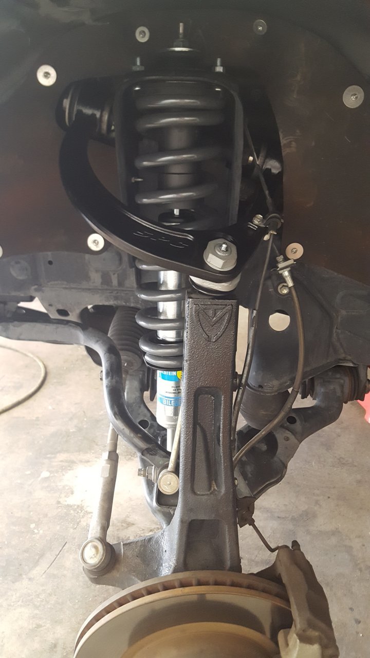

    Anyone care to give feed black on the SPCs?? I’m leaning that way to save a few clams

    Liking mine a lot.

    How long have you had em?? I assume you’ve had no maintenance issues

    ah the new forged ones i see. nice!

    Only about a month. Zero issues
    Yes sir! ​
