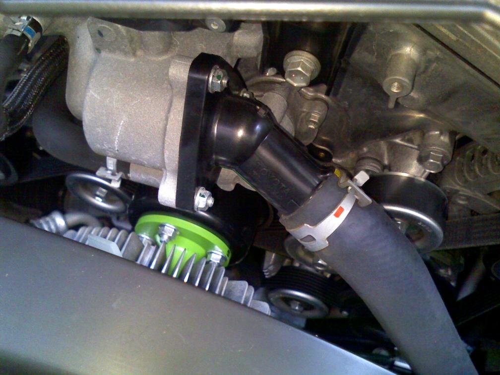

    yea the cam gears dont seem too bad, I havnt looked up how to install a thermostat (dont even know the location??).

    Very easy, it's between that plastic part where it's mounted:
