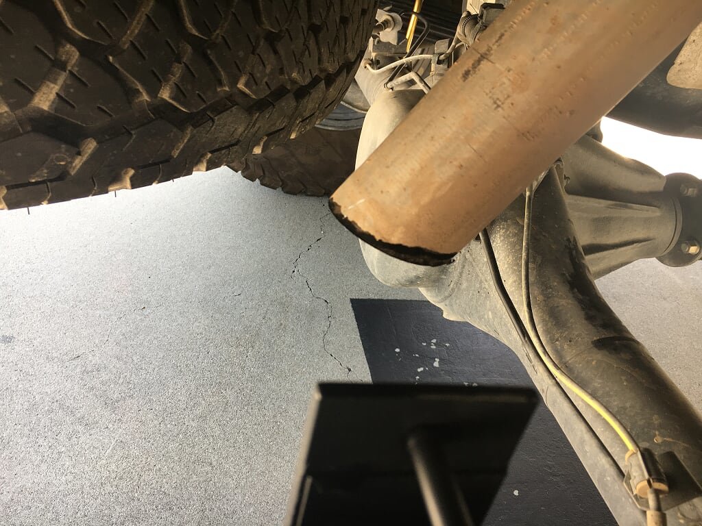

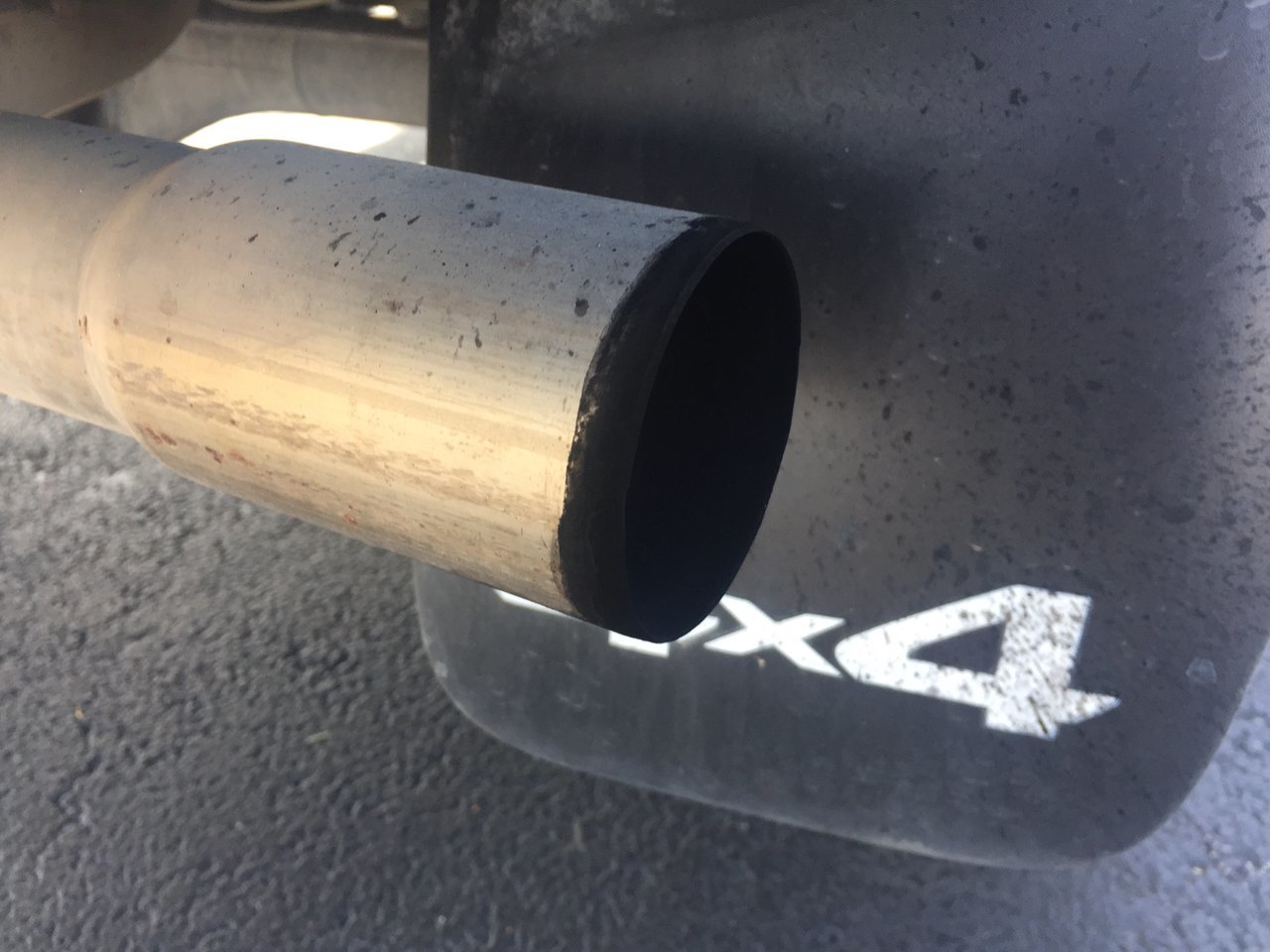

    Getting a ring on my exhaust tip as well.
    This is from yesterdays drive home and the drive to work today as the exhaust dump was just done yesterday.

    Your AFRs may be similar to mine.
    Cruise = 14.7:1
    Moderate load / light accel. = 12:1 - 13:1
    Heavy load but not WOT 10:1 - 11:1
    WOT = gauges pegged at 10:1

    Huh I'm running the stage 2 urd kit on my 09 and at wot I'm running in the 11 and 12s. Just cruising I'm in high 14s. You will probably get the soot ring on ur tip, since you pulled the cats there is nothing to burn off unused fuel and gasses. That's also why you get that more exhaust smell.

    I still have all the stock cats and am getting the soot ring like @loginfailed
