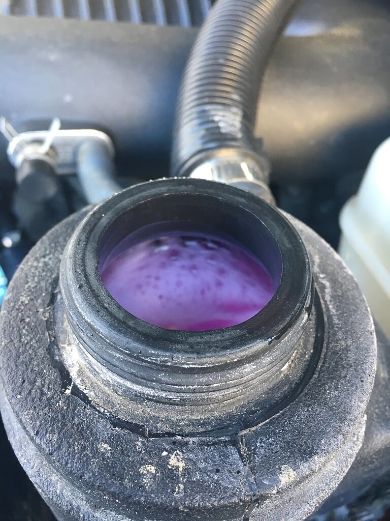

    Coolant reservoir is full.
    Maybe too full?

    Key on and look into it, as long as you could see it swirling around good then you've got good flow and should be good. Also check for debris/leaves/etc in the radiator fins and wash with a garden hose if it looks dirty
    loginfailed likes this.

    Do you see the coolant swirling in there with the ignition on? I remember someone had a bad pump at one point.
    oni06[QUOTED] likes this.

    Its swirling and no debris upfront.
    jojotoo and loginfailed like this.

    Yall obviously don't stare at your coolant often enough. This is clearly either swirling or just got done swirling from the bubbles alone lol.
    Also, I might need to change mine soon, mine's starting to get a little darker, almost a brownish pink.
