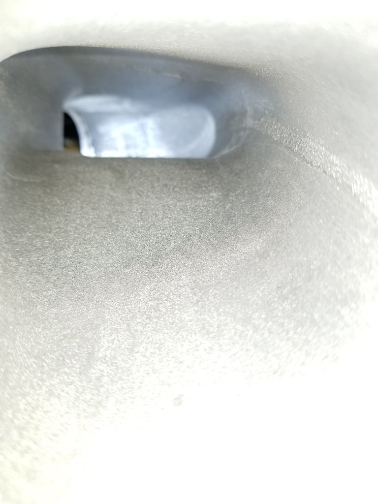

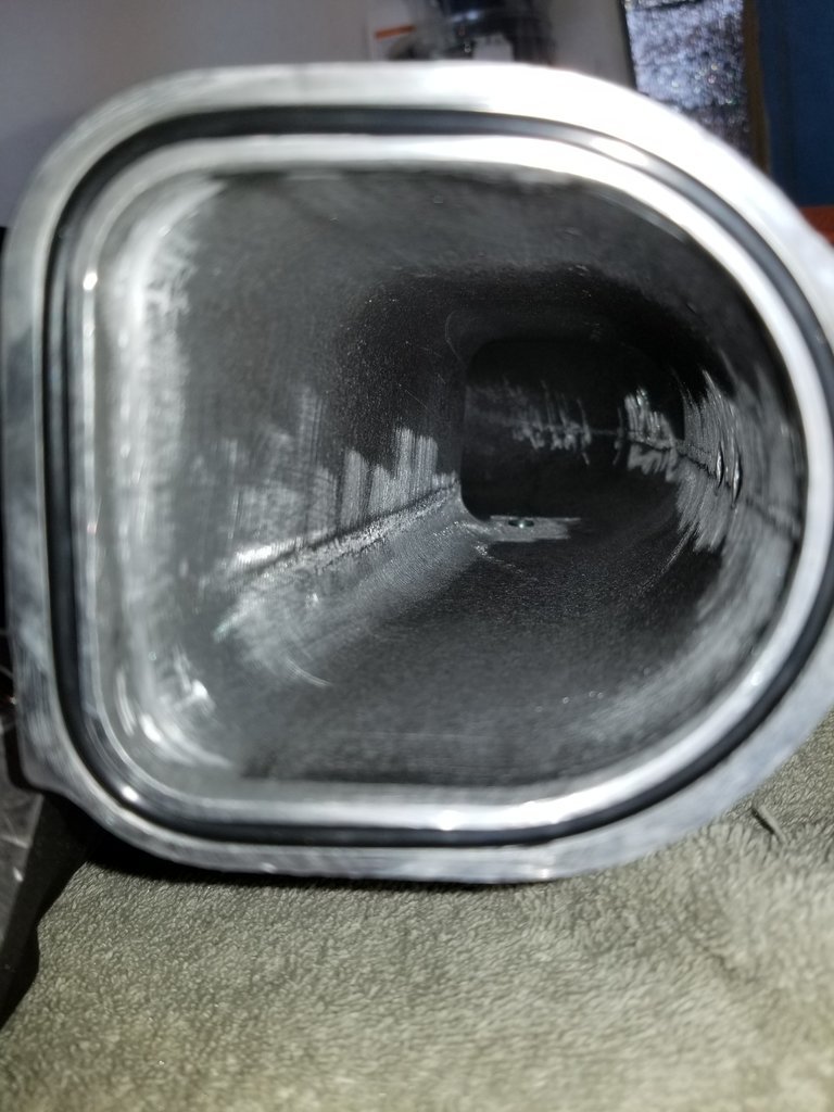

    I wouldn't think your intake is the bottleneck. If anything it is the sc inlet shape and diameter. Diameter is small and makes that ubend at rotor inlet. That is the main restriction at high boost wot. 20170526_173416.jpg 20170525_220617.jpg
    If the sc inlet is starved for air, it bogs the rotors down robbing hp since it takes more power to overcome the extra vacuum to make more power.

    If you are talking about my comment then yes.
    Keep in mind, trd/Maggy designed this for 70
    Hp increase.
    Food for thought...
    Why is sc inlet smaller than factory tb?
    Have you tested inlet flow characteristics and how it affects sc load?
    I have.

    There was a nember who ported his as best he could. Not too long ago. Said that is made some nice improvements. It was also ported to match the 70mm TB.

    Sounds like free horsepower. (other than time invested) I think I'll pull off the blower sometime in the near future and see where all I can shave off material to allow air to flow more smoothly.
