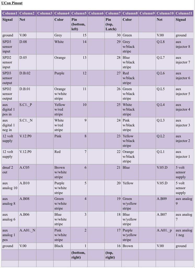

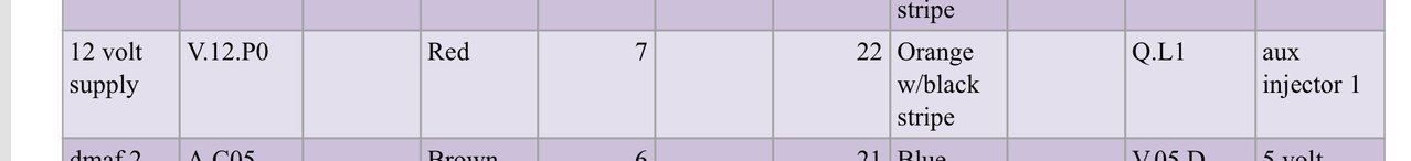

    Wiring the 7th injector to the UCON. Pin 7 and Pin 22. Polarity does not matter.

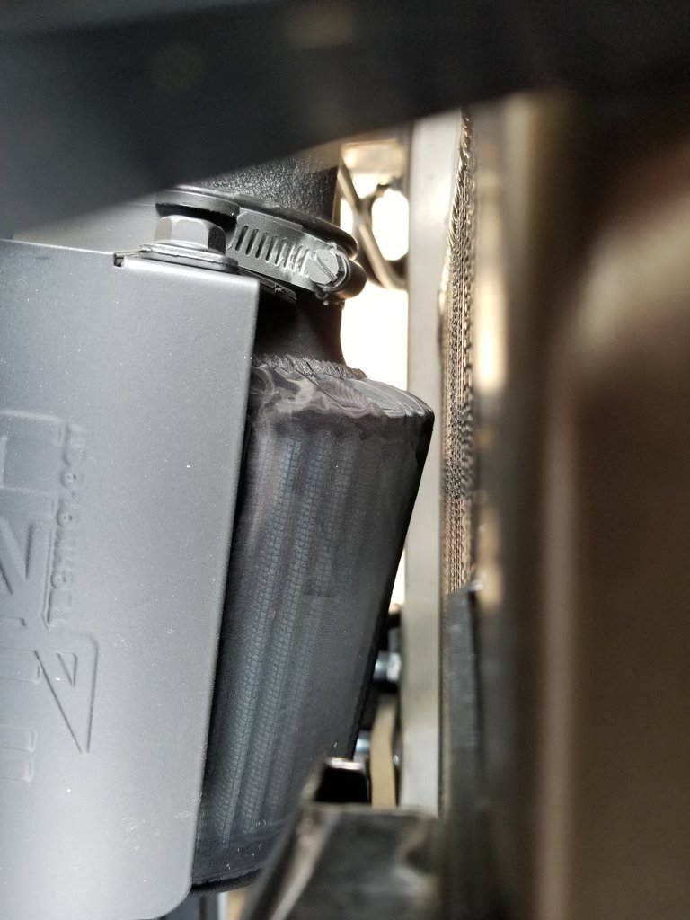

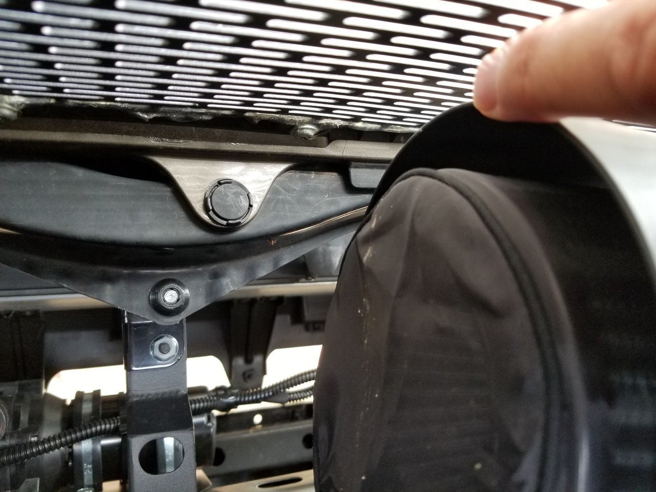

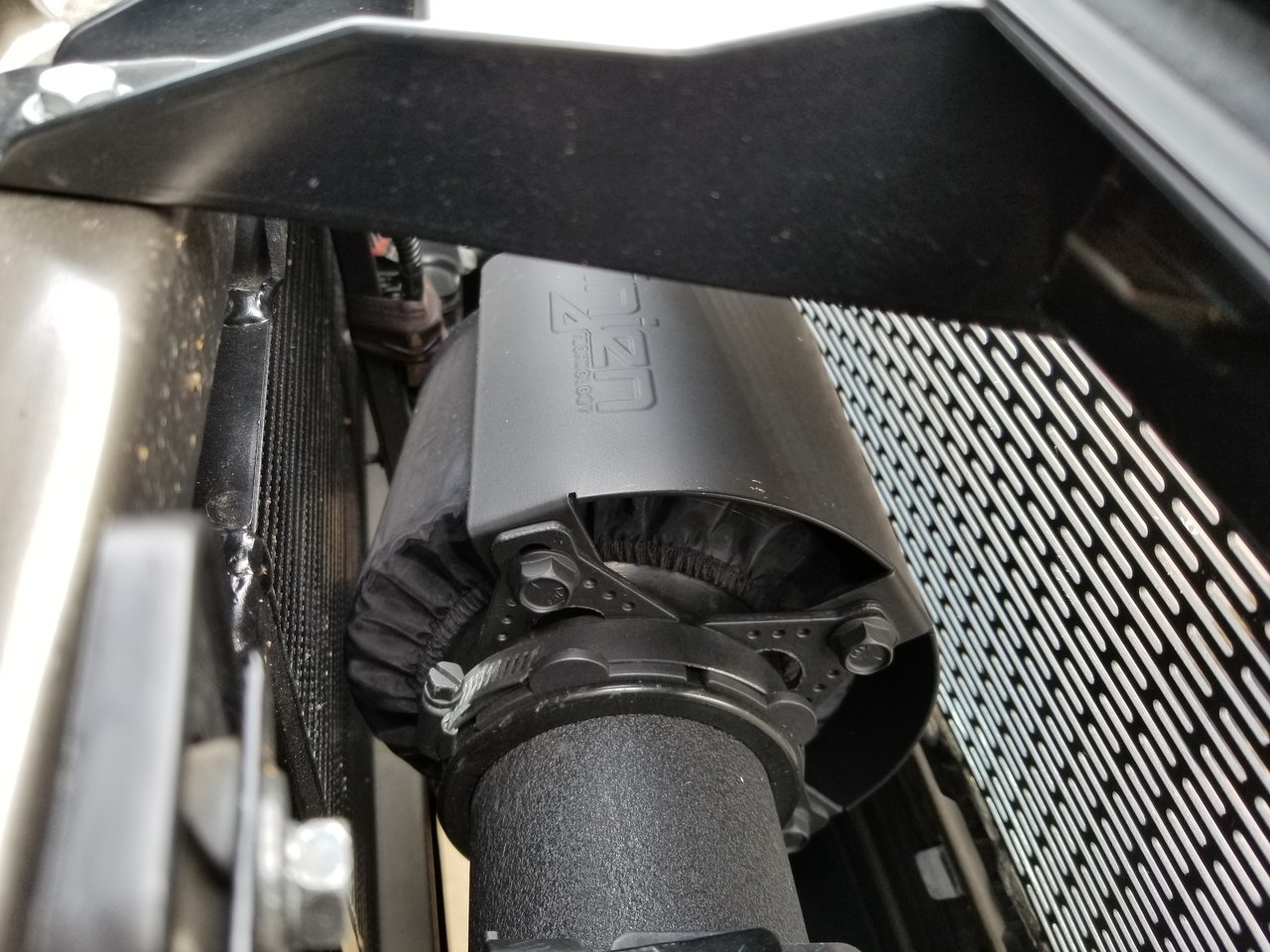

    do you have pics of the URD TCAI with the S/C? I will be doing the same thing. Curious as to how much I am going to have to carve out of the stock grill (I have an '11 and like to keep it...I WILL make it work..haha) to keep it all together.

    I did a grillcraft install on mine, so the whole grill is gutted. The filter is pretty large so you'd probably have to cut a pretty big chunk off the back of a stock grill

    AWESOME thank you. It will def take some dremel work haha. Ill post pics of that specifically too. I thinks its possible to keep it :fingerscrossed:

    Yeah, I'm sure you will have to trim the backside of the grill. The filter shield takes up some room as well.

    yea, I have that as well on mine. I think it adds like .5" maybe??

    I have the urd cai installed with factory grill. It fits, without the splash guard.
