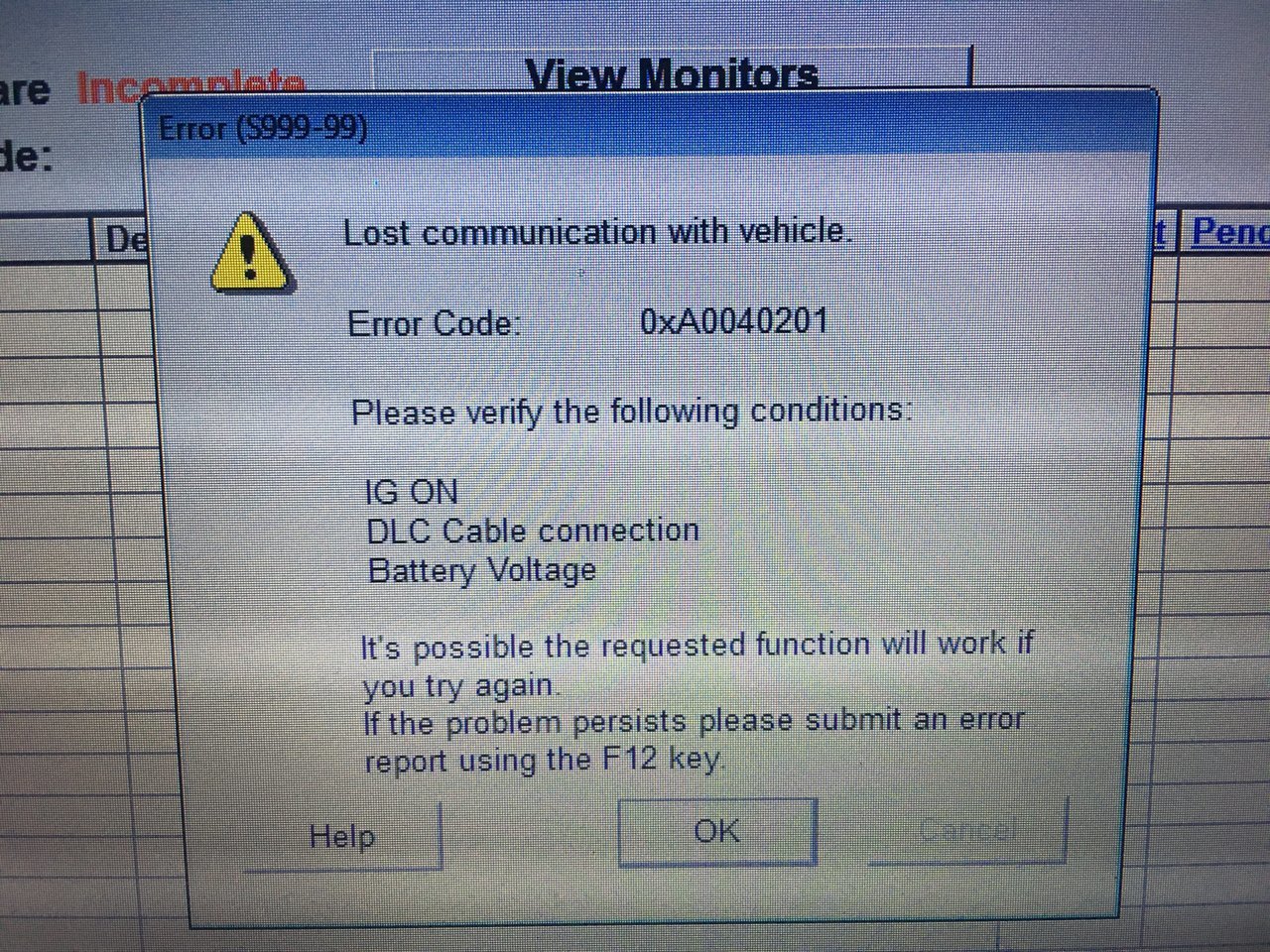

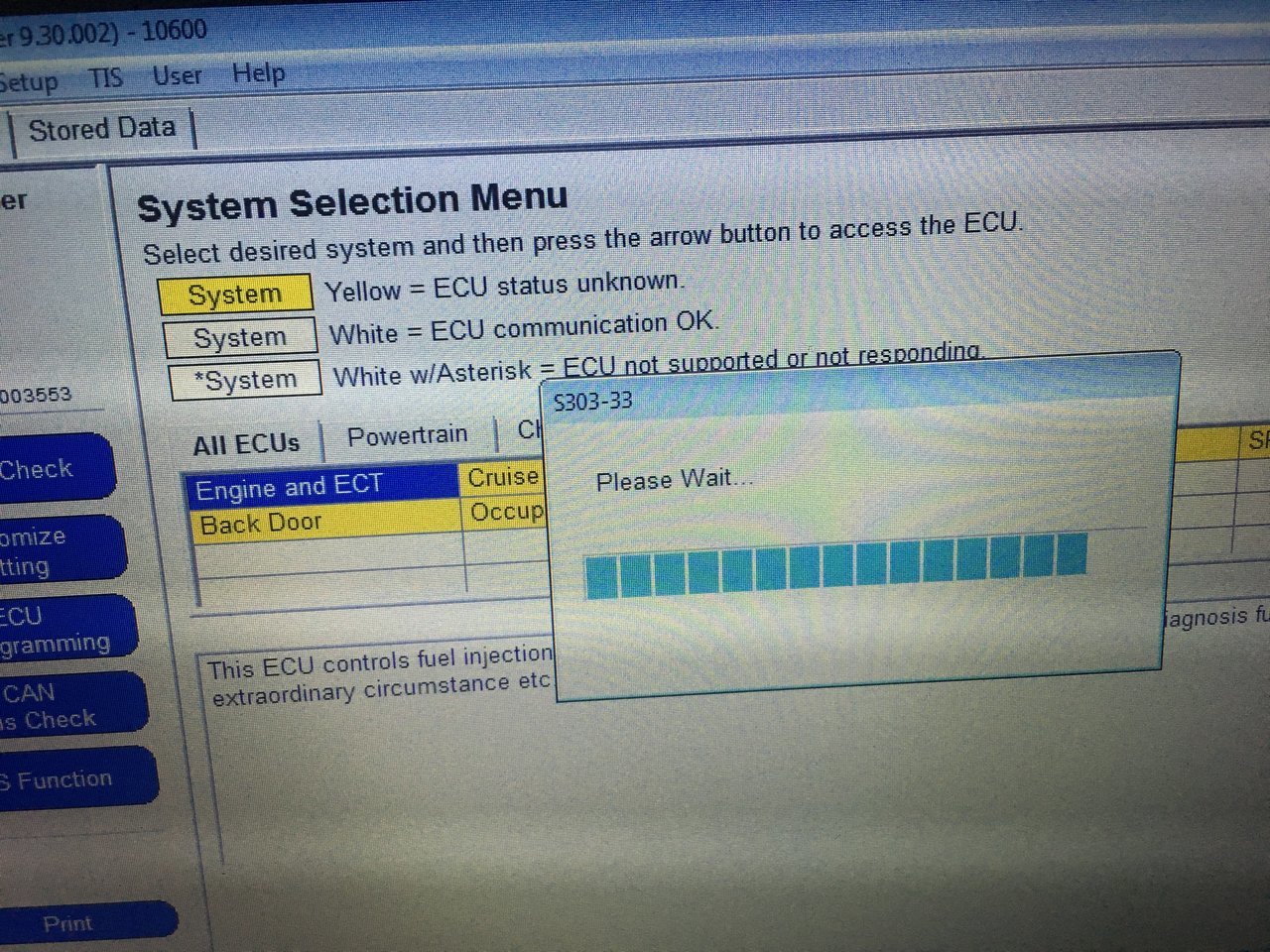

    Since I have a junk yard ECU, I need to update the VIN to reflect my truck's actual VIN. My state inspection is due and the OBD2 portion of the inspection does a silent VIN pull and transmits it to the state of Texas. The truck will pass with the wrong VIN in the ECU, but it throws up a flag and puts the car on a report. DPS looks at those reports and sees the. VIN you inspected does not match the VIN you scanned.
    Even though the inspection is legit, the mismatched VINs make it look like you're plugging in a different truck to get a failing truck to pass.
    I've worked before at a huge used car retailer before (there aren't that many this big and they have some goofy commercials so you figure it out easily) and saw the company get into big trouble because many of the techs were plugging in other vehicles to get the ones they're working on to pass. It's usually not a case of the car having a mechanical problem, but that the state requires a maximum of one incomplete emissions monitor. Many times you'll get a car that's been sitting a while or had a dead batttery and the ECU hasn't had enough drive time to pass run the OBD2 tests. So the tech is lazy and plugs in a different car so he can move on.
    The location I worked at fired about 15 techs over that.
    Normally one or two here and there won't raise eyebrows but tons of VIN mismatches from one station is easy for them to spot. So they moved in on the company.
    Long story short, my mismatched VIN would be legit deal and easy to explain if anyone asked, but I'd rather not even be on the radar. For the sake of the station doing the inspection and my own peace of mind.
    So this morning I just tried to update my VIN. Using Toyota VIN update wizard. Im using a $650 Mongoose Pro Toyota 2 MFC Bluetooth cable and a legit Toyota techstream $55 2-day subscription. Toyota Techstream and Toyota VIN wizard will not communicate with the UCON installed.
    I removed the UCON and had no problems connecting Techstream or VIN update wizard. My VIN is now updated and I'm about to reinstall the UCON.
    @FinnJ its not just you...
