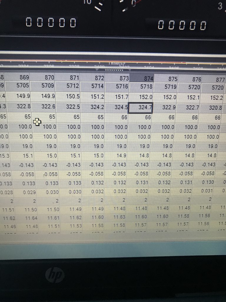

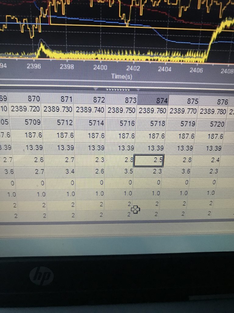

    1st WOT run with the 2.55 pulley .. 11PSI.
    Max MAF g/s
    Cam angles
    Injectors

    Very similar to mine. :thumbsup:

    Have you installed a shorter belt yet?
    Which intake do you have? As well as supporting mods again?

    Shorter belt - Dayco 5PK1765 - 5050695
    2.55 pulley / UCON / AFE CAI / URD LT Headers / URD Y Pipe / URD MK3 / 7th Injector / Walbro 255.
    Picked up a valve body, haven't sent it in to IPT, yet.

    ohh.. thought SC already came with the 61lb injectors, will look at 60s instead. We're both well over 80% duty cycle with our current injectors, so im thinking we should upgrade ?
