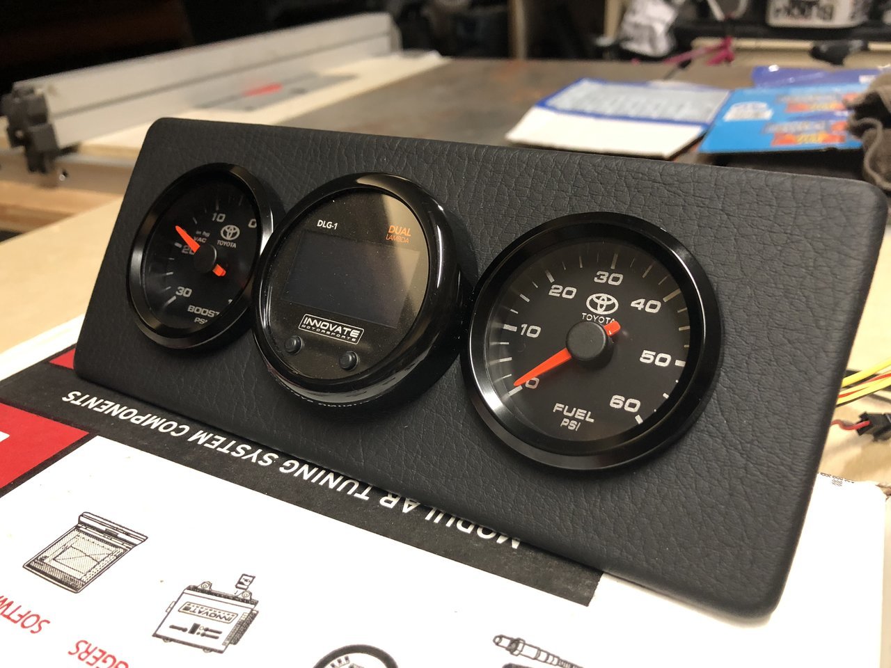

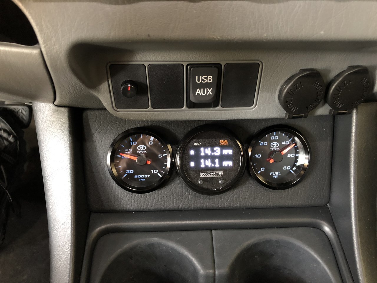

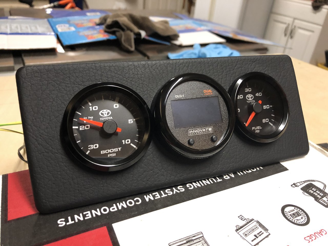

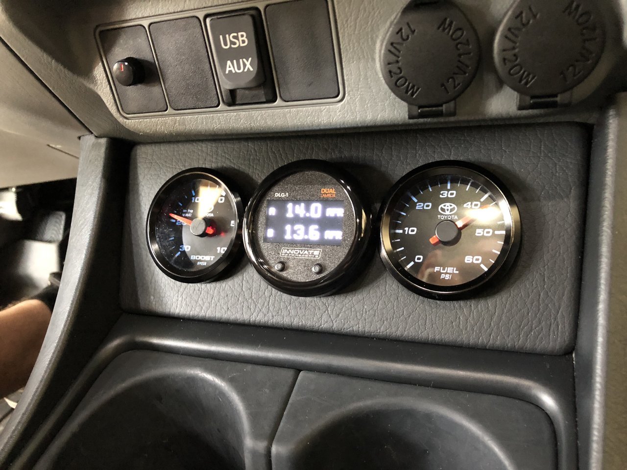

    Off topic sort of.
    But I upgraded from two seperate AFR gauges to the Innovate DLG-1. I was going to make my own A-pillar pod and got tired of sanding on it. I ordered the LoTek pillar pod and it’s kind of cheesy and the gauges don’t sit flush or mount properly without modding the gauge bezels. The grab handle doesn’t fit good either.

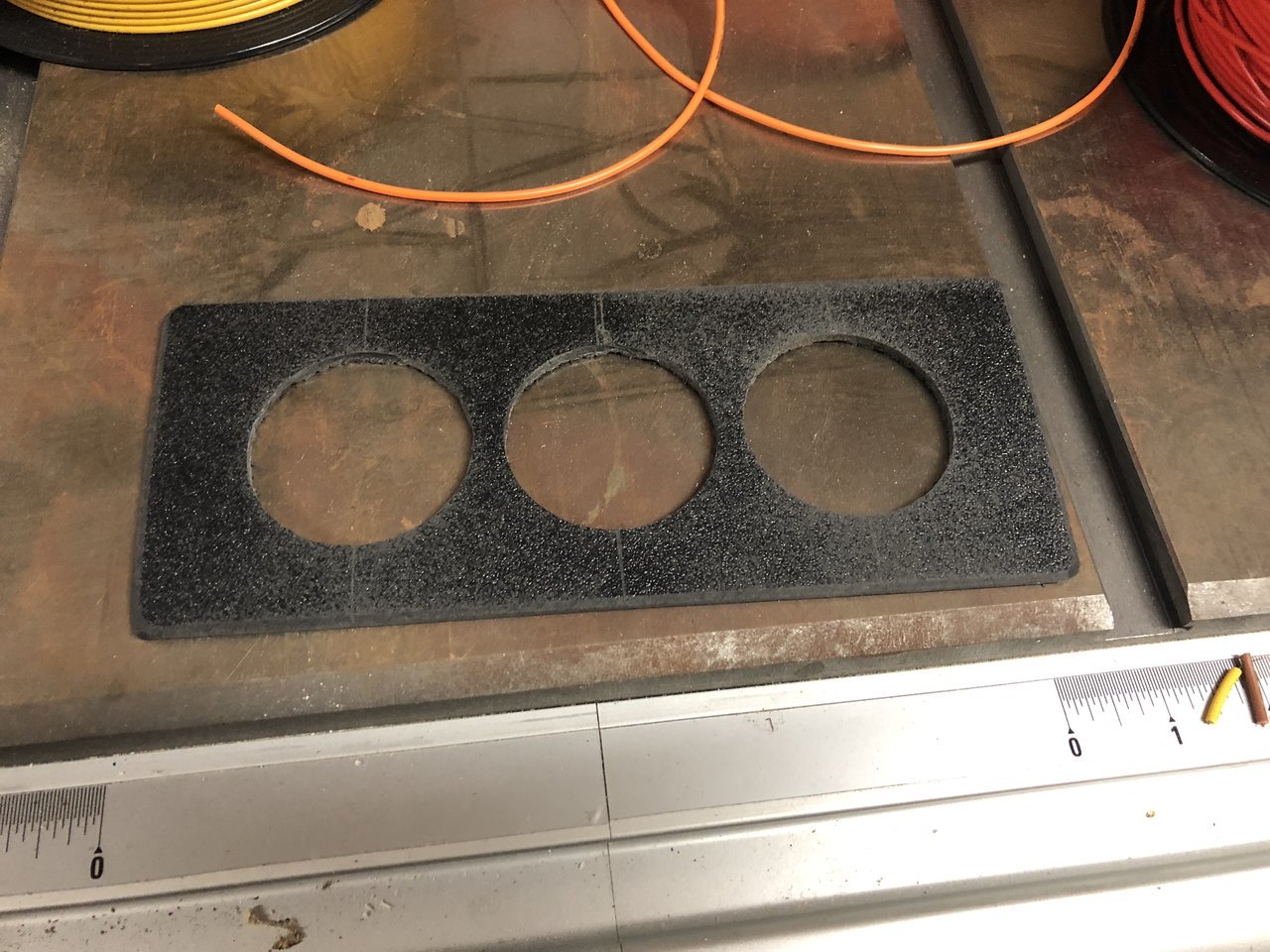

    So I made a new plate for my gauges with only 3 holes this time and also wrapped it in vinyl so it looks a little nicer than just plain ABS plastic.

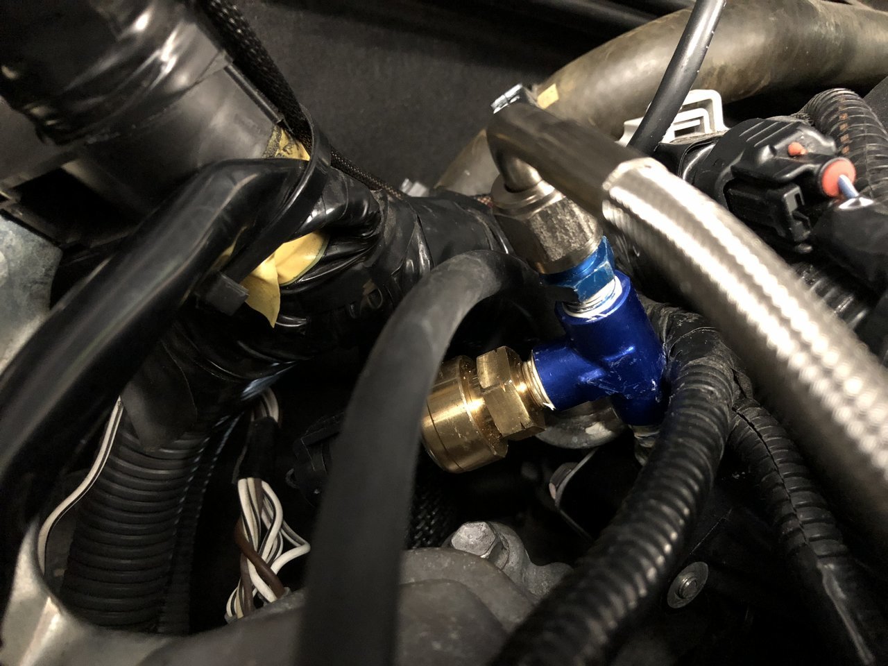

    Also, since installing the 7th injector my fuel pressure gauge hasn’t been working since the URD fuel rail tap only has one port. I ordered a couple adapters from Russell to make one port into two. So now there’s an extra port to screw in the fuel pressure sensor.

    Well done, looks good!

    Outstanding job. That's downright sexy.

    That is an insanely CLEAN job, well done

    Turned out very nicely. Well done.
