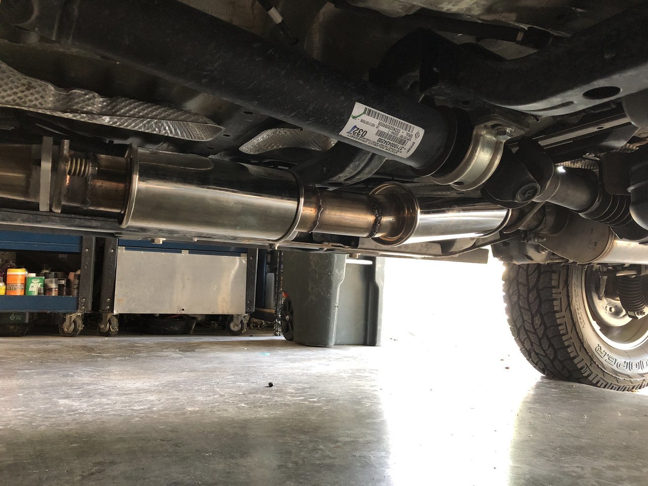

  20. Oct 14, 2017 at 9:50 PM
    #1160
    loginfailed
    loginfailed Well-Known Member
    Aug 29, 2016
    #195923
    5,156
    Dwayne
    Houston, TX
    2014 DCSB 4WD
    I added the second resonator this afternoon. It helped a lot. It still has a nice growl to it, but it’s much more bearable. Freeway volume is much better. Before I kept it below 65 because it got pretty annoying at any speed higher than that. Now I can cruise at 85 at comfortable volume.
    Not the best looking welds, but on par with my abilities.
