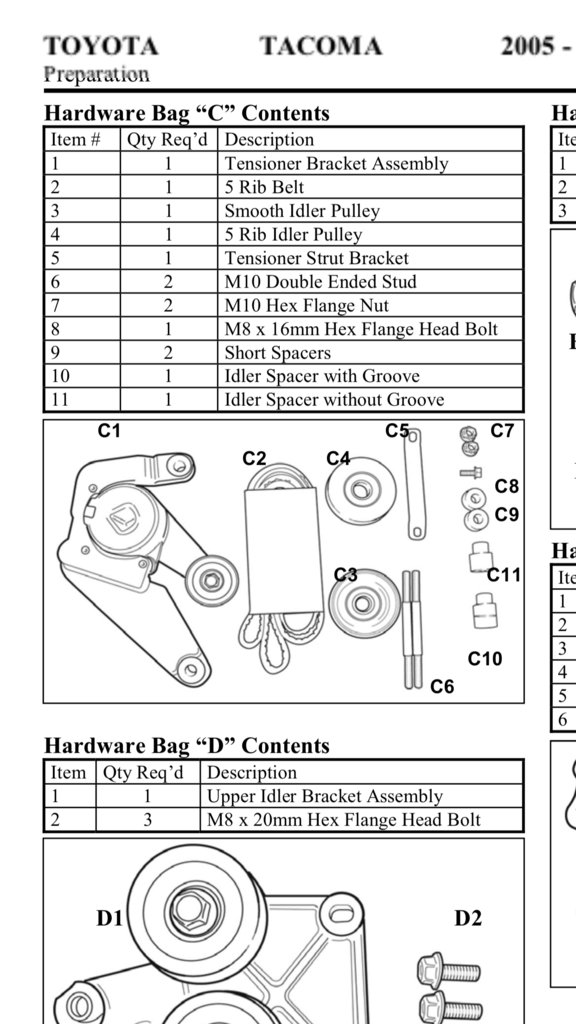

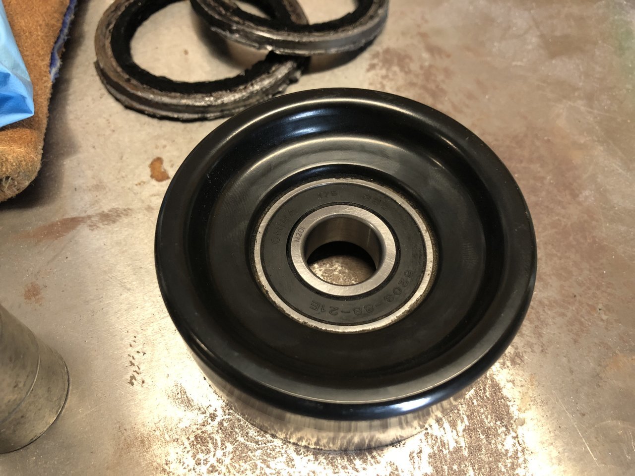

    Anybody know the part number for C3 “smooth idler pulley”? Mine has a little wobble to it so I’d like to replace it. It looks like something I could get at Autozone or Oriellys.

    Can you just replace the bearing? Should have a part number on there. As an alternative.

    I think they pulley itself is slightly bent. My fault really.
    I changed to the shorter SC belt. When I took off the tensioner, one of the spacers fell off and landed inside the fan shroud. I didn’t even realize it happened.
    So when I put the tensioner back on, I tightened the nut down and it felt like it wasn’t getting tight. I looked down and saw the pulley was sitting crooked.
    So I pulled the tensioner back off and that’s when I noticed the spacer was missing. Looked all over the place for it and finally spotted it sitting at the bottom of the shroud.
    It seemed like it was wobbling when I tested it on the bench, but I just put it back together a little bit ago and with the engine running it looks like it’s probably OK. Going to figure out where to get one and swap it out later just to be safe.

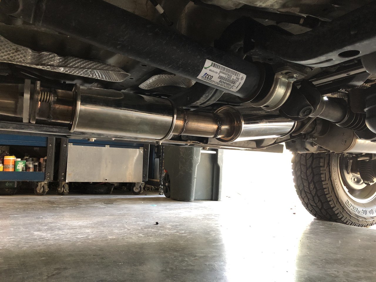

    So over the weekend, I fixed and exhaust leak where the y-pipe meets the headers, added a resonator and replaced the supercharger belt with the shorter version to account for the 2.55" pulley.
    I did a log this morning and between the shorter belt an cooler weather, the truck picked up 20g/s. So now its highest recorded MAF flow is 340g/s.
    :benchpress::headbang::burnrubber:

    So the resonator doesn't add any back pressure?
    jojotoo and loginfailed[QUOTED] like this.

    Still maxes out a touch over 10psi.
    It may have added some, I don’t know. It feels peppier down low, but that just may be placebo. I have two resonators back to back just before the muffler. The sound is much easier to live with now.

    If it is a straight through, no. Depending on the design, it can increase exhaust velocity by reducing friction.

    So if you're looking for a quieter ride, there's literally no downside other than the cost?
    Which resonator did you add?

    Vibrant ultra quiet
