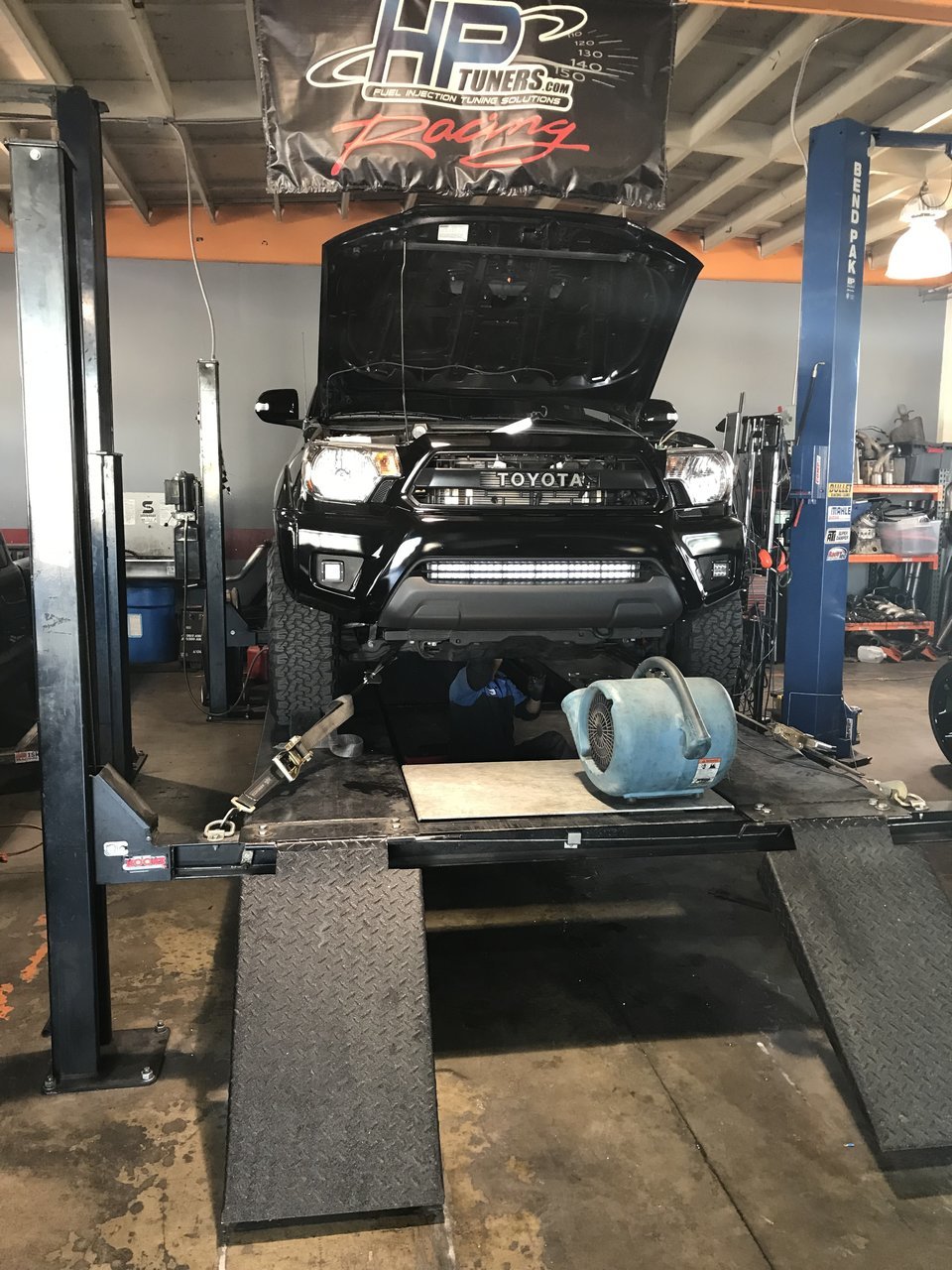

    Dyno session .. will post results later today.

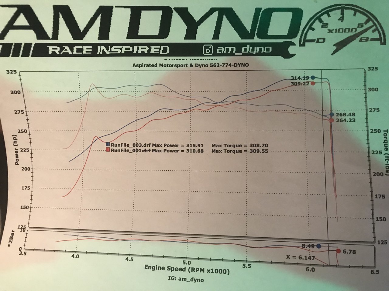

    Lol .. sorry gents.
    Wanted to run it under 4th gear but shop insisted 3rd gear.
    Not what I expected ..
    Shop dyno'd another Tacoma prior to at 13psi which produced 345hp. They said my numbers looked right in comparison.

    You are making that at ~8 psi, yes? Which mods do you have @jojotoo ?

    Feel like I should've produced way more hp .. not sure what the difference would have been under 4th gear. Shop couldn't add the AFR, but it was spot on.
    First 2 runs were identical .. 3rd run was 8.5 psi by creating more load.
    2.55 pulley
    AFE CAI
    7th injector
    UCON
    URD headers
    URD Y Pipe
    MK3 exhaust

    Wow cant believe it was so low

    Not saying this was reason.... but I'm guessing another variable to factor in is the good 'ol California octane 91 gasoline.
    And I believe OP said it was in the low to mid 90s (temp) on the day he dynoed.
    I bet those two factors (temp and octane) can make a difference in +/- 10-20HP

    Also could the dyno be reading lower because of larger than stock tires? I think that plus a hot dyno room can make the dyno read not the most optimal numbers. I feel like with a 2.55 pulley you should be making way more than 8.5 psi, then again with all 4 cats removed I’m not 100% certain on that, I thought people on here with similar setups are seeing 10+ psi. Maybe a belt issue?

    also, they bench tuned a Trd re-flashed SC and ran 13 psi which produced 345hp is just as puzzling.

    Tires can make a big difference because you don’t measure the resistance at any way?

    So should I be putting the stock tires on the rear when I go to the dyno to see accurate results?

    I'd be more concerned with only 8.5psi, I've got 2.55, no cats, and it still pins 10 on the meter without hesitation

    I've hit 10.7 psi on my WOT data runs.
    On your dyno, was it in 4th gear or 3rd ?
    Will there be a difference ?

    I've got the six speed, so I had it in 5th gear: 1 to 1
