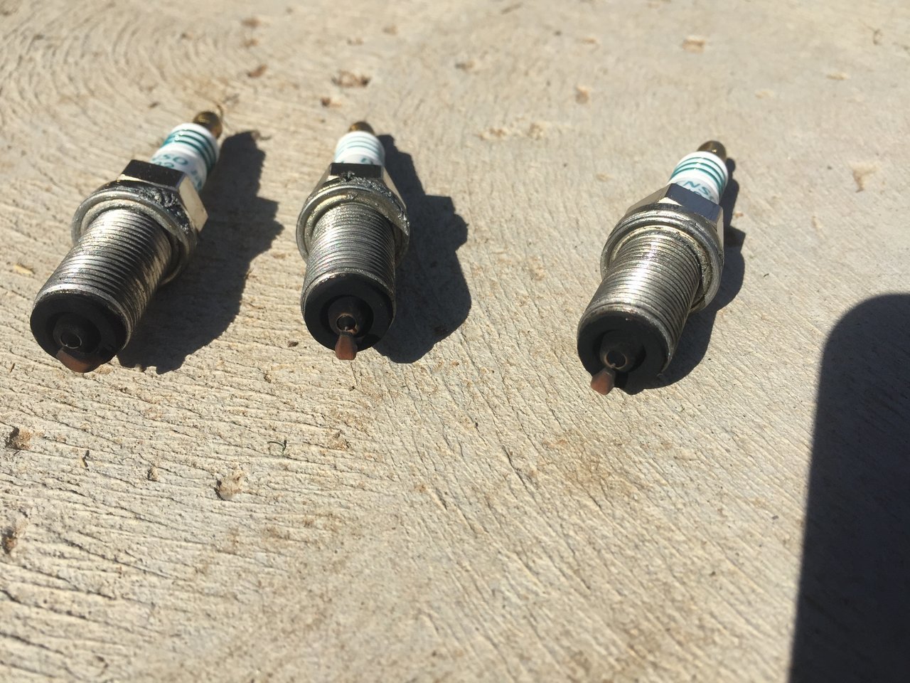

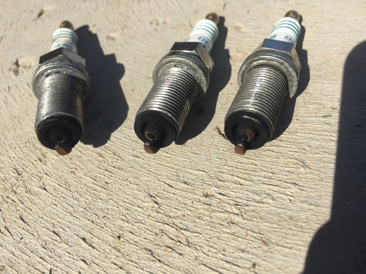

  15. Oct 27, 2017 at 3:18 PM
    #1235
    Voodoo Rufus
    Voodoo Rufus Well-Known Member
    Jul 3, 2009
    #19255
    822
    Jason
    Bakersfield, CA
    07 Sport Indigo Ink DCSB 4WD
    Magnuson S/C, Relentless armor, Icon/Dakar suspension, Konig CountersteerX 17", KO2's, Hellwig rear swaybar, BudBuilt Trac Bar, Level 10 VBU, Weathertech floorliners, Cravenspeed antenna, Redline elite hood struts, RollnLock, Satoshi, CBI sliders
    So I just pulled all my plugs for a compression test. How do you like that blackness? Getting low rpm, low vacuum high load pinging in top gear but otherwise drives fine. Rough idle lately, and mileage has been total crap. Currently doing some remote troubleshooting with the UCON folks.
    loginfailed, Roostfactor and jojotoo like this.
