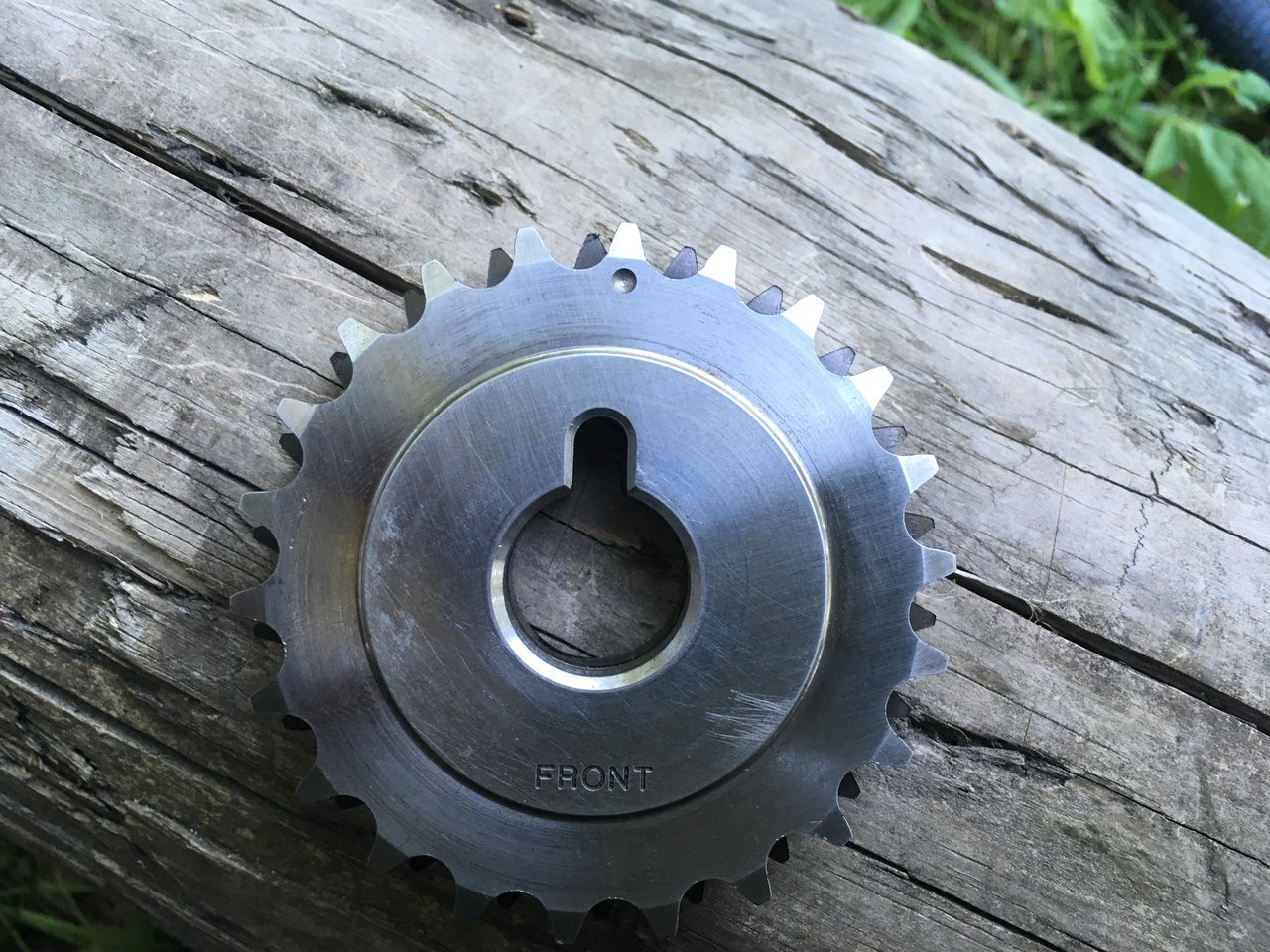

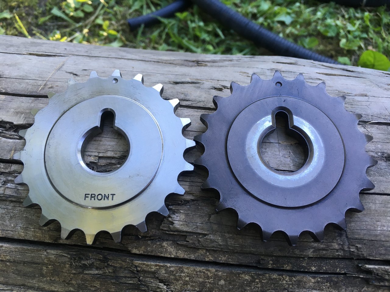

    It would be easy to do the cam gears by modifying the oem ones. Just find some shop with CAD and laser, or just file them by yourself.
    You could just do a new hollow to the opposite side and 3° off.
    URD left, OEM right:
    Can you see the difference?
