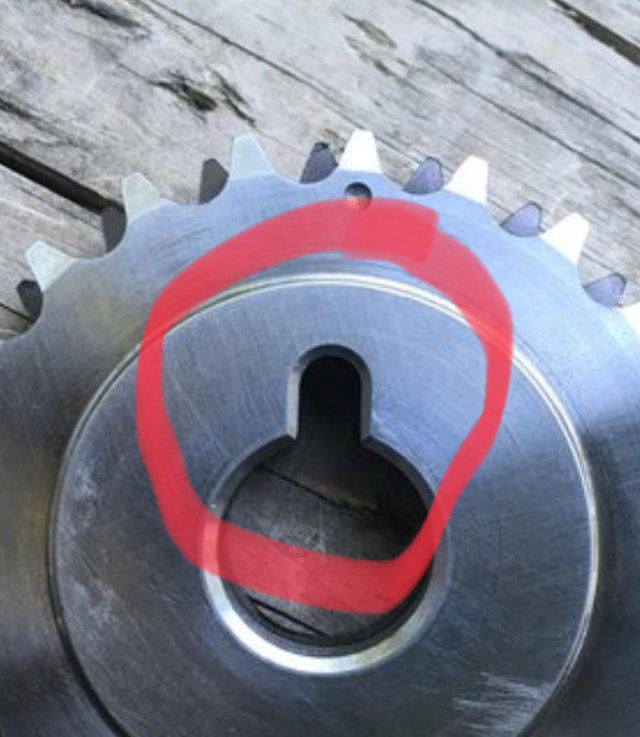

    What if you get redone the OEM gears to match URD’s?

    Is that actually even possible? Sounds like it potentially could be expensive

    Should be a piece of cake to someone with right equipments.
    You need only get this groove redone:E89BA999-F0C4-49BD-910F-04474B615C95.jpg

    But wouldnt part of the original still be there? I am not a metal worker obviously
    As in the original slot will still be partly there right?

    You'd have to cut a new slot in the stock gears, probably about 180 degrees from the original one. So you'd need a datum reference to figure out where 0 degrees was, then just offset 3 degrees from there. Easy peasy.

    Send Gadget an email. Ive spent a lot at urd so hopefully he is helpful. Otherwise Ill start looking for a machine shop up to the task
