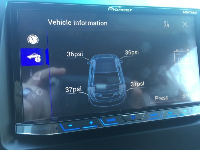

    I have the 4201 with the maestro. It works fine. Press the left arrow on the steering wheel and gauges pop up on the screen. It also shows tire pressures and temp in another screen and lets you read DTCs if your CEL is on.

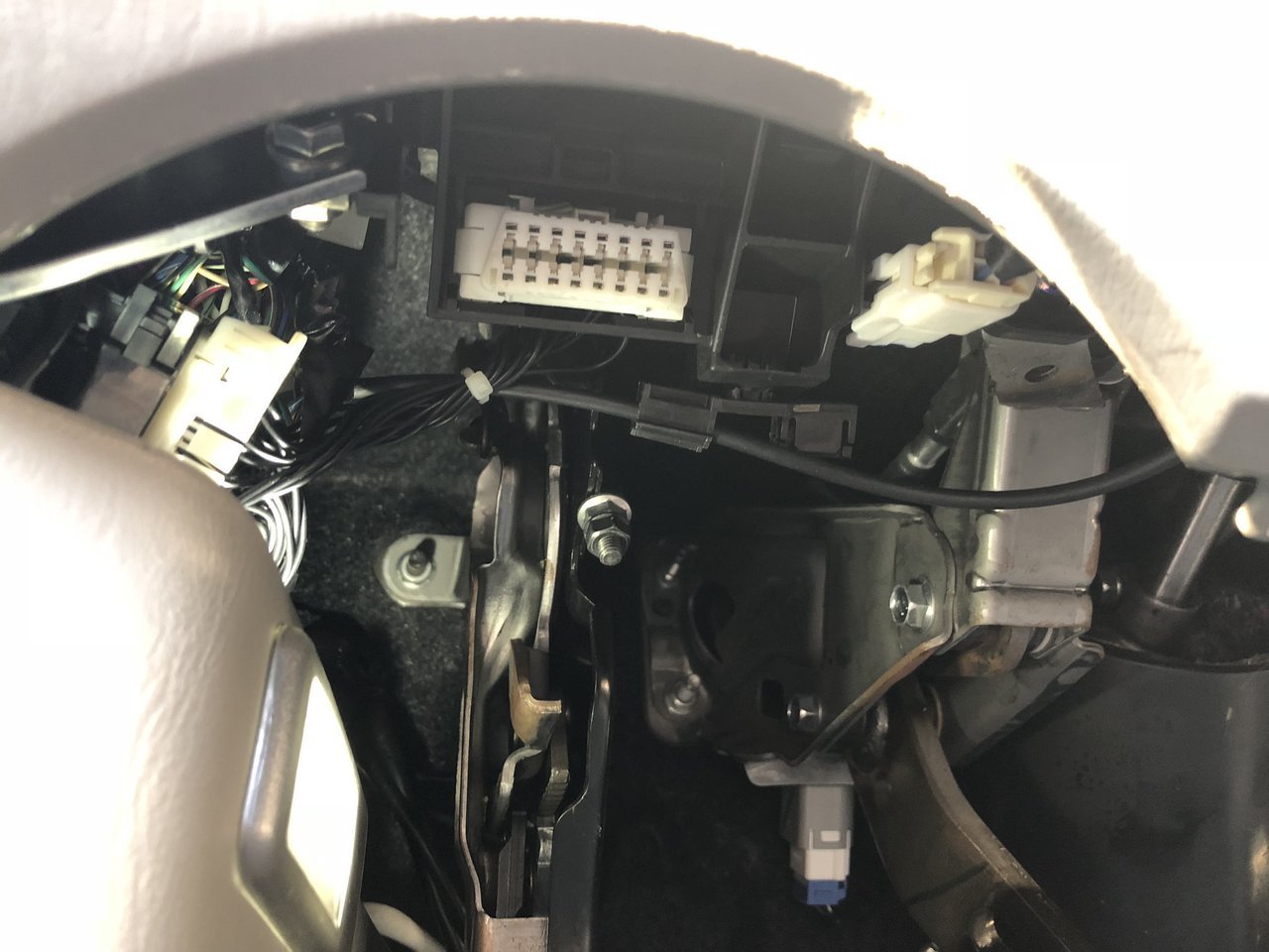

    It’s the OBD2 connector under the dashboard on the driver side. Close to the parking brake pedal.

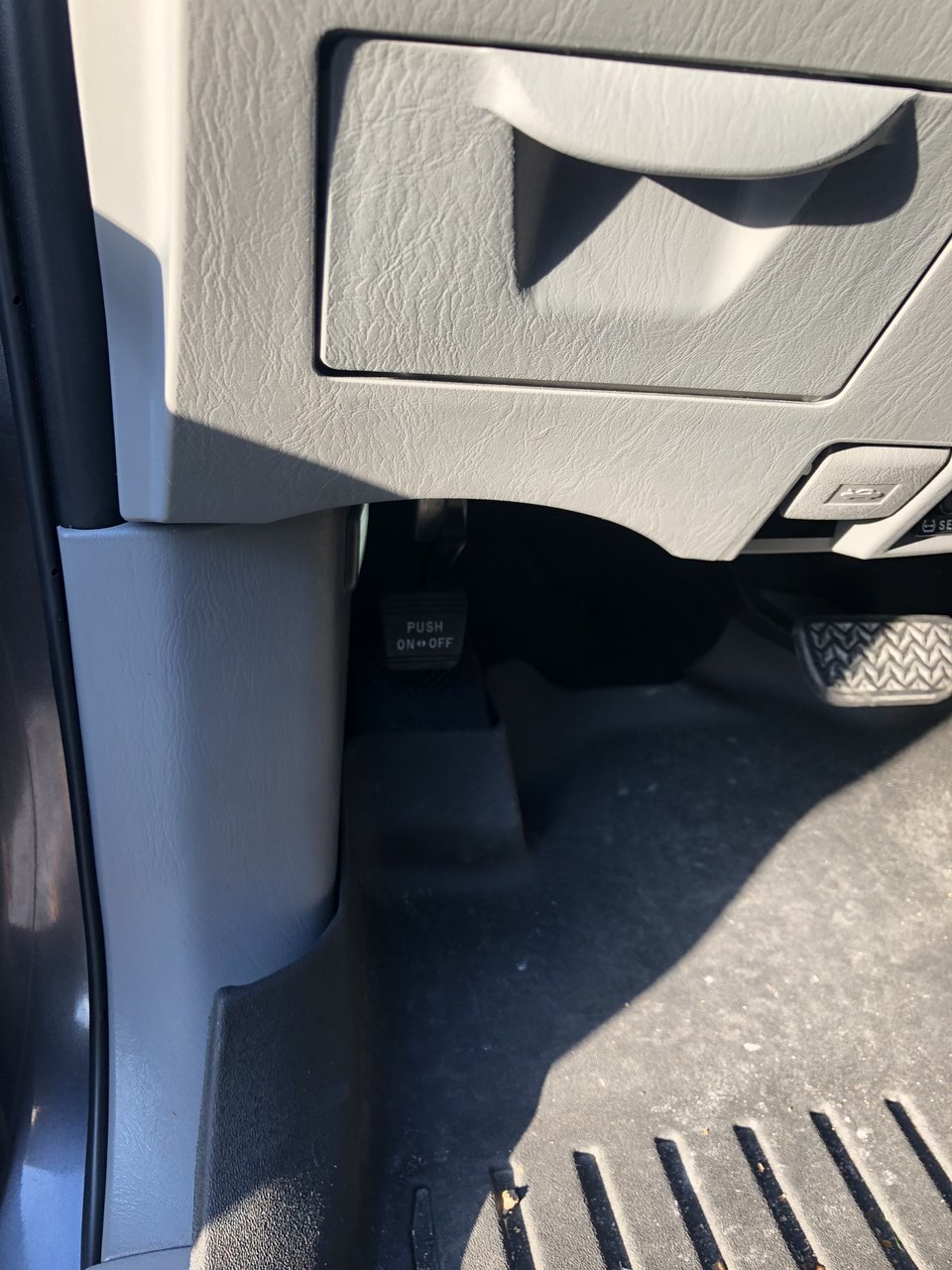

    For a frame of reference, this area:
    Then look up:
