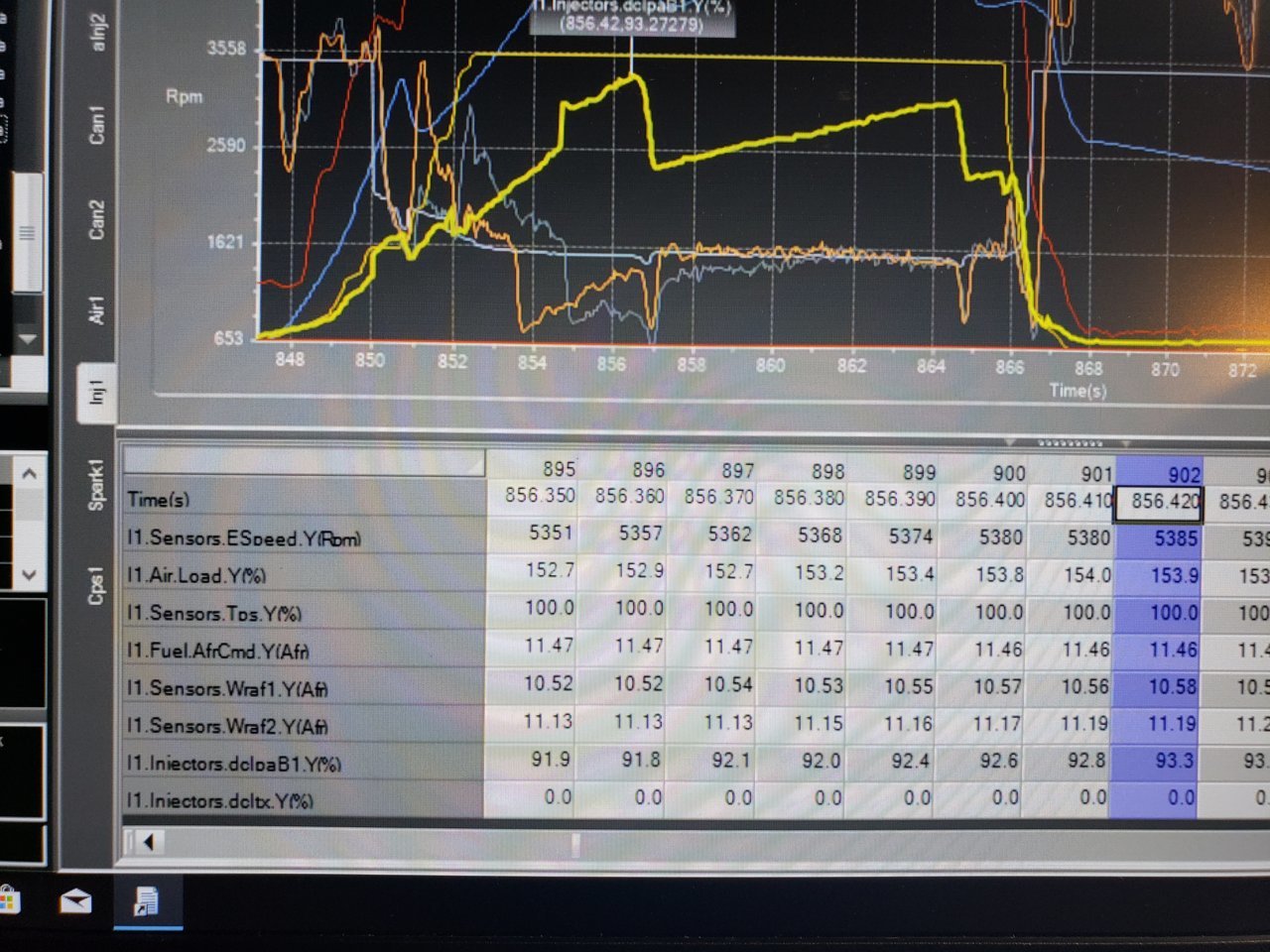

    Here is my idc with 455cc injectors and 2.7 pulley. 93.3% idc is why I recommend people dont go smaller than 2.8 with UCON.15385341236352798799116874665879.jpg
    Notice though that commanded afr was still 11.46 at 153.9% air load.

    Calgary, Alberta
    2016 TACO LTD, 88 4runner, 4th Gen 4Runner
    TRD S/C 2.3" pulley mild ported Portmatched/cleaned intake runner Ucon EMS/cam gears/160 t-stat 840cc injectors 255 LPH walbro fuel pump Urd equal length headers Urd competition y-pipe AFE 3” Exhaust Vibrant resonator Oil Catch can Ratio-tek valvebody upgrade 3" bilstein/OME lift Dakar rear 7-leaf pack 32" KO2's load range C Stealth custom wheels Ray-10's Volk Te37X’s Tundra front 13.3” brakes Custom fab rock sliders LC-2 wideband autometer boost gauge Cravenspeed gauge pod mount Scangauge 2 SC MODS: Pulley ripp mod/belt wrap mod/ fleetrunner belt/ tensioner stop delete mod/ bypass jet delete mod
    Hmm. Thanks a tons for digging into your graph!
    Well that confirms that infact the command afr varies from yours to mine, although I’ll confirm what the definite commanded number is at those loads in utune once I get home.
    I am running the the Urd Deka 800cc injectors so I’d imagine there is still room left within the IDC.

    That 93% dc was with 455cc injectors on a 2.7 pulley.
    My idc now with 2.5 and 640's is around 80% so you have headroom.
