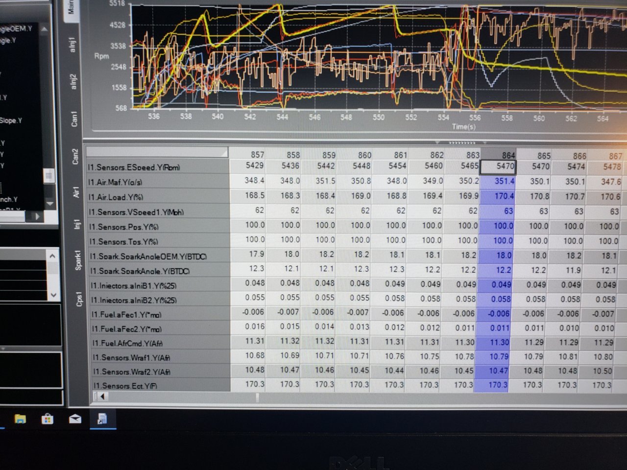

    TRD S/C 2.3" pulley mild ported Portmatched/cleaned intake runner Ucon EMS/cam gears/160 t-stat 840cc injectors 255 LPH walbro fuel pump Urd equal length headers Urd competition y-pipe AFE 3” Exhaust Vibrant resonator Oil Catch can Ratio-tek valvebody upgrade 3" bilstein/OME lift Dakar rear 7-leaf pack 32" KO2's load range C Stealth custom wheels Ray-10's Volk Te37X’s Tundra front 13.3” brakes Custom fab rock sliders LC-2 wideband autometer boost gauge Cravenspeed gauge pod mount Scangauge 2 SC MODS: Pulley ripp mod/belt wrap mod/ fleetrunner belt/ tensioner stop delete mod/ bypass jet delete mod
    Pulled up some logs, all I could find is logs with my old rotrex setup that shows commands at 11.4 at 150ish load.
    Without logging how can I see/pull up the intended afr command Scott had set with my current Cal?

    I dont think you can with our version. We only get the "lite" version so we cant manipulate or see all parameters.

    Im probably wrong.. but while the commanded AFR is 11.3, it looks like youre at 10.79/10.47, no ?

    Good eye!
    Yeah I saw that but as you move further along in time the afr's lean back out to commanded.
    This log was done right after the 640 injector install and new tune so the ecu/UCON was still learning.
