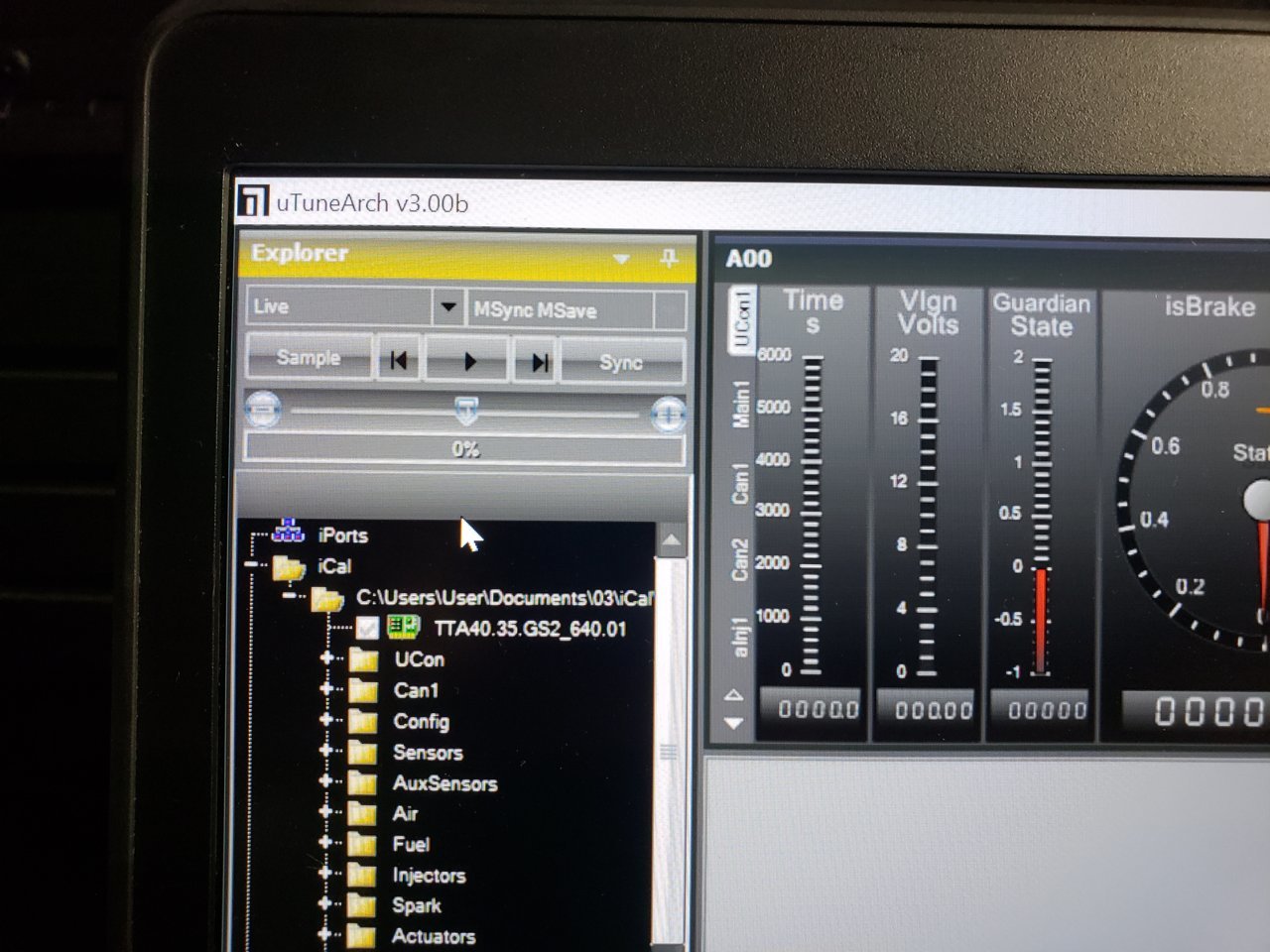

    I know you were having trouble figuring out how to do a data log. Did you ever figure that out? A data log is the best information you can provide to Scott for troubleshooting. So the best thing you can do is figure out how to reproduce variables that cause the check engine light and then try to capture it in a log. These intermittent issues are tedious to catch in a log, though. So it takes a good amount of patience.

    To take a datalog open utune on a laptop while plugged in via usb to the ucon.
    Disclaimer....with a passenger click the "sample" button in utune. This will take a 60 second datalog.
    It's in the upper left hand corner.

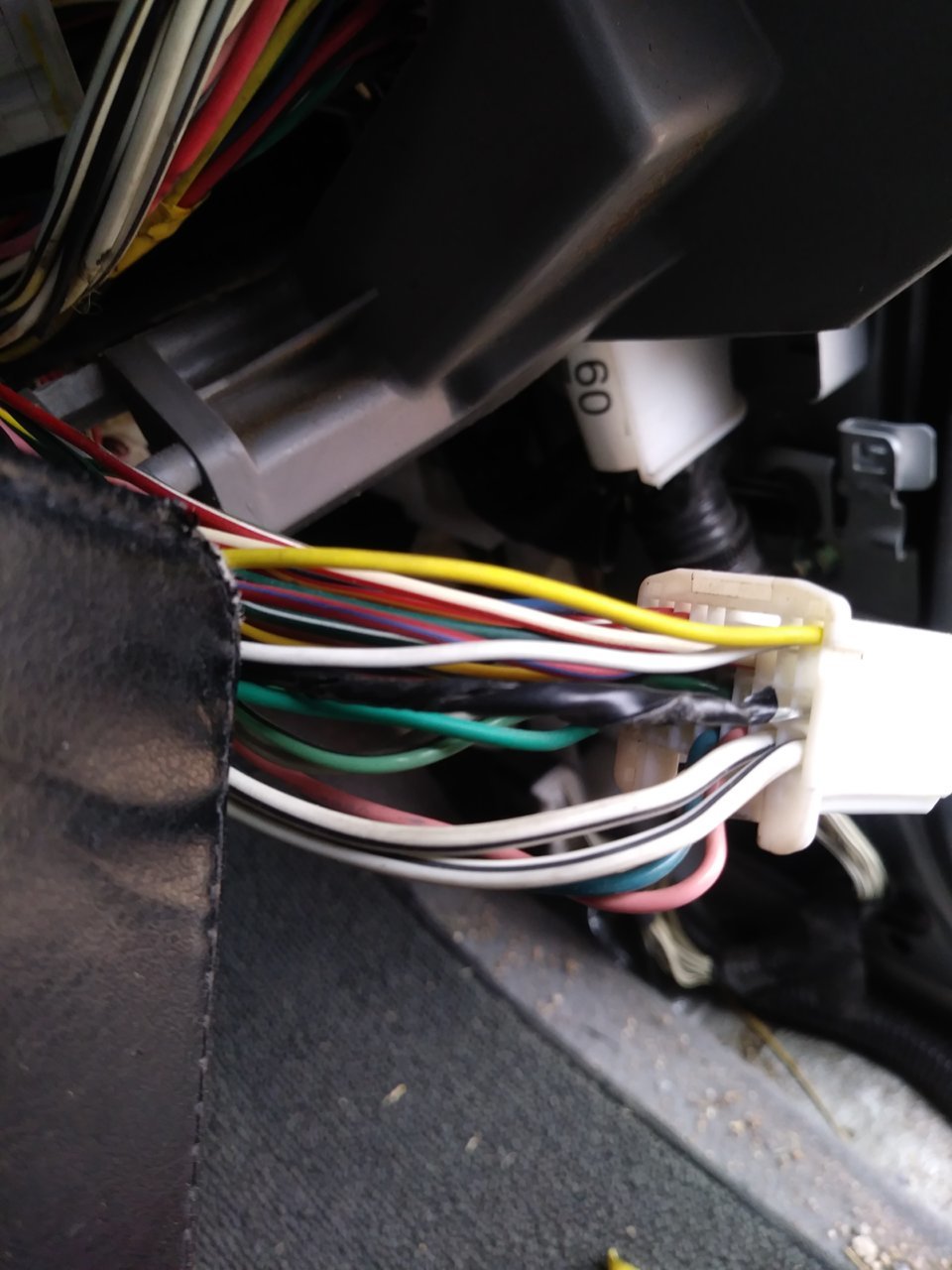

    I got the 02s from Amazon. Right now it's showing rich on bank 2. Way rich. We're pulling the ucon to see if it evens out without it. I wont be driving just idling.
    The picture is of the factory harnes plug that goes in to the top of the ucon. Notice the bare wire.

    That bare wire with tape is just a shield wire. To send to ground the induced voltages caused by magnetic resonance.
