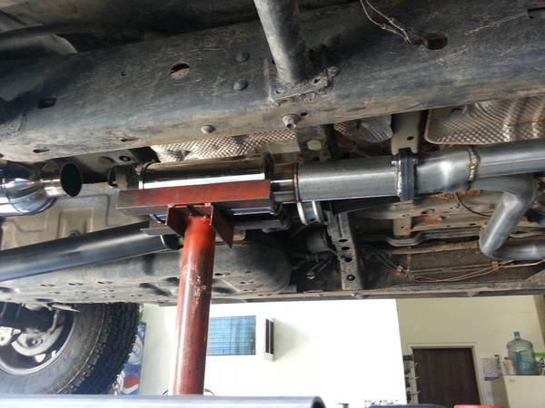

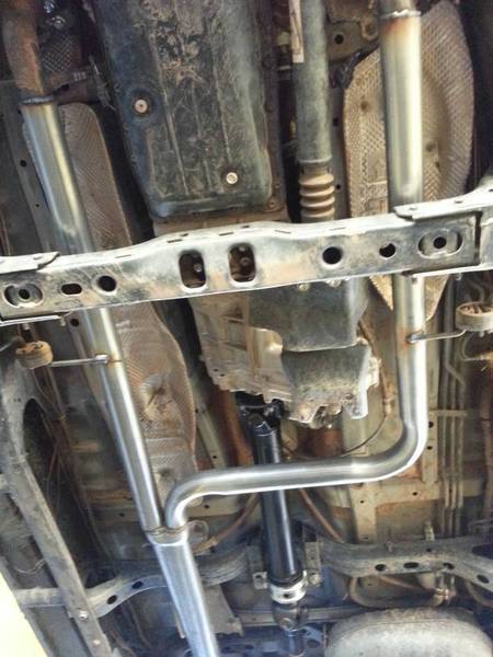

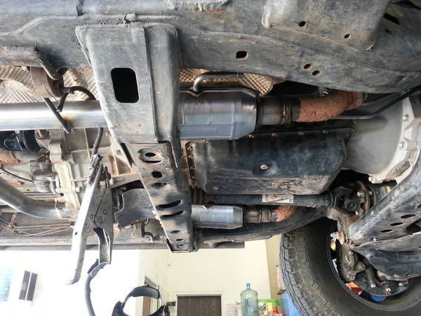

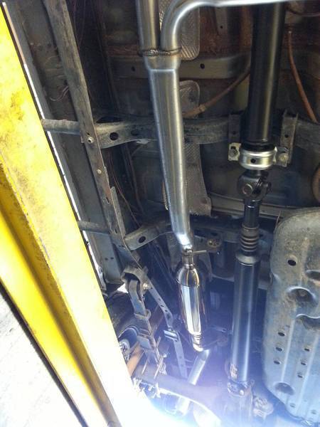

    Here's my Borla I threw in. PN: Borla XR-1 #40943
    The Magnaflow is PN #12579. 3" in/out. 11"x5" Oval
    #1) I started with stock exhaust.. and ran an Aeroturbine 2525xl in place of the factory muffler and liked it.
    #2) Then I started upgrading after boost.. I originally had URD Spec-U's paired with a custom high clearance 2.25" Y pipe (no cats) into 3" piping and a Aeroturbine 3030xl. it was awful. lol
    #3) Then I added cats in the Y and the Vibrant Ultra Quiet resonator in front of the Aero.. still no bueno..
    #4) Pulled the vibrant and aero3030xl. replaced with Borla and Magnaflow mufflers.
    Current: URD Spec-U's into 2.25" high clearance Y-Pipe with cats, into Borla XR-1, into Magnaflow 12579. love it. smooth, no rasp or drone. slight rumble.

    Thanks for all the details and history. It helps greatly! You do have the Mag that splits into two pipes internally. This comes from all URD systems as far as I know.
