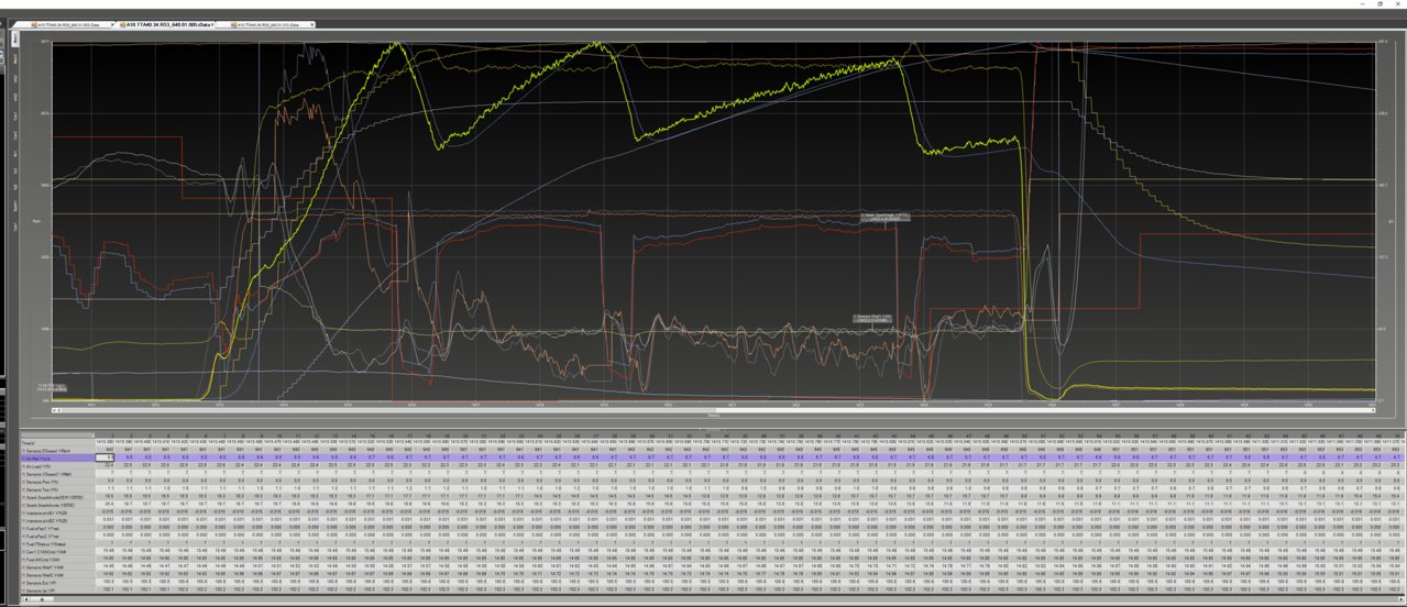

    I've logged it and discussed with Scott. You can clearly see the event and the vehicle pulling throttle despite command. He feels like there's an issue outside of the UCON, but I haven't been able to confirm this.
    From Scott:
    "Regarding the unexpected decel:
    I do see the throttle pulling back from 21 to 8.79 when the pedal is firm increasing (plot 2).
    Mass airflow is spiking high then low (toggle) around the event (plot 3, point 2536)
    The CAMs are both falling from 16 to 6’ around the same point.
    AFR control is nominal – no lean spikes.
    Engine acceleration does not decrease until 300ms later.
    Spark angle is being driven by torque control mode…
    So the MAF toggle presents like a physical issue.
    It occurs before the throttle drop.
    And you mention that this only happens more when turning.
    I would examine your air induction pipes.
    Make sure there are no vacuum leaks and all pipes are moving when the vehicle flexes during turning…
    It could also be related to bad wheel speed sensor going into the traction control computer (UCon does not access).
    Try keeping traction control off and see if the unexpected decel disappears…"
    Here's a screen shot of the event.
    I still am a bit confused by the whole situation. Since this occurred, I have installed the Nomad Valve body, and I feel like this happens "less frequently". I do feel like this very well could be connected to the traction control/ VSC system. Sometimes when I'm accelerating in a straight line, the engine will pull the throttle back repeatedly during the same acceleration run. I won't get a traction control light, which is weird! This throttle oscillation (full to no throttle) can happen 10 times on the same acceleration event. However this doesn't always happen, it's usually if I've gone over a bump in the road or some sort of uneven traction event.
    In an unrelated event yesterday, during a light sweeping turn to the right while under firmer acceleration, the traction control light kicked on and lightly modulated the throttle at around 45mph. This event was a great application of the traction control system, and not what I'm describing above.
    I do wonder if this could be related to my VSC system. I think this was the first year for it. Do you guys have VSC? I think it was mandated only for the suv's during the 2007 year?

  4. Jul 23, 2019 at 1:00 PM
    #1644
    BassAckwards
    BassAckwards Well-Known Member
    May 3, 2016
    #186002
    27,954
    2009 Tacoma AWD Turbo 2TR-FE
    Full-time AWD & BorgWarner EFR 6258
    Lol, my thoughts exactly.
    Id personally recommend resetting it and then try driving easy to let it relearn that part of your driving style.
    Athlaos[QUOTED] likes this.

  6. Jul 23, 2019 at 1:09 PM
    #1646
    DocME
    DocME Well-Known Member
    Aug 24, 2018
    #263956
    1,583
    California
    '07 FJ Cruiser
    TRD S/C, UCON, 61# inj, 2.5 pulley, 7th inj, Roostfactor Y Pipe, URD exhaust, WAT Nomad Valve body, Dana 60, DK LT, JD FAB LCA mounts, custom roof rack...and way too many others.
    I want to add to this that ever since I've gone to 315's, I can clearly tell that I have a much higher center of gravity. The change from 295's to 315's was significant. I also am currently running without a front sway bar (testing) and I intend to revert back to the sway bar. My body roll is significant and I wonder if this in any way can contribute to an over active VSC. Usually, if VSC kicks in it does so with an audible alert and flashing lights on the dash. Its quite the moment really. However, like I've said earlier, I'm not seeing any of this when I feel the throttle cut issues. I'm curious if the vehicle is utilizing the data and quietly making calls for brief throttle augmentations among other parameters as a means to straighten up the vehicle.
    BassAckwards likes this.
  7. Jul 23, 2019 at 1:12 PM
    #1647
    Athlaos
    Athlaos Destruction Mode
    Nov 24, 2010
    #46672
    2,652
    Leigh
    Edmonton
    2011 SR5 Manual TRD SC 1.87" pulley
    A flux retro-capacitance encabulator
    Interesting. I don't have VSC on my truck any more. When I put the after-market steering wheel in 7 years ago, traction control and VSC just gave up and hasn't worked since. I prefer it that way, I never found those systems useful or comfortable. And I live where the roads get like skating rinks.
    DocME[QUOTED] and BassAckwards like this.
  8. Jul 23, 2019 at 1:14 PM
    #1648
    BassAckwards
    May 3, 2016
    #186002
    27,954
    I would say it definitely can, as i have a 3" lift, no sway bar, and 295s on my other taco. My vsc cuts my power if i go into a corner too fast and sometimes in other stupid situations where it's not needed(even after resetting it using this thread) but it always blinks the lights and chirps at me when it does this, so i am not sure thats whats happening in your case.
  9. Jul 23, 2019 at 2:02 PM

    Doesn't the FJ have a yaw sensor, like the 4Runner? Is so, disconnect the ABS plug on the master cylinder(assuming the same as the 4Runner) or pull that fuse. Then try the same driving styles.
    This, or set a gas cap CEL.
    This is what we have to do on Lucario Runner's 4Runner, when he races.

    Yeah, this is the next step for me.
    A lot of FJ guys just throw in a vsc cancel switch on the purple blue with yellow tracer wire that goes from the master cylinder to the driver’s side kick panel. Pin 26 on connector A4.
    edit: The blue wire mod may only work on vehicles with the factory e locker. Others have also thrown a switch on the purple wire that goes to the plug you mentioned. I think with the blue and yellow tracer wire, you may not need a restart to return to normal.....
