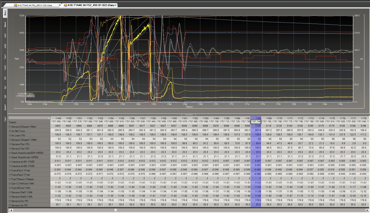

    I did some digging from when i was running a 2.6" pulley with my UCon. I was also spraying 375 ml/min of water meth at that time and have URD equal length headers, roosty y-pipe, and 3" catback. My max MAF I saw was 342.6 g/s in 2nd gear and 343.5 g/s in 3rd and my truck is also a 6 speed like yours, but im regeared to 4.10s and running stock sized tires.

    What's the peak MAF you see in 1st? I would expect to see something similar in 2nd gear.. 267 g/s seems a little low imo

    Mine:
    All is nominal:
    AFR control is excellent
    UCon adaptives close to zero
    Max MAF 354 g/s good
    Wot Spark 16’ (94829,165)
    No signs of knock…
    That was all per Scott.
    details:
    1. Vehicle has URD 7th injector, 61# per hour injectors, 2.5" pulley, Stock ECU has TRD Tune.
    2. Sparkplug type/gap: Denso IKH24 Gap .033-.034"
    3. Exhaust type:URD Equal length headers, currently have stock y pipe, but will have custom equal length catless y pipe in 1 month, Full URD 3" stainless exhaust.
    4. CAI: AFE magnum CAI
    5. Fuel pump:Aeromotive 11542 stealth 340lph
    6. Throttle body (stock or modified): Stock with 7th injector.
    7. Tire size (stock or size): 315/75/16's (~35")
    8. Axle (stock or ratio): 4.88:1
    9. Battery system (stock or modified): Northstar 37F AGM battery, DC Engineering 250AMP alternator, all 1/0 primary cables.
    10. Snorkel (no or brand):NONE
    11. Harness modifications (cut or soldered): Tapped into reverse light circuit for back up lights. I will be tapping into the A/C Clutch power supply to trigger a timer relay for the electric fans.
    BassAckwards likes this.

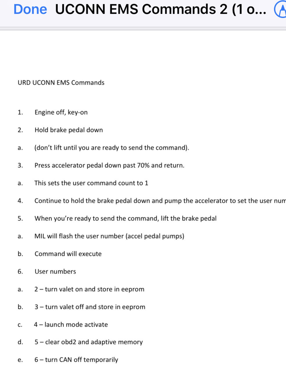

    Also, I was looking for this a while back. Here’s the command list for the UCON. 00324121-4732-4BAD-BEFC-D623E55D2862.jpg

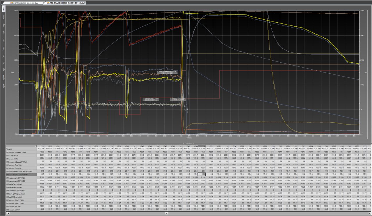

    First, I did a sound dreading project that was overly thorough. On my first log I only hit 316 but when I inquired about throttle position, I was at 75% of 100%. I cut out a little MVL and foam and the numbers above came immediately.
    I also have some issues with the throttle being pulled back under firm throttle especially with the wheel turned slightly. Scott said the same thing that the motor could be torqued over and interrupting flow across the maf. I now have solid engine and tranny mounts and I still have that issue. Maybe more frequently.
    I personally think that the issue is in the yaw sensor when compared to the steering wheel position(torque vectoring g?). I so want to try removing them and see what happens.
