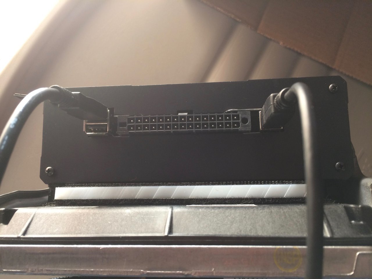

    Could someone help me out which cables those are? Mine didn’t come with it.
  11. Mar 26, 2025 at 3:12 PM
    #1711
    TegoTaco
    TegoTaco Well-Known Member
    Sep 29, 2016
    #198555
    7,289
    Ontario, Canada
    ‘13 SUPERCHARGED DCLB TRD SPORT
    I have to leave the truck ignition to on for about 30mins before starting the truck up once the UCON is plugged in?
