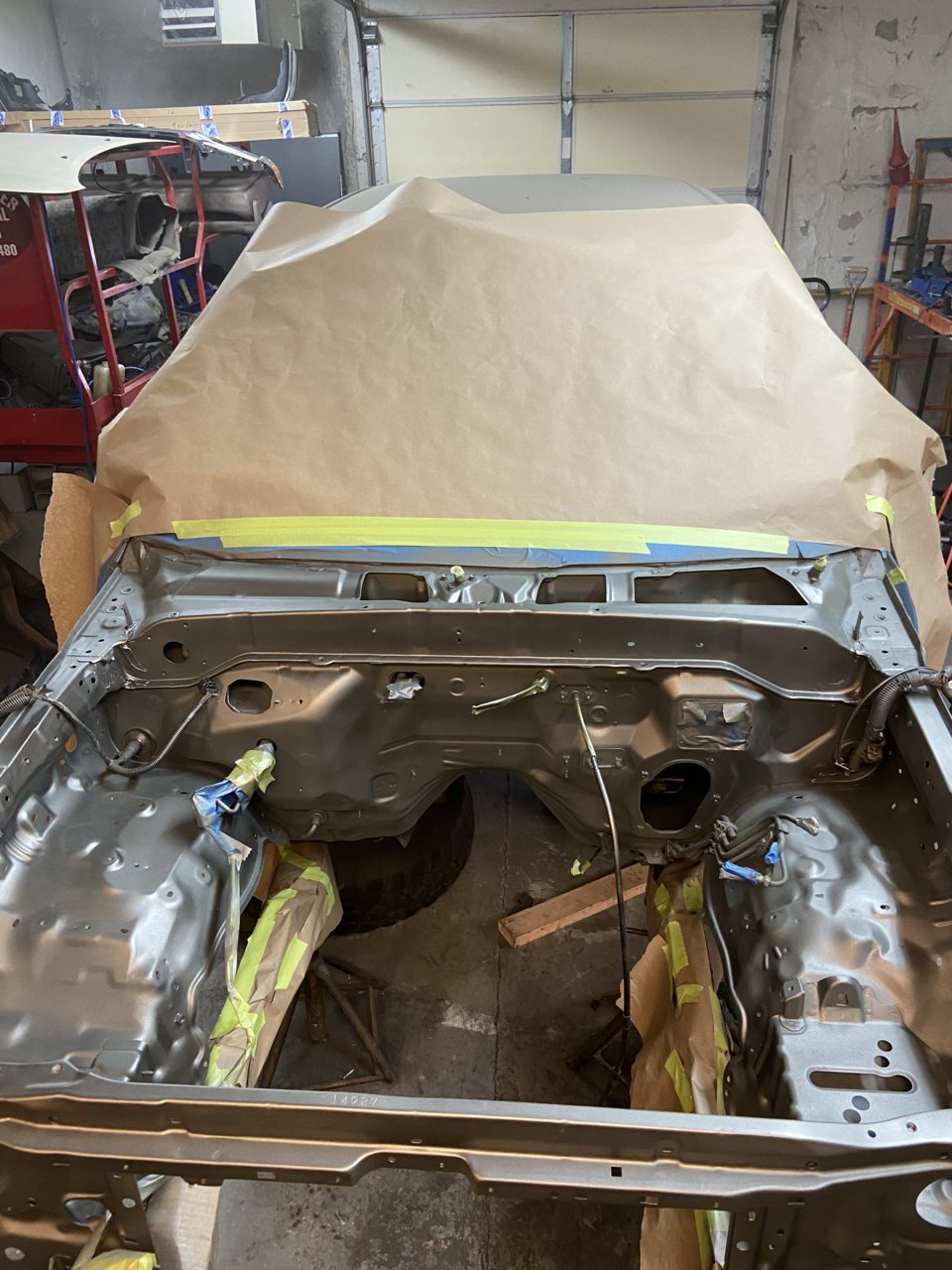

    First base coat

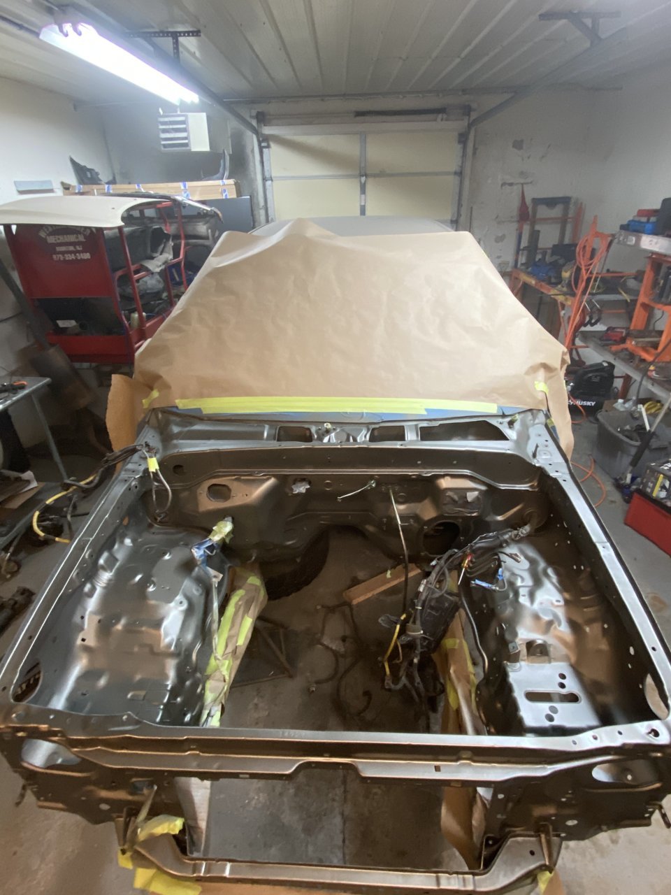

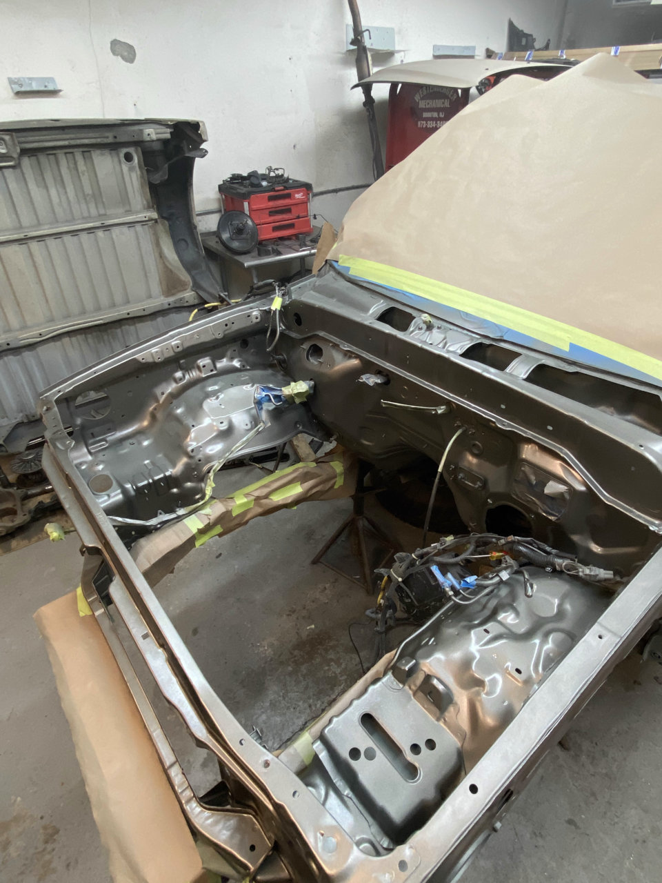

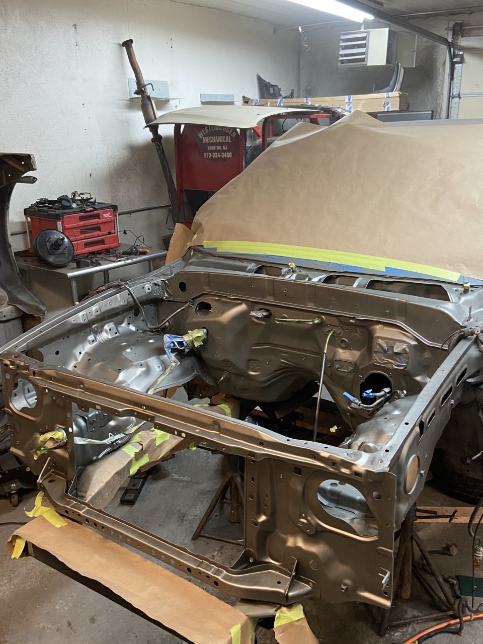

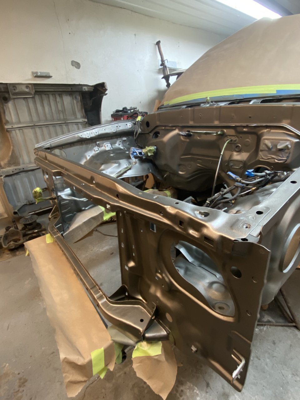

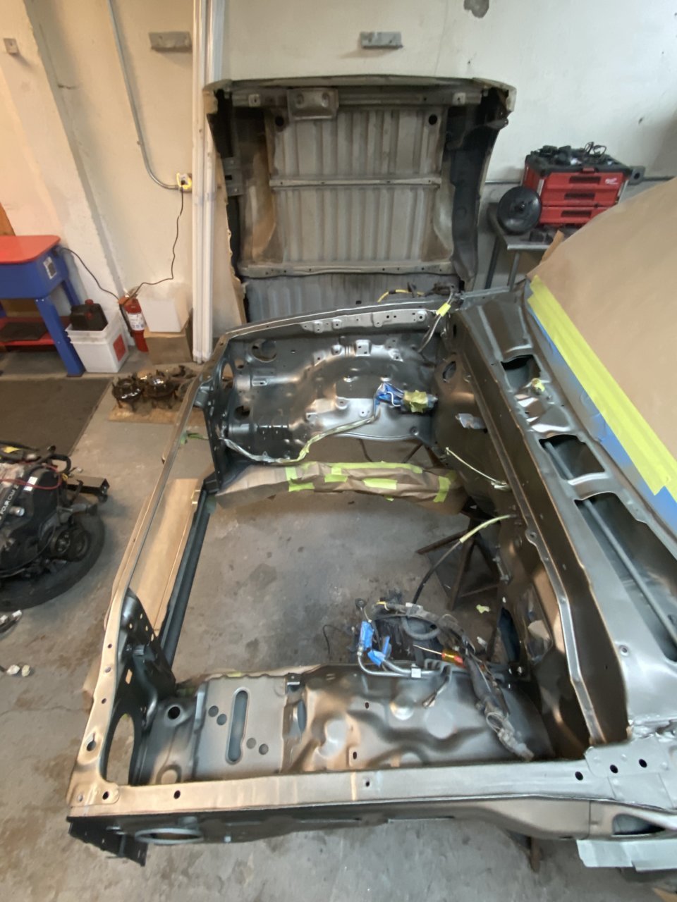

    Clear. Put 3 coats on but prob could use another heavy one on firewall but I’m gonna call it a success and be done. Color turned out cool.
    Paint update - started putting the harness back on and was scratching the rough paint in the tight spots under fender rail so my worry about the clear coat was correct. Have to wetsand it all and do another 2 coats with more flow on the gun so I get better coverage. Kinda sucks. I would rather have orange peel that was thick and strong in the engine bay. So, gotta spend saturday prepping and painting instead of installing shit. Kind of a bummer.
    824B95FE-2E37-4127-ABBD-66C8BFF68389.jpg 10966732-43B9-472A-9F26-85A9C2DD7040.jpg E57B8B86-27F8-4184-800B-C62F31E653FC.jpg
    Ended up doing more clear.
    UPDATE- DON'T PAINT YOUR ENGINE BAY. ITS A TRUCK

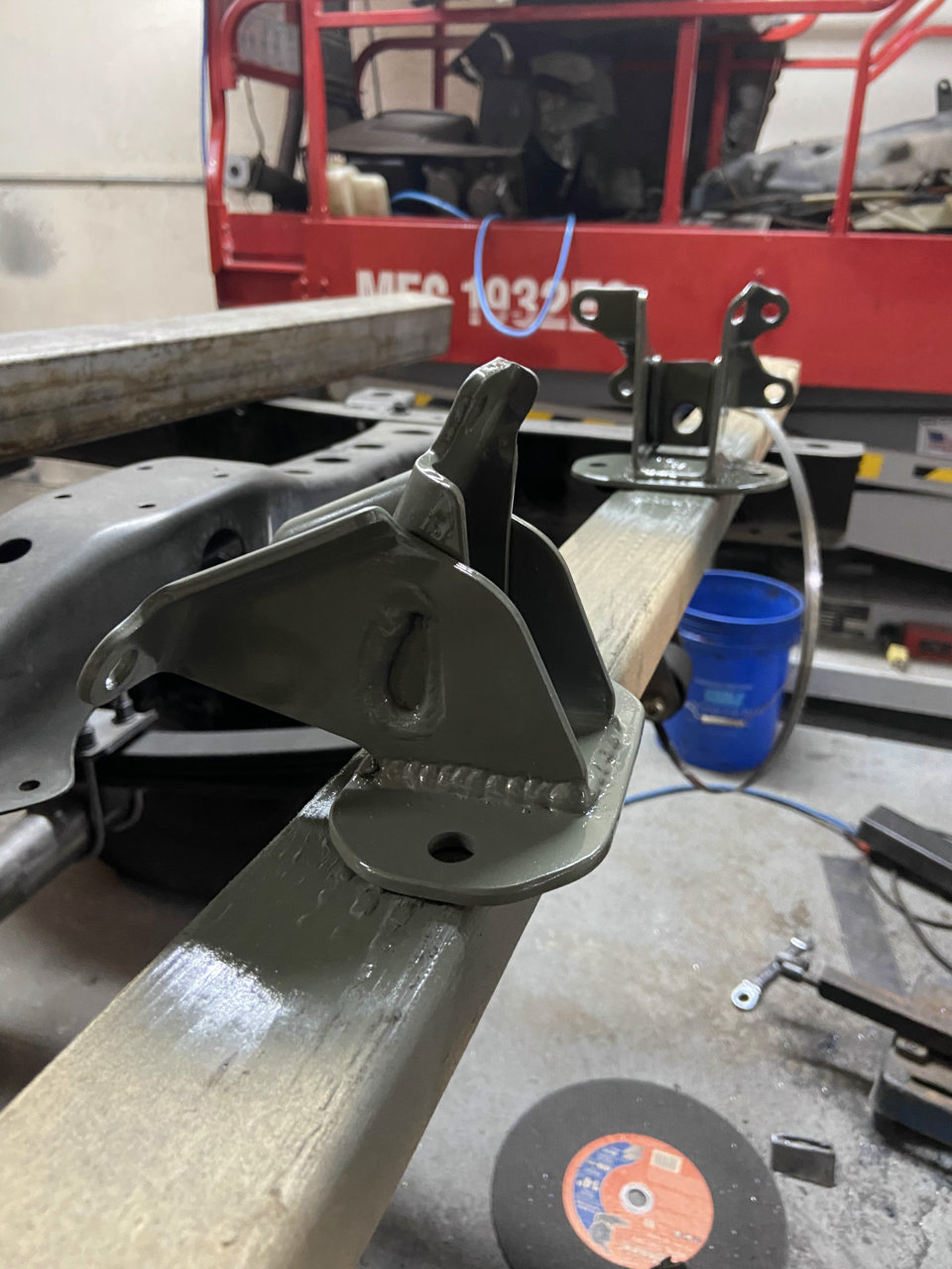

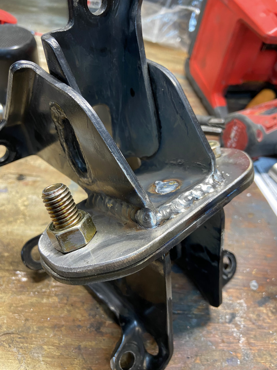

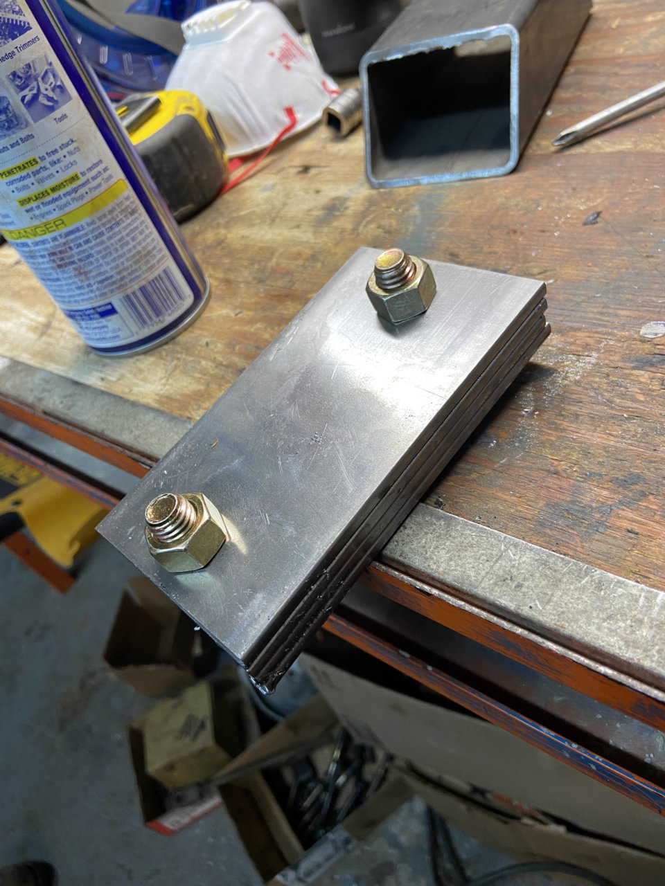

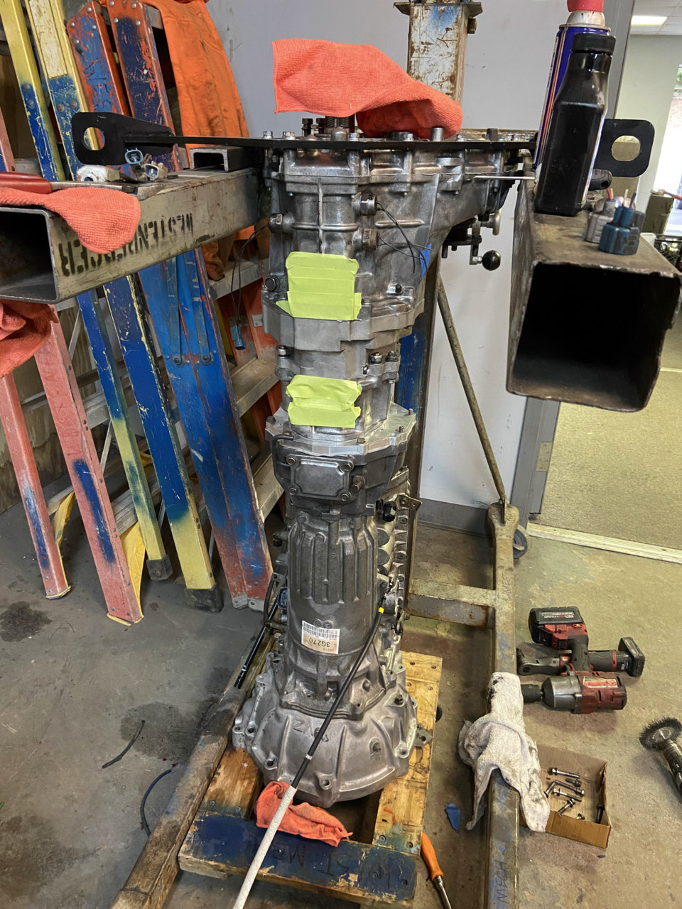

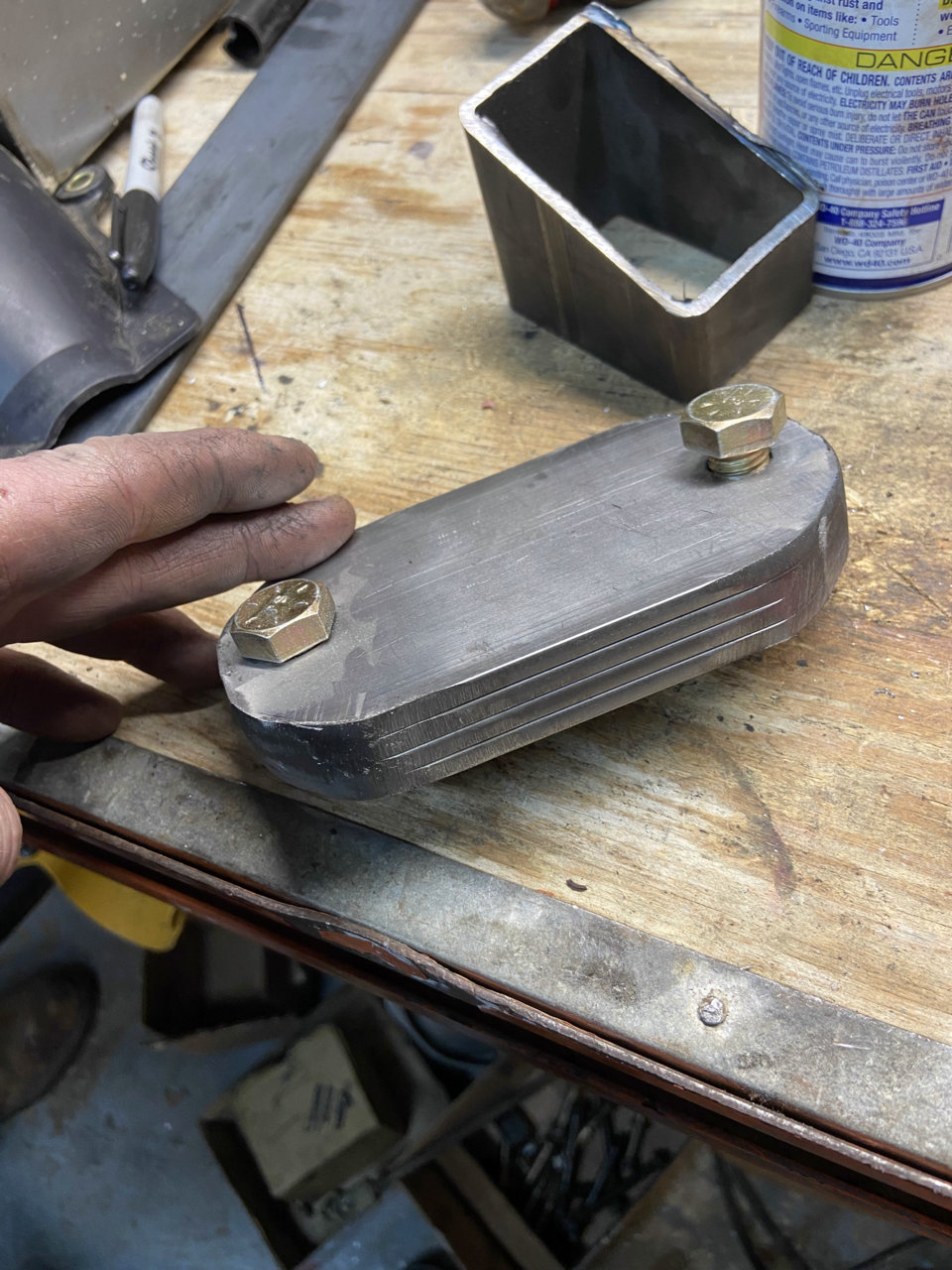

    Didn't have much time today but got the first half of the mounts done at least. A little tough to weld with a radius gap but they turned out so so. First time welding a joint with the new hood. I can see great but my technique is still not acceptable yet. Hopefully that changes soon.

    Know you painted them but I'd box in those engine mounts if you're wheeling this thing pretty hard.
    Kwikvette, Slashaar and Yota X[OP] like this.
  10. Mar 24, 2022 at 3:40 PM
    #250
    Yota X
    Yota X [OP] Some say dresser, I say dryer.
    Jul 11, 2019
    #298961
    5,268
    NW New Jersey
    1st gen
    ls turbo, tons, 40's and a partidge in a pear tree
    Fuck I was gonna too!. Is that from a solid mount setup or a failed rubber mount??
  11. Mar 24, 2022 at 3:42 PM
    #251
    Dalandser
    Dalandser ¡Me Gustan Las Tacos-mas!
    Feb 19, 2015
    #149090
    17,635
    Anthony
    Downey
    08 PreRunner Regular Cab / 98 4x4 Extra Cab
    Empty Wallet Mod
    Full disclosure it was from an accident my donor truck was in, but these are notorious to crumple on big impacts when wheeling - these were repurposed into these:

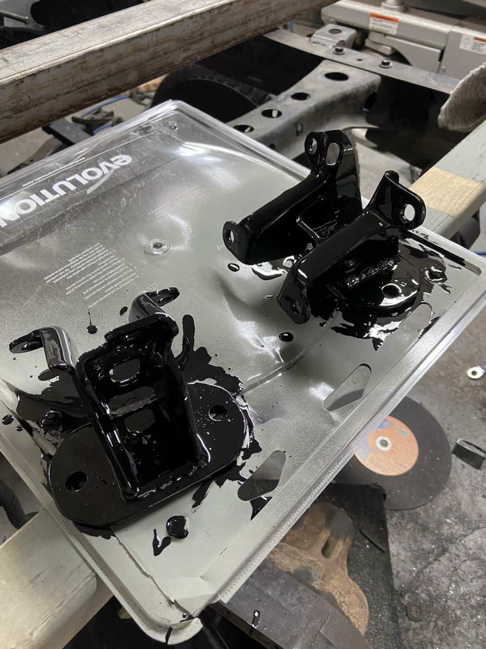

  12. Mar 24, 2022 at 3:45 PM

    Ive done several race motor solid mount setups in 4cyl awd cars and they twist when they torque a lot and I never had any issues. I was looking at the factory engine mount design and the force is going to transfer to about 1.5 inches directly down where the mount is super strong. So, if the trans/t case mount is strong, it should have no lateral movement. My setup is not gonna have any bolts like those ones you have that will cause movement. Its all metal. Idk, its just theory now. Ill prob just leave them cause that black paint is impossible to get off!
