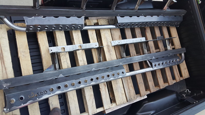

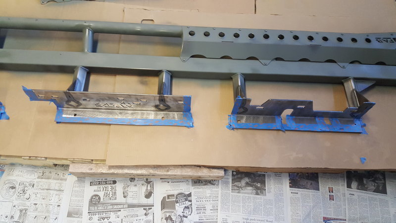

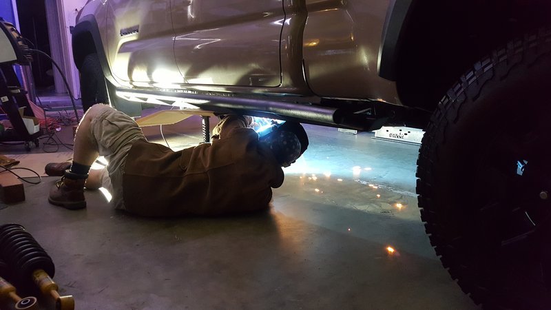

    I didn't get any pics as it was late and I just wanted to finish up, but I've got one slider painted up, just need to do another coat or 2 on the bottom, and then I have the 2nd slider to paint after work. Welding them on tonight and I'll take pics tomorrow when there's actually light out. I'll bring my camera tonight though to try and document the welding on and see how they come out!

    In the pics it doesn't look like you removed the step plates before painting. We recommend taking them off so that you can get complete paint coverage on the bottom of the step plate and on the tops of the tubing where they mount. If you do take the steps off, use a screw driver to install the screws by hand when re-assembling them. If you use an electric drill, its possible to break the head of the screw off if you run them in too hard.

    I took all plates off except that one. I managed to strip the heads of 2 of the bolts that were quite a bit tighter than the rest were unfortunately.

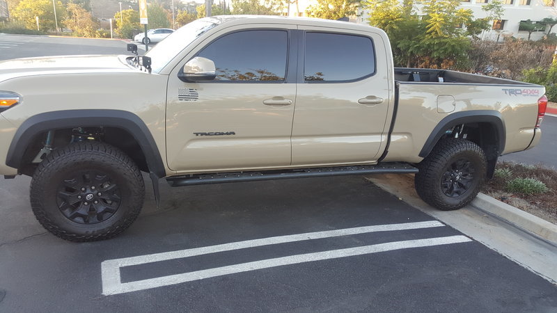

    Little sneak peak of the sliders going on. Full pictures to come tomorrow

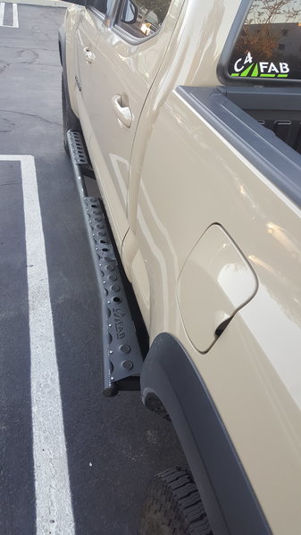

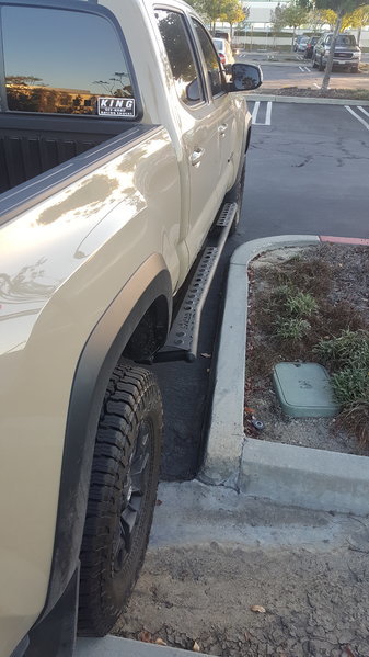

    Quick pictures of the sliders. Taken from my phone when I pulled in to work 5 minutes ago.

    Damn. Those look cool man. :thumbsup:
