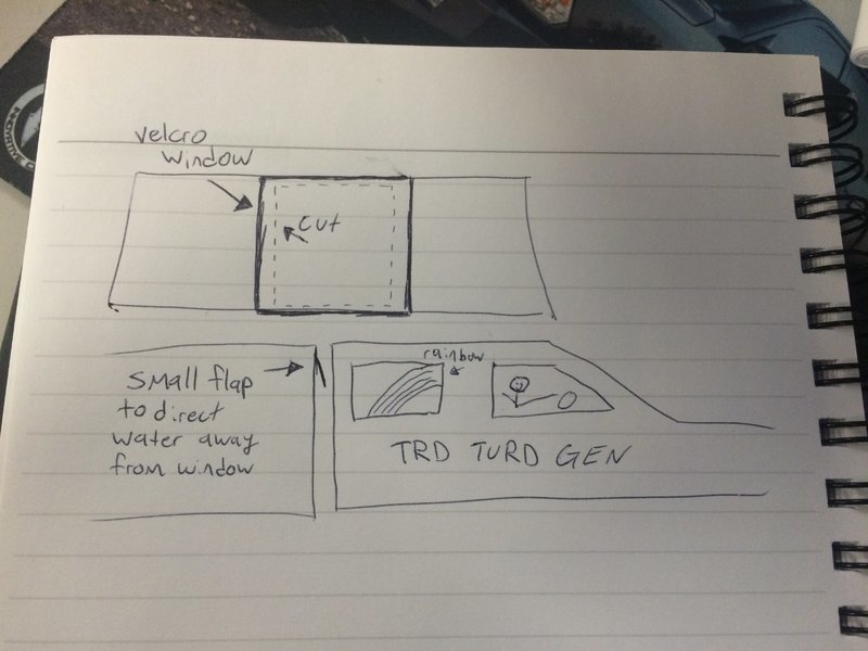

    Add a small strip at the top that angles out, like a shingle on the roof. That way any water that comes down runs away from your window.

    Hmm. Draw me a picture, birthday bitch, I'm more of a visual learner.

    Did your mom not teach you to be nice? Say please... bitch! Haha thank you Brian!

    Draw me a picture birthday bitch... please.

    Beacause you asked nicely, here you are princess.

    Excellent picture. So are you suggesting I get the new window Velcrod on and then add an additional flap on the outside? That makes sense.

    Correct. Velcro on the window from the inside. So if you're camping and need to open it to get into the back of the truck (assuming the slider window is cracked open) you'll be able to rip it open. if it happens to rain that small flap will direct water away from the velcro seal to avoid leaking.

    Can you or @YotaGurlIAm or @eon_blue recommend some good velcro that will adhere to the canvas? I've got some now but I don't think it's heavy-duty enough to withstand. I also need to velcro down the entire back panel canvas to the bed.

    just get some 3M tape, I got a 10lbs rating but they make higher ratings too.

    You want "automotive grade hook and loop fasteners" or "industrial grade" if possible. Otherwise what Madison is using for her's works perfectly to hold that entire front section to the bed, I'd imagine it would work great for the window too.
