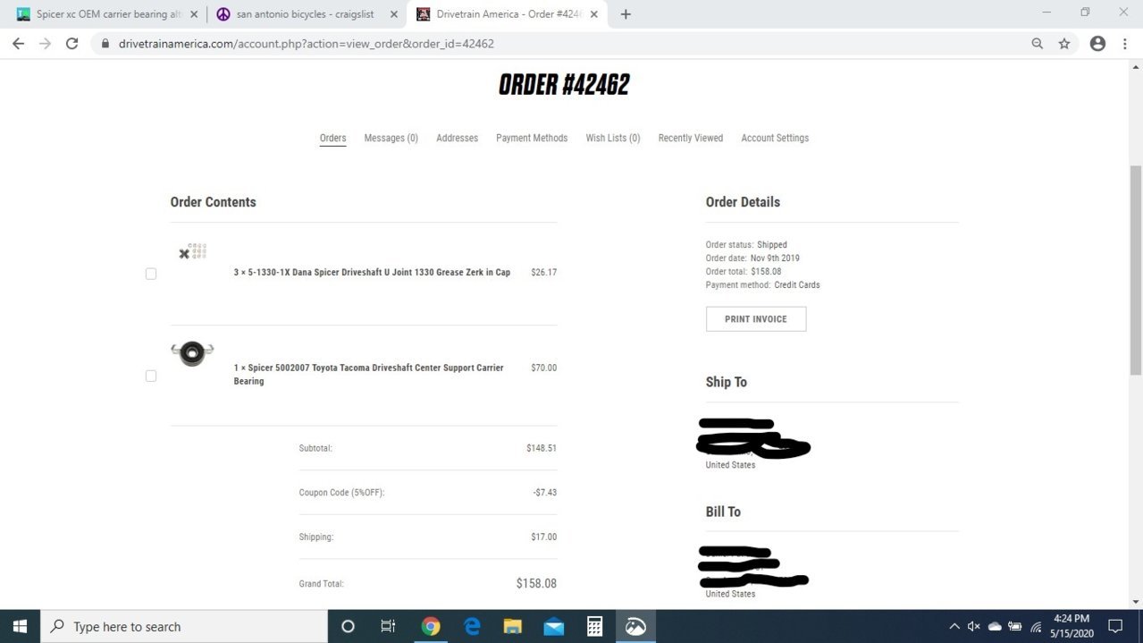

    Good advice. Only thing Ill add is to get genuine Dana Spicer parts from somewhere like
    https://www.drivetrainamerica.com
    Umm lets see, if you do the CB youll have to put the driveshaft back in the truck (can do it backwards so its easier away from the T case) to torque that big ass nut down properly
    Also youll want a puller for the yoke (or take your time with a chisel and hammer) if you do the CB. And watch out for the washer that gets stuck to the old center bearing!! Sucks doing the job twice.. ask me how I know :bananadead:
