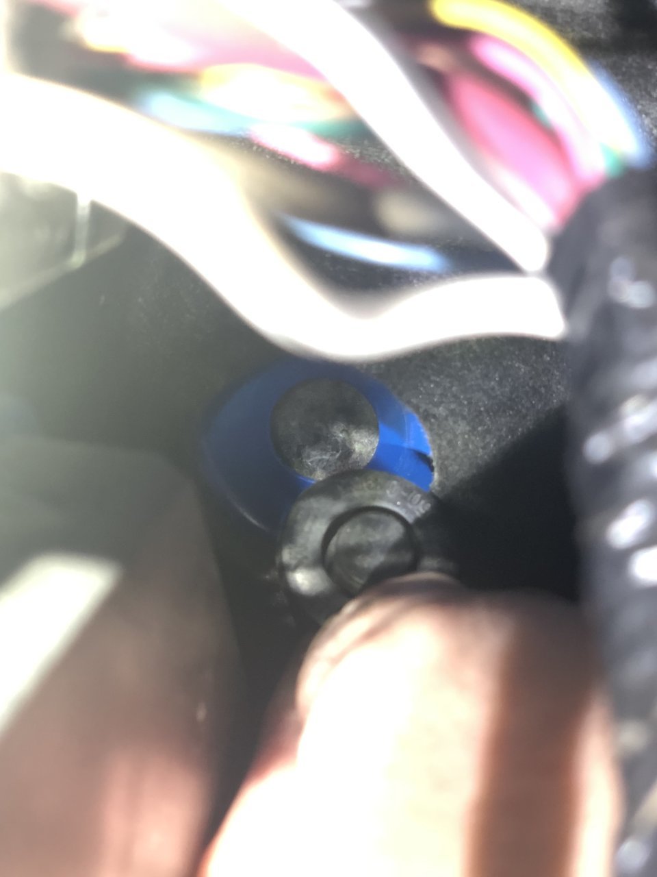

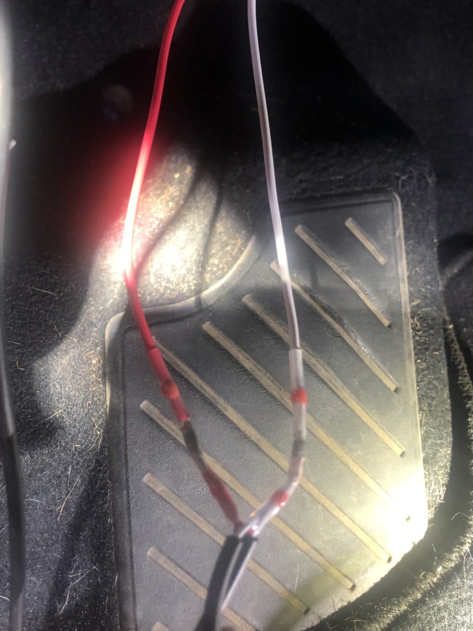

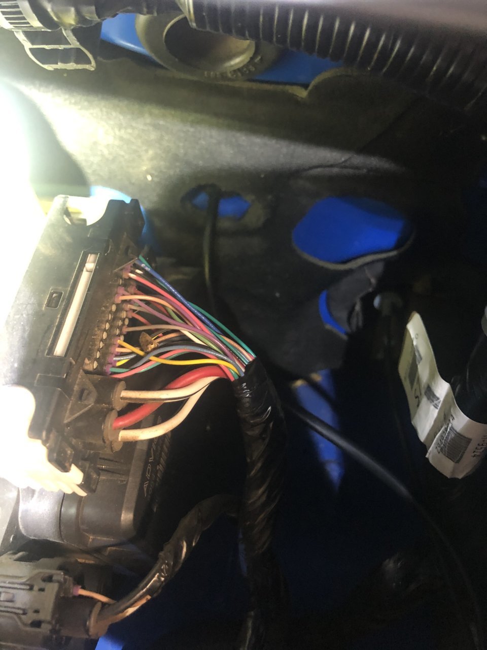

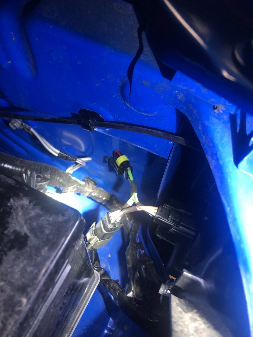

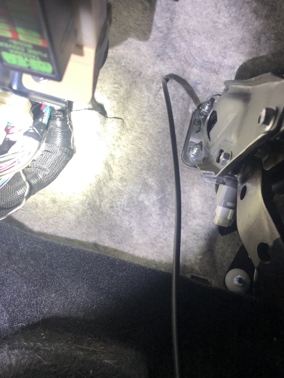

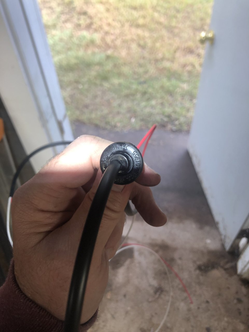

    Well just to update, I got mine fully functional with zero dead LEDs. I have the white/amber and I went with the reverse sequential on the signals to match my headlights. As previously motioned with @MESO not having a harness for the trucks with LEDs from the factory I purchased a t-tap from @daveeasa with a tap for V5's plus a future tap for if I want to add raptor lights to grill. Honestly the biggest pain in the of the entire install was going back through the door boots on each side...if you want these and puddle pods I suggest doing them at the same time to get it all done at once to avoid doing it twice like me.
    With the t-tap it was super easy, with OEM like quality. I don't know if this is true for all years, but on '20 w/ auto there is a plug to get through the firewall right near the master cylinder. I pulled it out and took it to the vise and drilled a hole with a 15/64th bit, which is just big enough that you can slide in the provided harness from Dave through with a little dish soap as lube. I did all that, went inside the cab and cut the wires to length and combined both driver and passenger mirror red's to the red from the engine bay and connected with butt connectors and did the same with white's. I then tucked everything back behind the driver kick panel so everything is hidden. I will say the wires provided by meso are pretty thin and the jacket around them is kind of a pain to strip, so it took me a bit of time to get these all even and ready for the butt connectors.
    Overall I would say this is a pretty involved install to get everything to function like OEM without tapping into factory wires. I chose this method just to make it reversible should I ever want to. Looks great, MESO did another amazing job with these. Dave is super awesome and has great communication.
