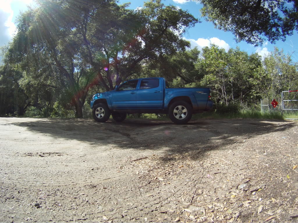

    Blue '06 Prerunner TRD Sport
    Debadged Tailgate, TOYOTA logo on Tailgate, Uniden Radio w/ 4' Ant., Removed Sway-Bar, Rear Icon Extended Travel Shocks, 8" King Offroad Shocks, Debadged Doors, 1.25" Rear AllPro Wheel Spacers, 315/70R17 Mickey Thompson Baja MTZs, AllPro Skid Plate, New Car Smell Air Freshener, OMD Ford&Chevy Leaf Pack with Original Main leaf, Engage LT UCAs and LCAs, Engage HD Tie Rod Ends, Kar-Tek Limit Straps, Camber Eliminator Kit, Removed Rear Flares, Blue LED Dome and Map lights, LED License plate lights, Black TRD Sport Rims, 20W PA Speaker, 2 Meter Radio, Demello-like Bed Bar, Harbor Freight Dust Lights, Blacked-out Hood Scoop, Custom Pre-Runner Bumper, JBA Long Tube Headers, MBRP Catback Exhaust, AFE Stage2 CAI, URD MAF Sensor Calibrator
    2006 2nd Gen TRD Sport w/ 3" DR COs and 1.5" AAL w/ Bilstein 5100s.
    Stock Wheels
    285/70/R17 Mickey Thompson Baja ATZ: 2.5-3" lift required
    Will rub significantly without trimming
    Trimming and Wheel Spacers Required with stock wheels.
    Cab mount chop required
    Tires will also hit fender flares and will break the clips when tires are stuffed into well
    Tires may also hit fenders when fully stuffed into well
