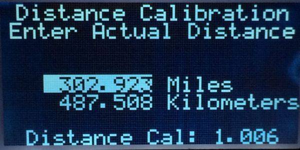

    Make sure you setup your distance calibration as well or your MPG reading will be off. Best way I found was to set a route, point A to B. Use your GPS or google map to find out the actual miles from A to B (further distance the better, don't go 1 or 2 miles). Reset your distance calibration then when you get to your point B, set the actual mileage on the Ultra Gauge. Do this a few times to fine tune the calibration.

    The same goes for the gallons used. Go to the same pump each time you fill up and calibrate it to when the pump clicks off. It took me about 6-8 fills before I was calibrated. Do yourself a favor and record the calibration #'s incase you unplug the ultra-gauge.. you'll lose those #'s and have to start over.

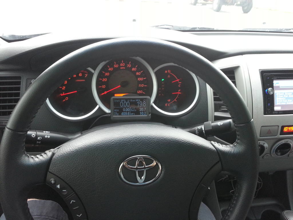

    Here is where mine is installed.
