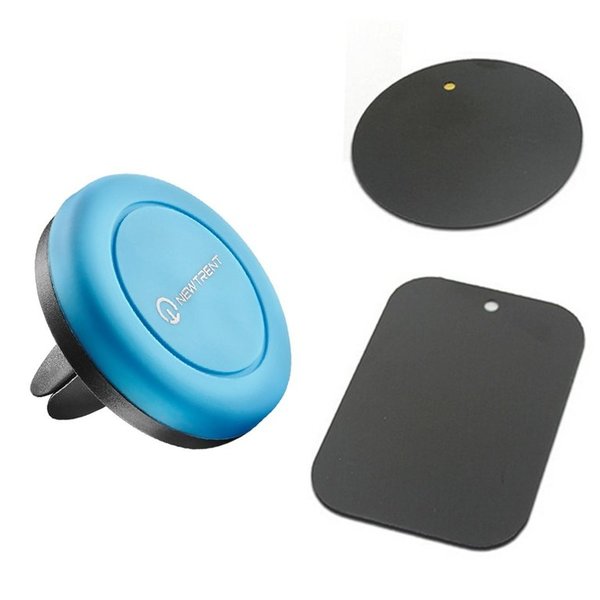

    Attached is a pic of the mount. The circular metal plate attaches to the back of the ultra gauge. I'll take some pic's of it on my console today. The cool thing about having it like this is that when you leave your car you can just pull off the gauge and drop it into the cubby so the criminals won't see it.

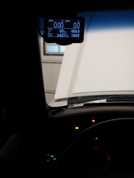

    I mounted mine in the upper left hand side of the windshield using the horizontal mount. Mind you it's my Ranger but I like it.

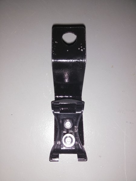

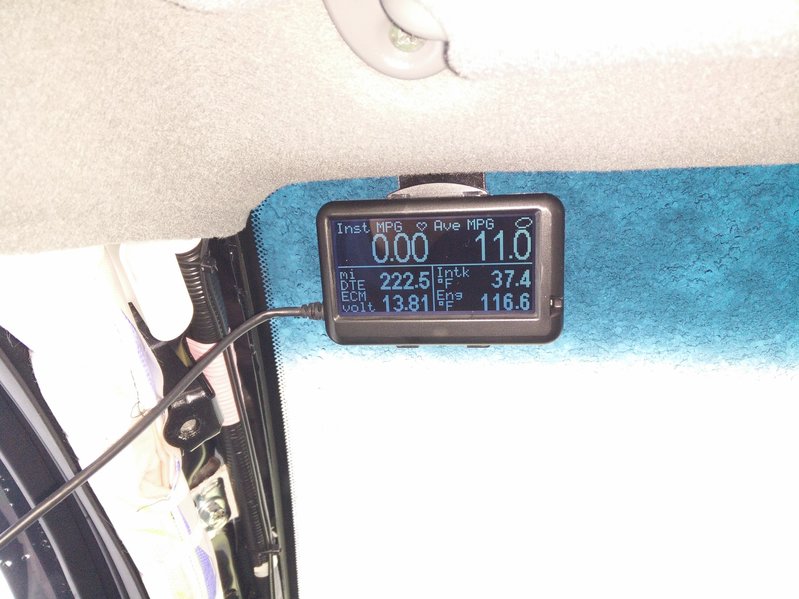

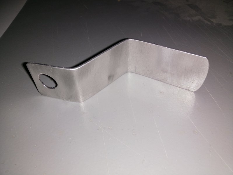

    I made a little bracket out of aluminum flat bar and used the sun visor mounting screw to attach it under the headliner. Solid as a rock, hid the wires thru the a-pillar, full use of visor, and hidden from view.
