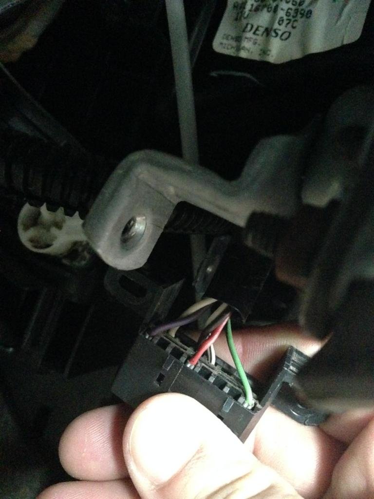

    Okay, so I know the 2001-2004 Tacoma's have some ABS issues with the UltraGauge and I know that their website has this fix for it:
    http://ultra-gauge.com/customer_support/knowledgebase.php?article=18
    My problem is that my #14 and #6 ports on my OBDII don't have any wire or pins going to the #14 and #6 ports.
    I have no idea what to do. I plugged my UG in and rode about a mile and had no ABS lights come on or anything, but the UG kept beeping with an error message or something. When I first plugged it in, it said there was a 9141 Protocol. I don't know if that's got anything to do with the ABS or what. PLEASE HELP!!!!
    Also, I found this thread, which tells how to fix the ABS issue, but my OBDII isn't wired the same way as the one in those pics.
    http://www.tacomaworld.com/forum/te...agauge-1st-gen-abs-issue-fix.html#post7909831
    PLEASE HELP!!!!

    Thanks. My problem is, my ABS doesn't seem to be affected by the UG...I've got no idea what's going on

    Seems like your wiring is different... might have something to do with being a prerunner but I dont know. I've been searching for a bit and can't find a reason for the 2 obd connectors being different.

    My wires are in the 1, 5, 8, 12, 13, and 15. UltraGauge doesn't have telephone support, so I sent an email and will hopefully get a response sometime by the end of the week. It's killing me to not be able to play with it!

    Where are the wires on the ultra guage side?
