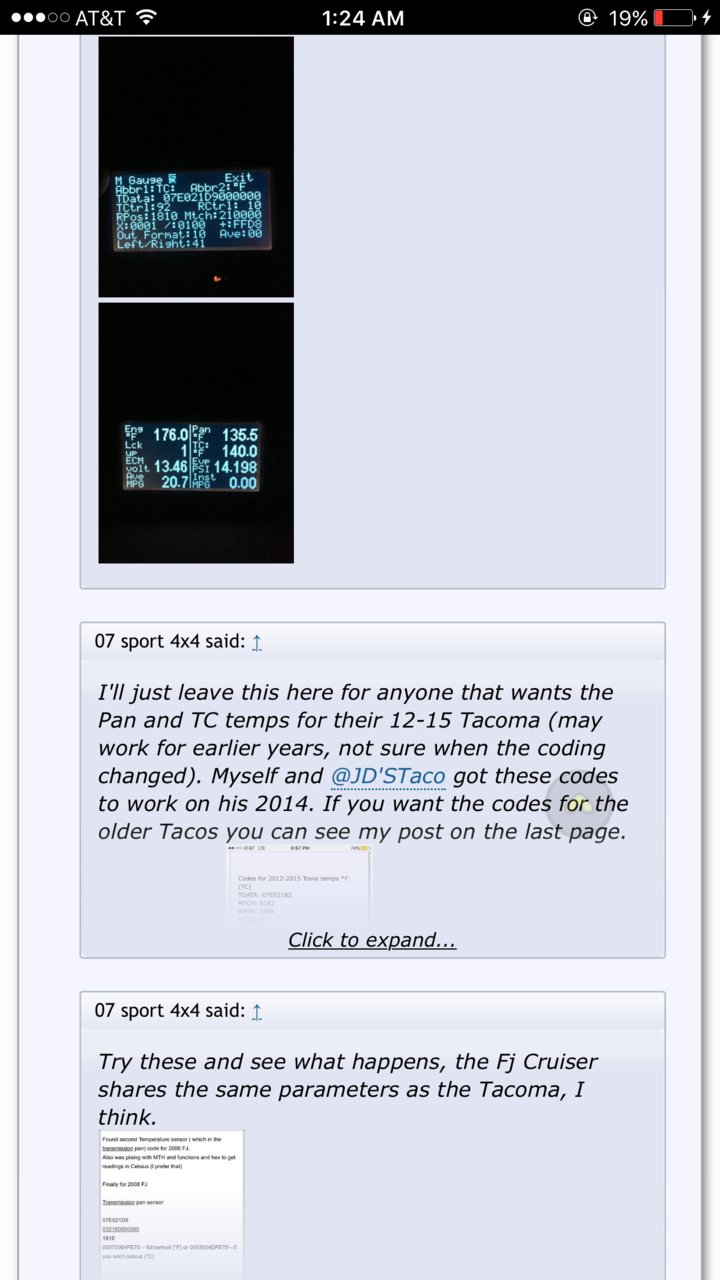

    anyone have the parameters to setup tc temp on my 06 Tacoma? I got the normal trn temp that came pre loaded in my ultra mx

    I'm pretty sure '06 Tacos don't have the ability to show TC temp. That came about in later years.

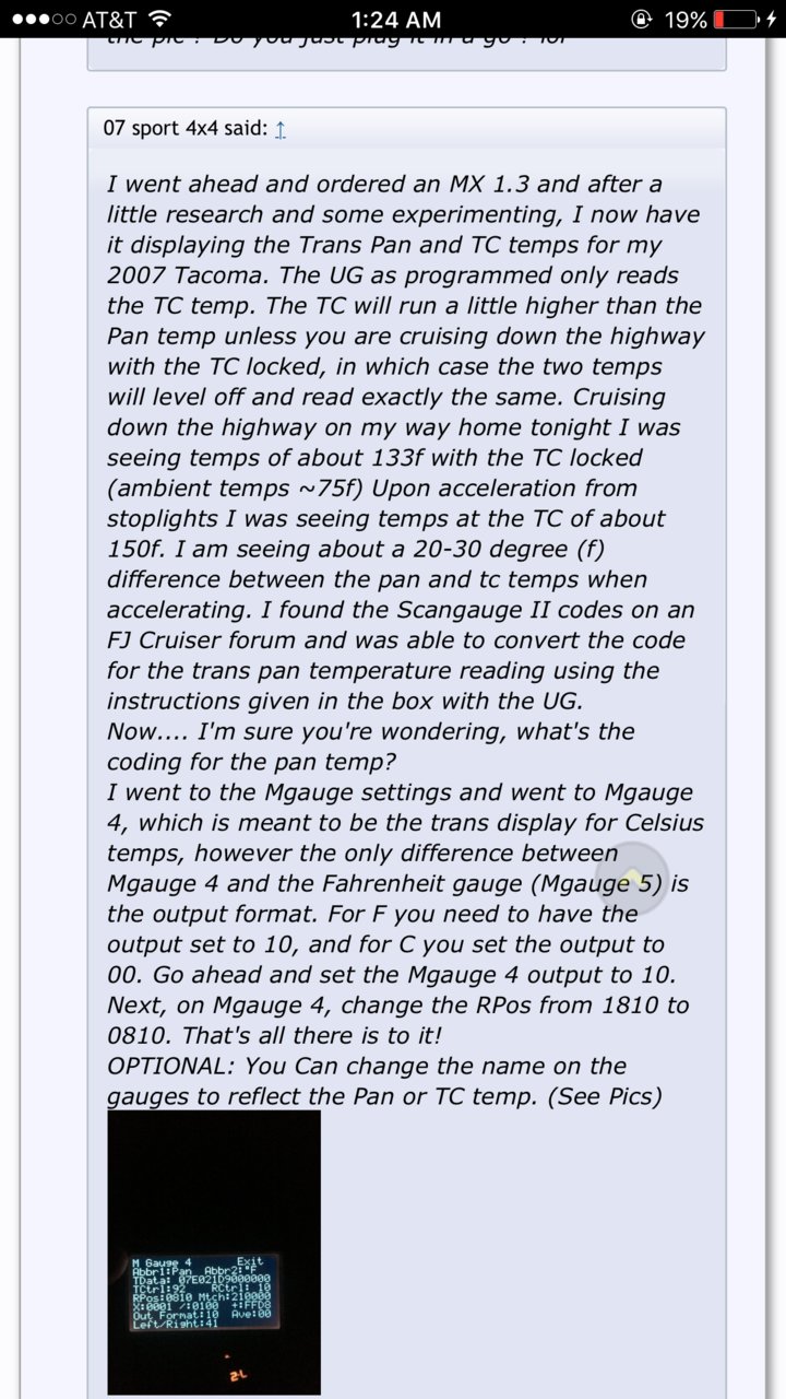

    My 07 has torque converter temp . I found this awhile ago and took some screen shots and it worked for me , all credits goto @07 sport 4x4 :cheers: I’m not sure where the actual post is sorry

    That worked....thank you
