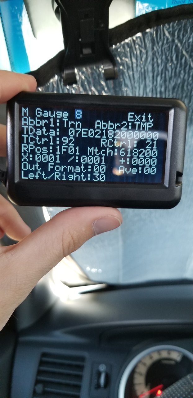

    The orginally code i get and error the newest code i get 1.0. Any advice guys?

    These should work for a 2016+, these are the scangauge codes. You can find the ultragauge codes using these, but I don't have a 3rd gen so I can't verify that they'll work or not for the ultragauge.

    just received a new mx1.3 that was 'pre-programmed for tacoma/tundra) but is displaying err for trans temp. Is this because the codes for my 2015 are different than the 2008+ they mention?
