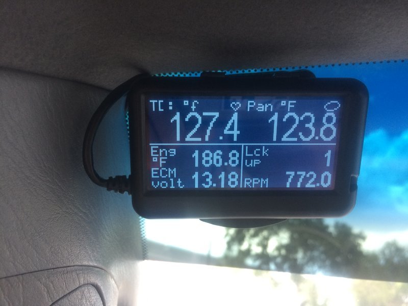

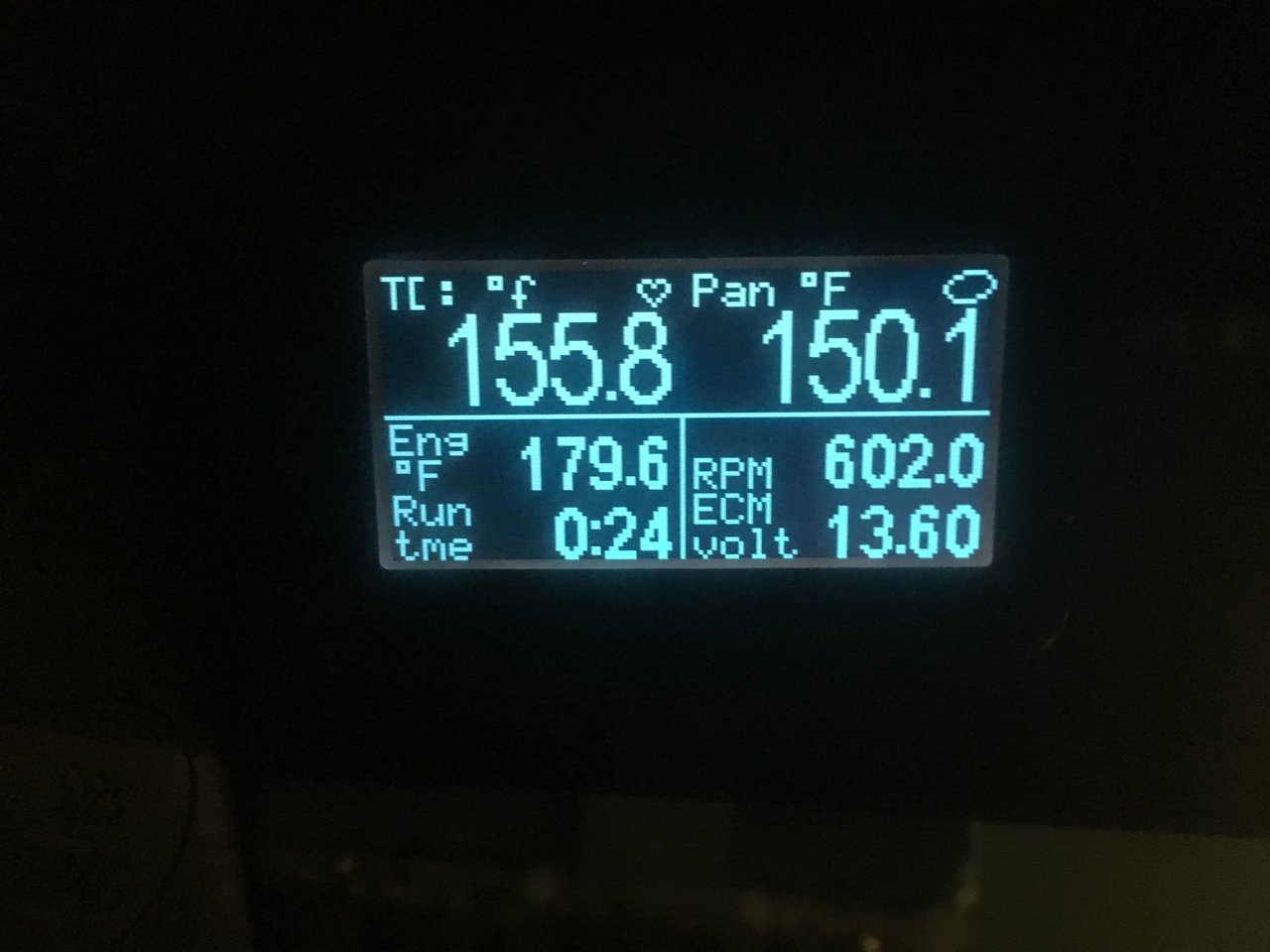

    The two I posted are for the Torque converter temp and the trans pan temp.
