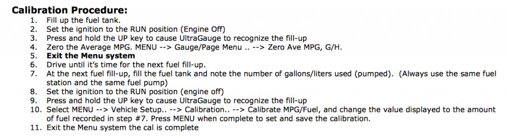

    Received my ultra gauge yesterday and i've been playing with it and I'm not sure if I like it. Filled up with gas this morning and put right around 10 gallons and it wouldn't let me put how much I put in it.Can someone help me change my mind

    Why would you want to do that?
    Re-read the calibration directions.

    Just recalibrate.
