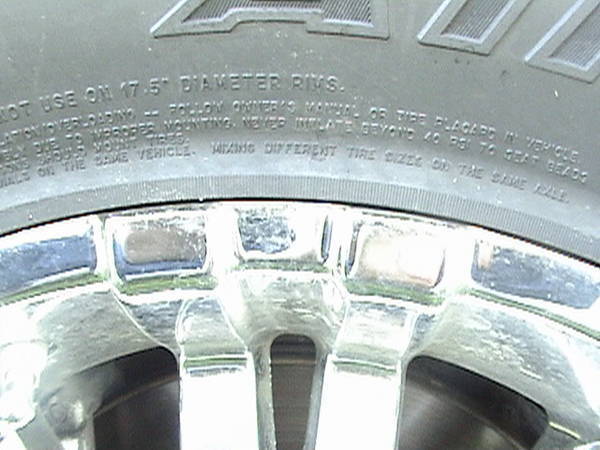

    After leaving there I went to 2 other shops and they said the same thing. Here are some pictures.
    They say they can't grab the rim well becasue of these here bumps (for lack of a better term).
    This one shows how the tires come out past the rim to protect it but at the same time make it difficult to grab the rim properly, which may result in scuffing them.

    Imrubicon. Thats what I was planning on doing but so far all the 4 wheel shops don't do alignments. Go figure, In my opinion I would want to be able to do alignments in my shop.

    as for the alignment, certain wheels have certain drawbacks with the targets, however, you can align your truck with stock wheels then put on customs. The tire height does not change the alignment. I have been doing alignments for 16 years and happen to have tire clinching heads for our new HUNTER machine. Find an alignment shop that knows what they are doing. There is a distinct difference between making adjustments and knowing what the adjustment will do. As for TC upper arms, that's the only way to build caster back into the front and at 70mph + you will see why you need more caster than what your left with after a control arm pump up type lift.

    My tires stick out from the rim just as bad as those do. Find a GOOD alighnment shop. Mine never has a problem aligning them.
