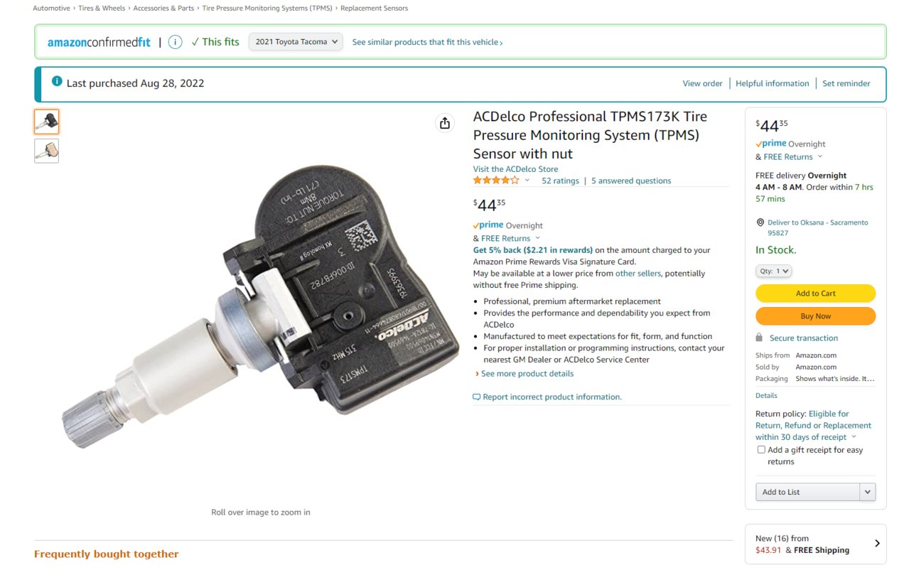

    Hi guys,
    Hope all is well. I purchased and replaced my wheels with these TPMS however in Techstream I am unable to register the ID's. These have 8 digit ID whereas the OEM TPMS has 7.
    I called all of my local tire shops and nobody can assist with reprogramming.
    Les Schwab, Firestone, Midas, Americas Tire Co all said we can't assist.
    Any thoughts?

    Just a thought... the sensor in the picture has an ID starting with a zero. If the ones you bought do also, have you tried to enter their ID to Techstream without the initial zero?

    Yes, it did not work. Tried multiple variations.
