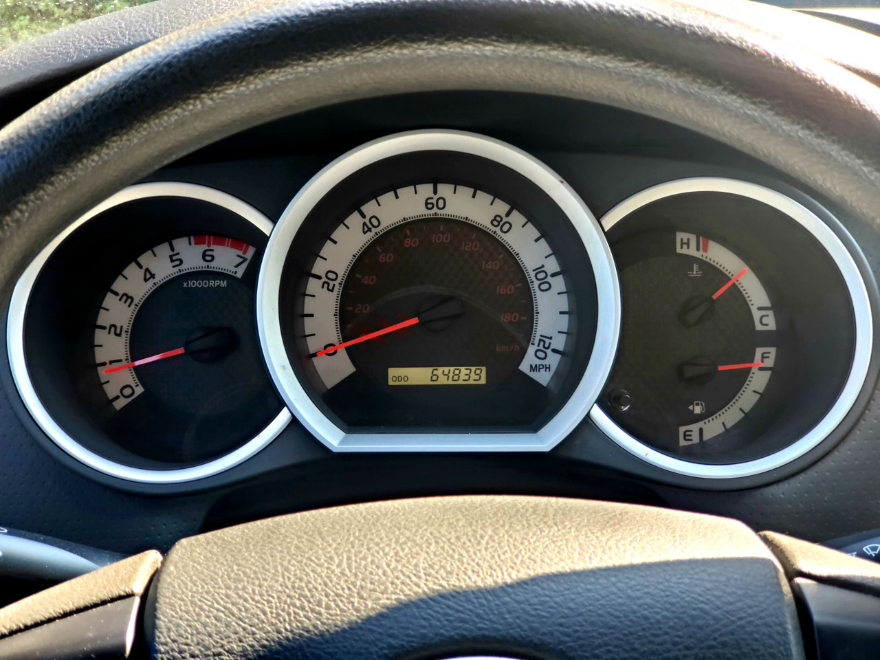

    All is right in Tacoland. The TPMS light is extinguished. Activated the TPMS sensors with the ATEQ VT36 and then programmed the ECU with the ATEQ Quickset. The light went off before I even moved the truck.
