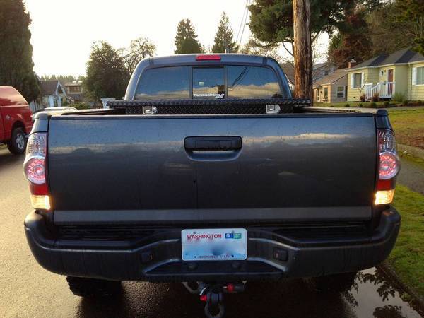

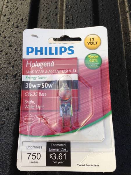

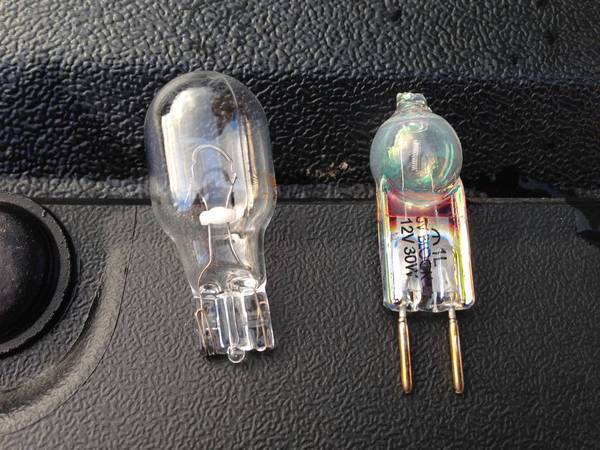

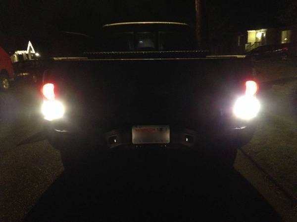

    Just installed 30W Halogen bulbs from Home Depot.
    I considered doing the 886 mod, but didn't want to melt down my housings like what happened to BensonX.
    This wouldn't normally be a problem if I just kept my truck on the street. Off-roading would keep the reverse lights on too long. This past summer I got into a trail where I couldn't turn around - had to back out 3/4 mile - my backup camera timed out twice. Every time I go out (every 3-4 weeks), I have to back out from dead ends 2-3 times. This is too much runtime for high wattage reverse bulbs.
    I considered going with a 894s, but then discovered that I could just go to the hardware store and get a 12v bulb that I don't have to modify. Just had to pinch the socket contacts closed to accept the smaller tabs on the new bulbs.
    GY36.35 Base 30W Halogen bulb.
    OEM 921 18W on Left. 30W on Right.
    Pinching the Contacts Closed.
    OEM Reverse Lights Shown.
    OEM 921 18W on Left. 30W Halogen on Right.
    New Halogens Installed. Much Brighter! :D

    Here's a night shot.

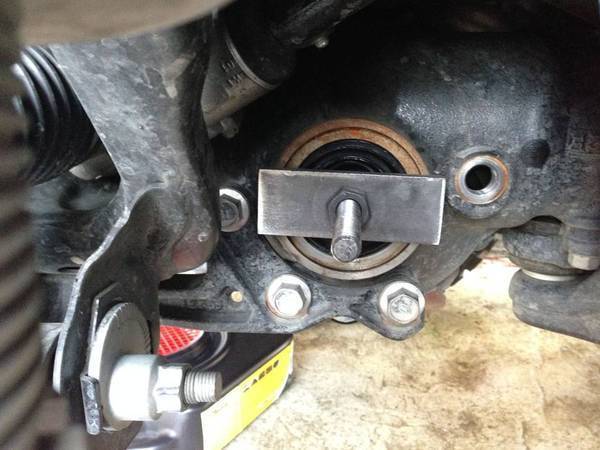

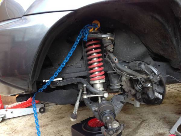

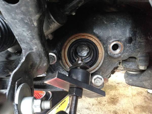

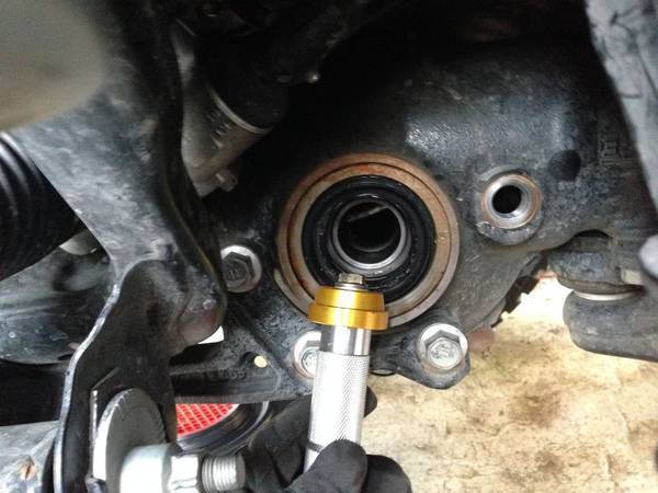

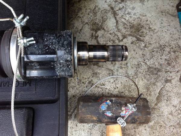

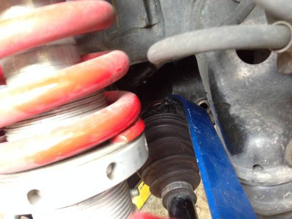

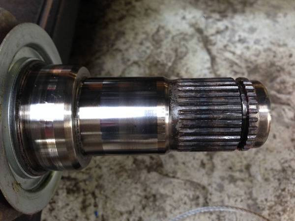

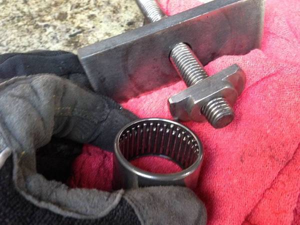

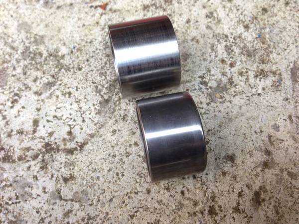

    My truck started having a pulsating vibration at 35-40 mph; at around 6,000 miles. I now have about 9,000 miles on it. So I purchased the bushing and related tools from East Coast Gear Supply.
    The install was super easy - took about 3 hours. I have never done anything like this before; it was a good experience. Thanks to my TW community, I was able to glean all of the info I needed to do the job!
    I used cable/short-handle-sledge/yank method for removing the CV shaft. It came out with about 6 hard yanks on the hammer. Removing the needle bearing and installing the bushing was a piece of cake. I did bevel the puller tool to make it easier to insert behind the bearing.
    Reinstalling the CV shaft initially seemed to be challenging; but it ended up being super easy.:D
    - Make sure that the opening on the C-clip is on the bottom. This insures that it is centered on the shaft.
    - Insert shaft and gently rotate to clock the splines correctly.
    - Gently push up on the drum to square it up and hold it in this position.
    - Use a pry bar and small sledge and tap it into place. Took me two mild taps and I heard the C-clip snap into place.

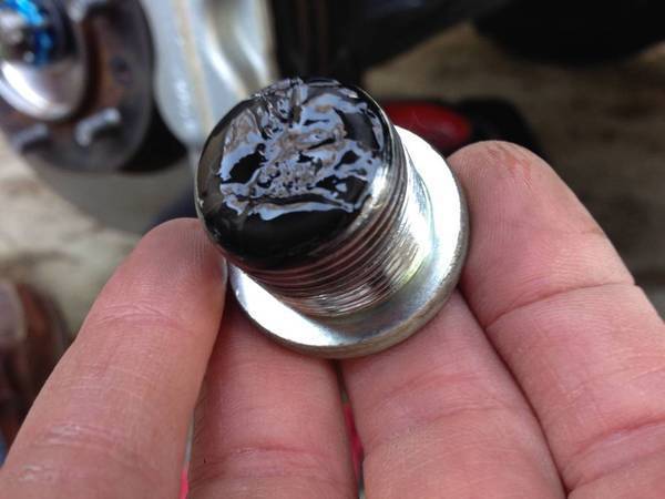

    The Diff drain plug had the expected sludge on it but no visible metal. Good news. I used a pump to fill the Diff with Lucas synthetic gear oil.
