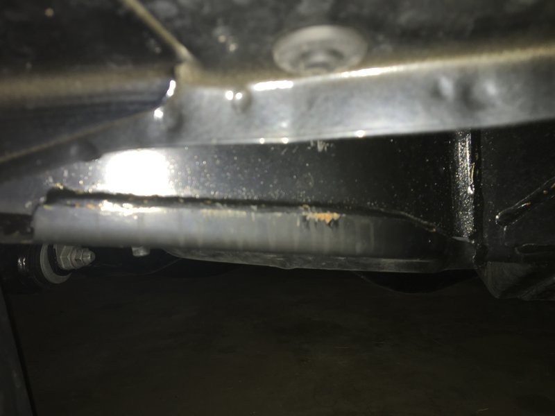

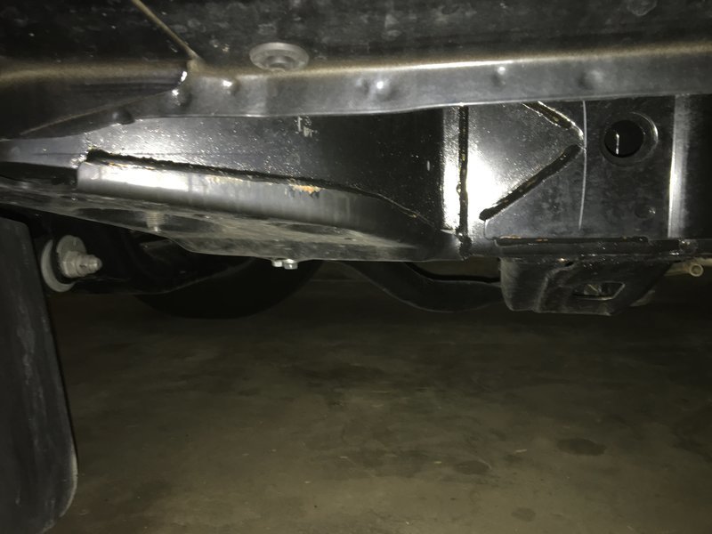

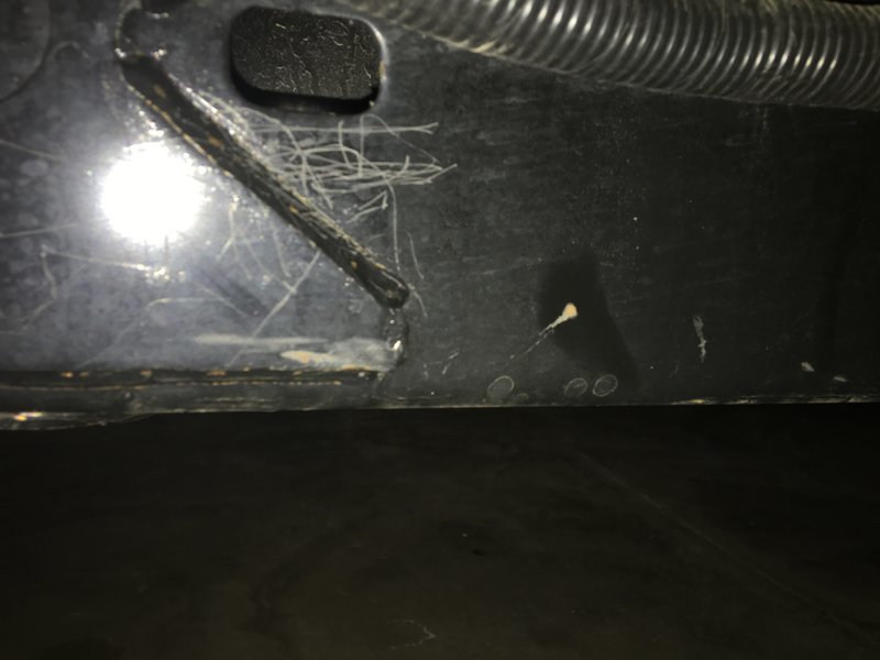

    First off, I have very few gripes about my TRD Sport 4x4. Overall, she has been great for my needs... camping, rafting, hauling landscaping materials and general commuting. I have 4,500 miles on the odometer and will be taking her in for my 5k service soon. However, I want some opinions before I do so I am more prepared for my discussion with the service tech.
    I have noticed some rust on both sides of the under body below the passengers door and drivers door. Looks like the black coating they put on didn't entirely cover all the under body and has allowed the metal to be exposed to moisture and magnesium chloride (during winter months). Currently, it seems to just be on the surface and on welds. I am not deeply knowledgeable about cars, though owning this truck has increased my desire to learn much more.
    So, is this rust acceptable?
    What questions or expectations should I have for the service department?
    Anyone else experiencing this on your truck?
    Thanks

    I would take more pictures of all the affected areas and start a claim with Toyota corporate. At least you will have documentation and a "paper trail" beginning at 4500 miles. Make sure you have your tech document it.
    Toyota of course will claim its normal, but when it gets worse, at least you have it documented.

    That's normal. My CA truck looks exactly the same. I'm not concerned.

    I'm at 5000 miles and the bolts by the control arms look like they have 20 years on them already. When I would work on my 15 year old ford (always a CA truck as well) there was hardly ever any rust.
    I think it is just a Toyota thing....I'm not too concerned, but then again I live in CA.

    I'm telling ya. Dealer isn't going to care about the tiny bit of surface rust. Just take care of it yourself annually and your frame won't end up like swiss cheese. At this point, my truck has more rattle can than factory powder coat.

    You just spray it over what is already there? Or do you buff then spray?
  20. Jun 30, 2016 at 3:01 PM
    #20
    jberry813
    Jan 21, 2011
    #49636
    26,277
    Jason
    Lake Tahoe
    2012 DCSB Sport
    ...too much shit to list.
    Just spray over.
