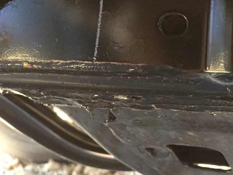

    Here's a 2015 truck with 4K on it.

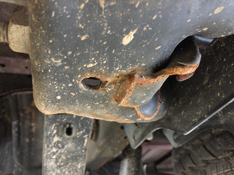

    Mine has the same and I looked at anew one off the lot it has the same "rusting" area. If you look close its only on the welds and it appears to be a gold color underneath the surface rust which is probably the weld material. Take a wire brush, brush the surface rust and spray it. This isn't the only new vehicle that has this look around.
