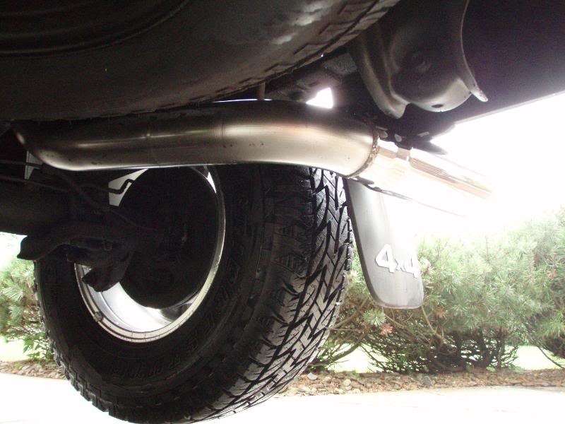

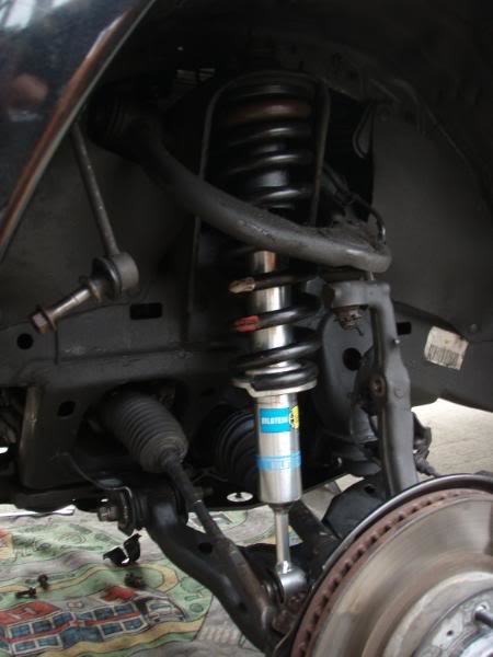

    I just cover everything in grease, and then i put used oil in my automotive spray gun and spray in ever drail hole and up and around the bed area and tail gate and in the drain holes on the bottom of the doors. Also take all the rubber gromets out of the rockers and spray them. Here are some pics of my toyota after 3 winters. very saly buffalo winters.
    Too bad there is nothing to coat the exhaust with.
