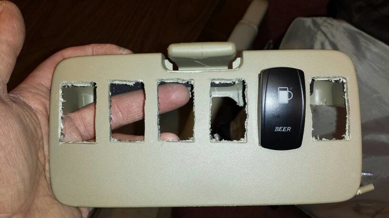

    I am working on the overhead sunglasses holder switch panel. I am going to use all lifetime LEDs switches. I have them laid out and cut now just waiting for the balance of the switches to arrive. I'm going to pull one 6 conductor line for the outputs and then a battery/ign and ground. Pics to follow in New thread

    I will have the switches tomorrow. Everything should be nice and straight. If it doesnt work I will grab a back plate. I think the end result will look more factory. Will keep posted

    Here is the finished panel

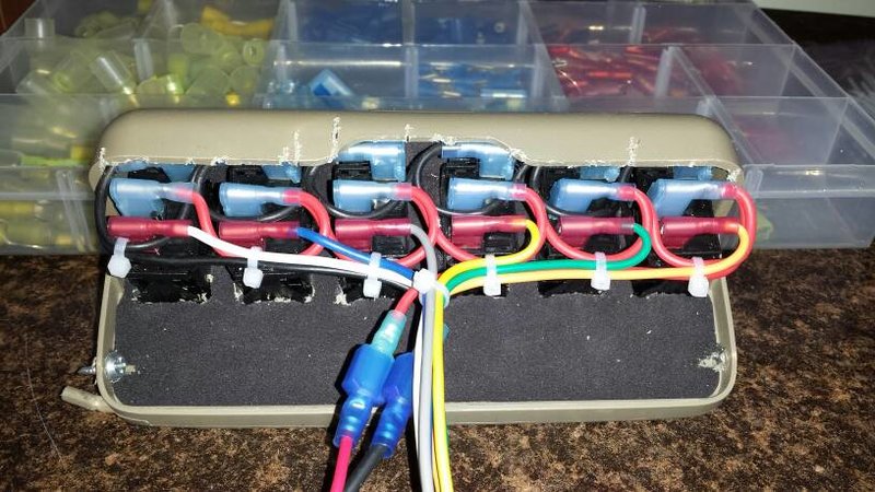

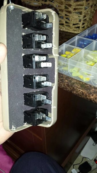

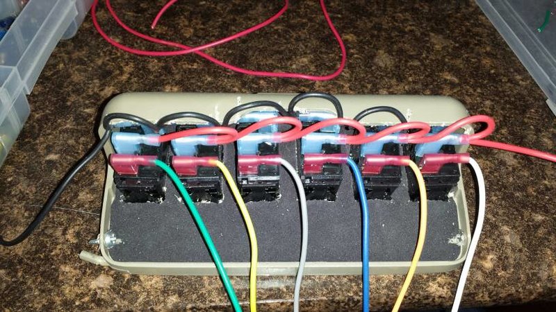

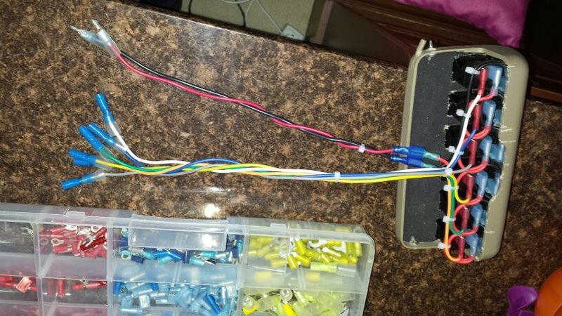

    So I had some down time.
    First has switch only
    Second is loose wiring
    Third is snugged and tied wires
    Last is with whips and ends

    Then once I get it in and wired I will get pics open and routed.
