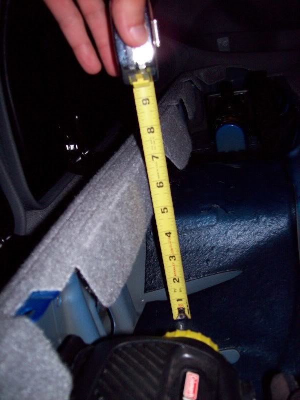

    what is the max diameter and speaker depth for the underseat enclosure? I'm a bit commited in the behind the seat deal, I am just curious for this situation.

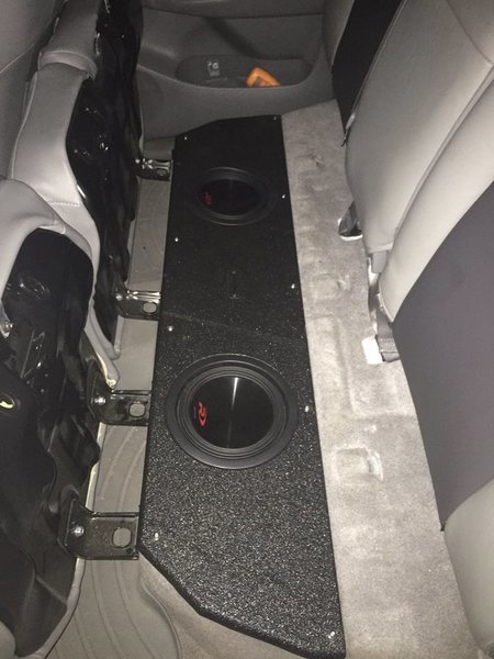

    Starting the cutting progress today. I should have the panel in today. Then I will work on sealing and sound deading the box.

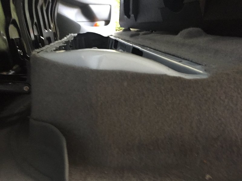

    The biggest you can fit down there (without DRASTICALLY changing things) is an 8" speaker. Anything bigger requires a wider mounting surface than is available due to the width of the bin. I believe that 5" is about the max (due to the sloping geometry) but I think @Pcyc can likely give you a more concrete measurement since he'll have his baffle on soon and could give you a proper depth measurement.
    Here is what the bin looks like before modification.

    Fin!
    Now to tune the bit ten d....

    OMG YES YES YES!!!! We have added another to our ranks! You got yours done in record time too! Everything come out ok? How's it sound so far?
