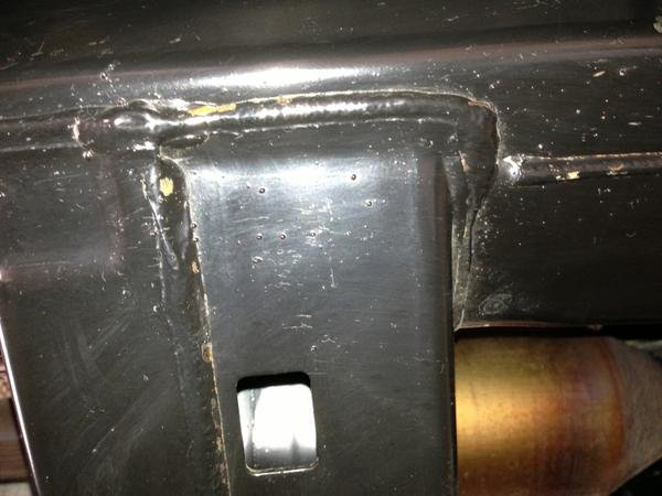

    Toyota's frame coating sucks, and most of the welds will have spots of exposed metal. My 2013 has surface rust on every single frame weld. Luckily I don't live in a corrosive environment, but everyone with a Toyota BOF, that doesn't want their frame rusting out, should go over all of their frame welds with something like POR-15 or Rust Bullet.
    My 2013's Frame frame at 2000 miles..
    whiplash+willy-albums-my+2013+4runner+sr_b3755ec601f04e84c96b5cbc83566ac2cae72f74.jpg
    After that, maintenance with Fluid Film and regular washes should help.

    This is my worry, keeping moisture and salt in making the frame rot from under the "coating" and into the metal.
    Maybe I should just por15 it while it's brand new lol
