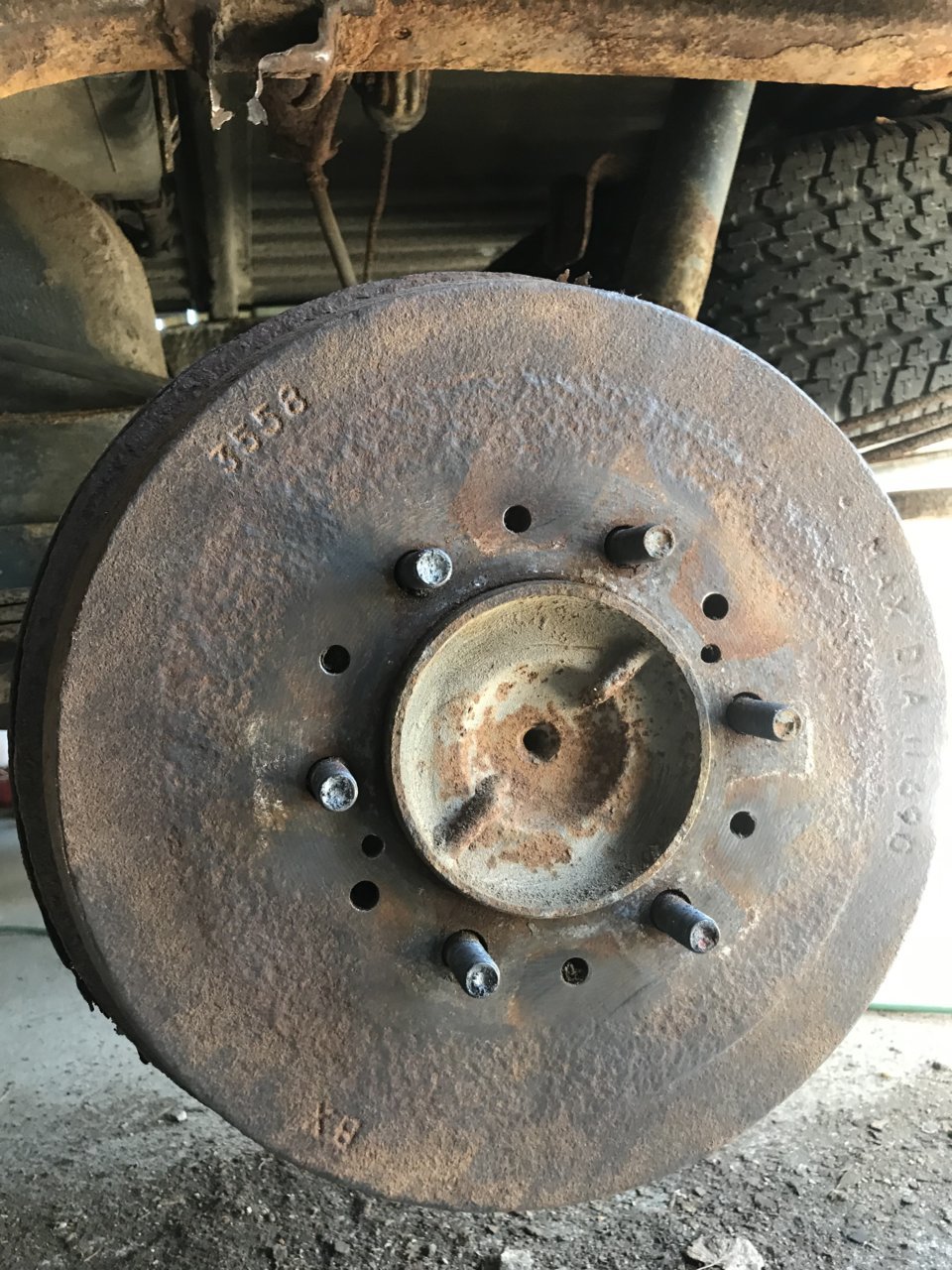

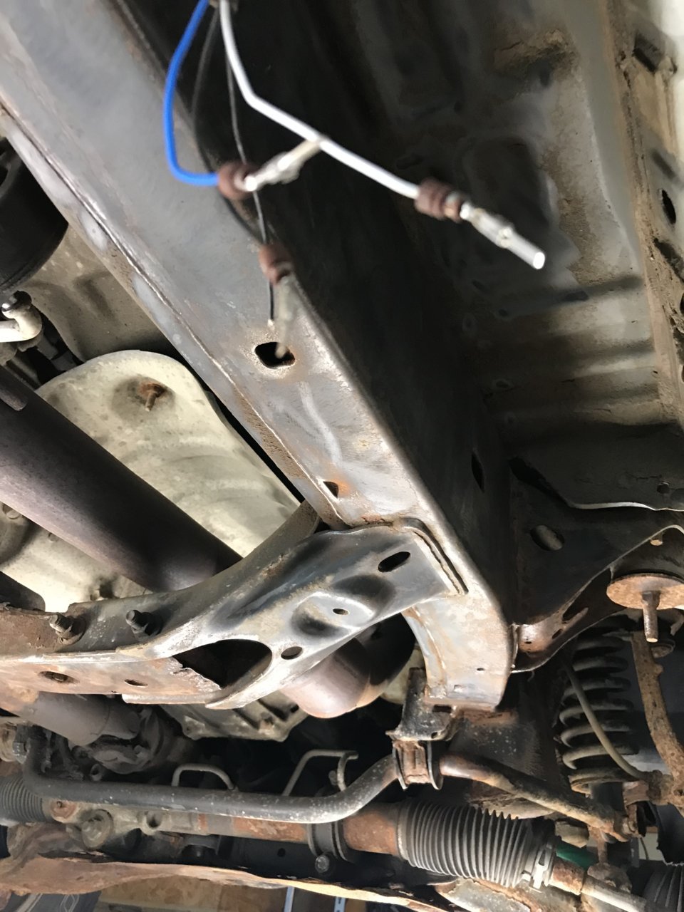

    Grind off all the rust.
    ACB6F776-4F0A-4A47-BBB5-1E2B753B15FA.jpg BFD4EBE7-6739-480D-BED6-AA1BAF1112BE.jpg
    Need to go over with wire brush and hose off today before shooting first coat of primer.

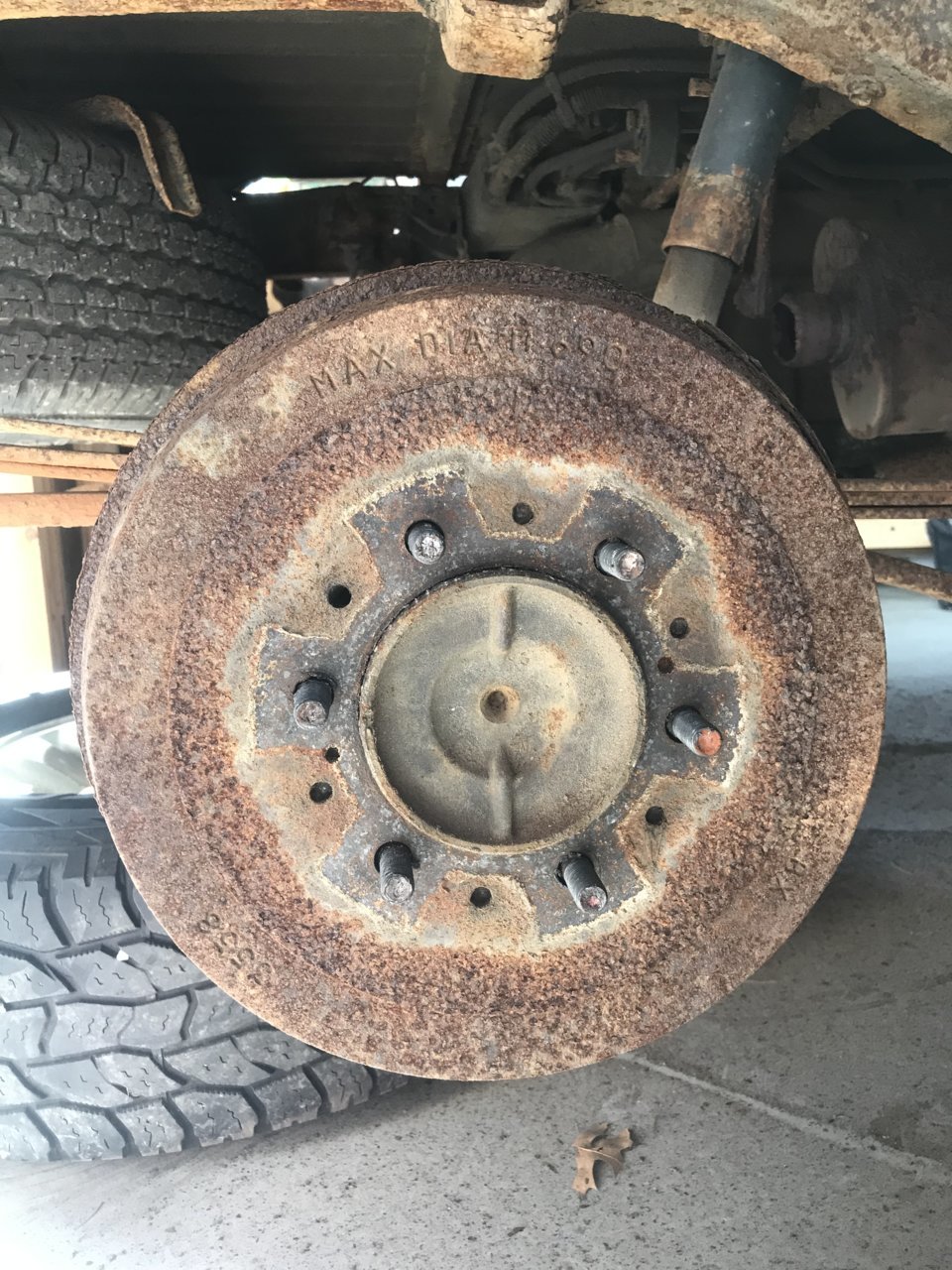

    are the inside of those drums in good condition, lots of lining left?, or are they needing replaced?

    They aren’t too bad but will be replacing them at some point in the near future. Il post a pic Tuesday when I get back to work on it.

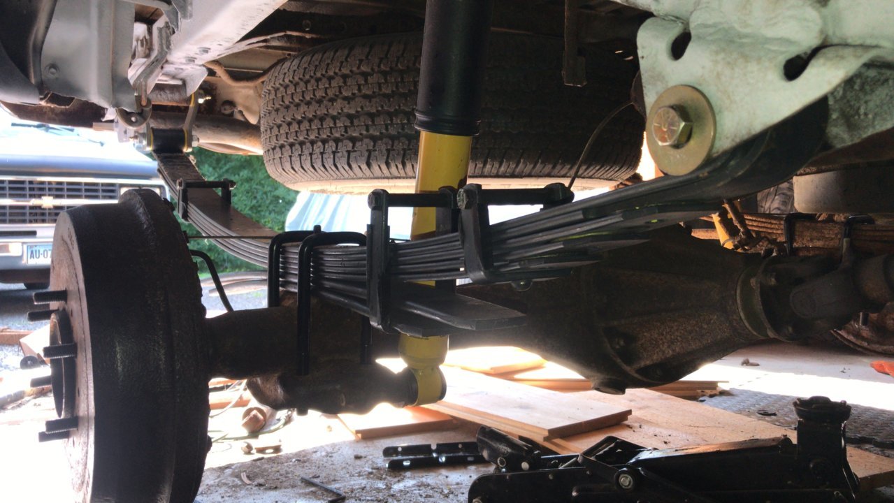

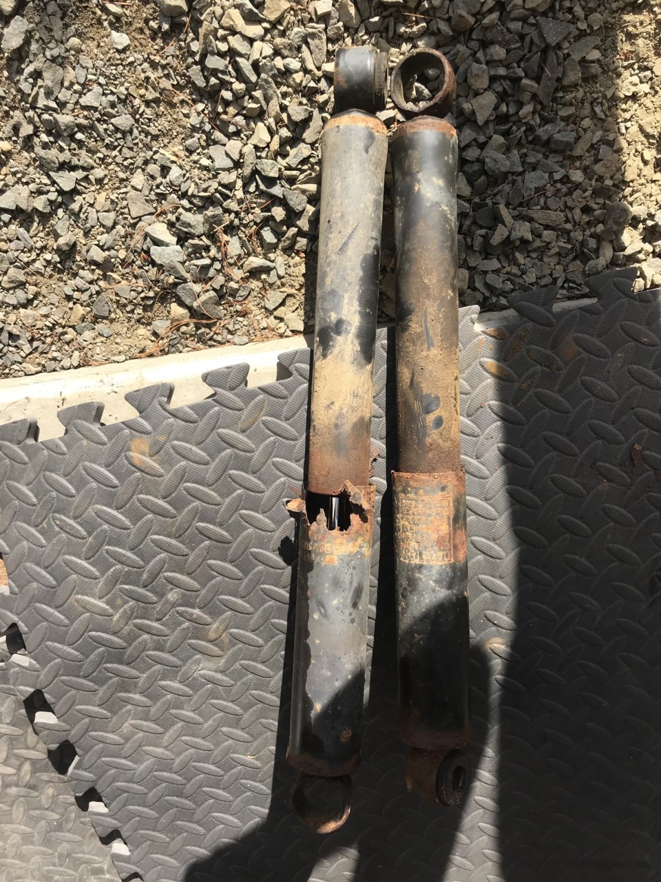

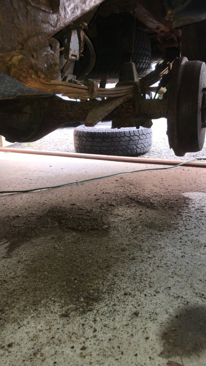

    One side done. Had to cut U bolts and chassis bolts. Relatively straight forward to install. Would be far easier with two people as the leaf spring weighs about 60lbs and is awkward to hold in place. My biggest error was that I got too eager with my angle grinder and cut the U bolts on both sides which left the axle with no support. Once I sorted that out I was able to get the center pin flush on the axle mount. Highly recommend using new hardware all around.

    those look to be the original shocks? and if so how many miles on them?
    i probably should order some new Ubolts (mine were probably that black at one time :cool:) and not worry about cleaning them up so can just cut em off at some point

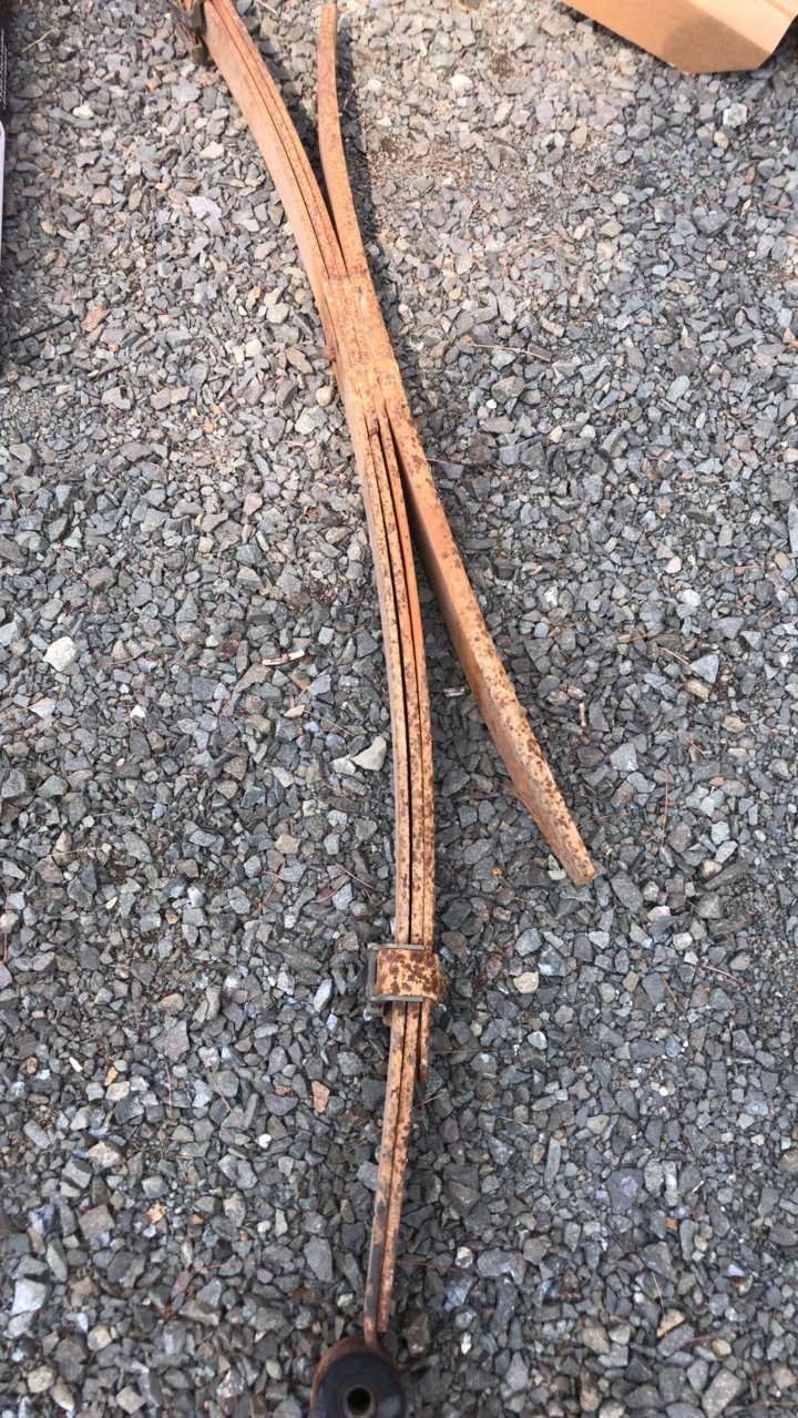

    The shocks were original with 180k... totally shot. They were beaten up more than they should have since the leaf springs served absolutely zero purpose.
    I highly suggest new U bolts and replacing just the shocks if leafs are ok still.

    I’m a bit suspect of the front leaf bolt I used. It’s a Grade 8 1/2-13. there’s a bit of space in between. I couldn’t find accurate detail on OEM bolt and I cut mine to pieces. I need to get an exact size and swap it.

    Thanks! I’d like to keep her alive as long as I can! I used a wire wheel on grinder for all the big surface areas and a wire brush for everywhere else I couldn’t reach with the wheel. Did the best I could inside the frame and used compressed air to blow out any particles. Then hosed her down with soap and water. Looking forward to seeing how the undercoat turns out!

    Nice - ever use Fluid film? It stinks but you can get an attachment hose for it so you can spray the inside of the frame. I do it almost every year for the piece of mind. I can't see in the inside of my frame and I take care of it. Looks similar to yours.
